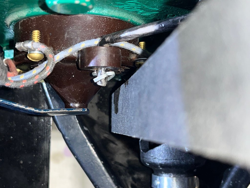

I used a string to measure the distance around the fan hub (ball bearing hub) and crankshaft pulley (original pulley). It measured 32 inches, so I ordered the "32 inch endless belt,1926-27" show in the supplier's catalog. I could not get it on, so I ordered the 33 1/8" belt. It touches the New Day Timer, so it is too long.
How do I solve this problem?

Turn the fan hub away from the timer instead of toward the timer to tighten.

Rotate the top pulley on the adjustment hub till the pulley is at the lowest point. If the belt won't go on, your belt is too short. If it goes on, rotate the hub counter clockwise as viewed from the back looking from the cab toward the radiator. To do this pull the square protrusion downward. This will raise the hub in the direction away from the timer. The timer rod should go through from the block side of the timer and the cotter pin cut short enough so it will bend close to the rod and not get caught in the belt. Tighten nut at back of adjuster to keep the adjustment. The fan should be tight enough so that if you rest your hand on the blade, the blade will not turn but if you push the fan it will turn.

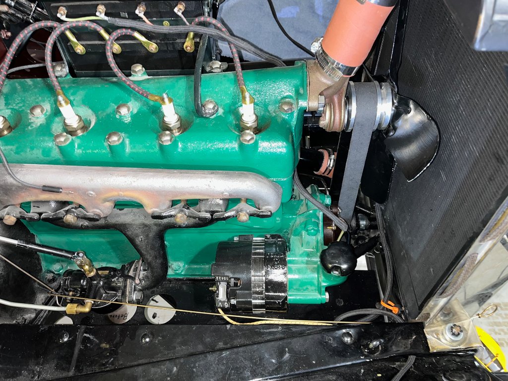

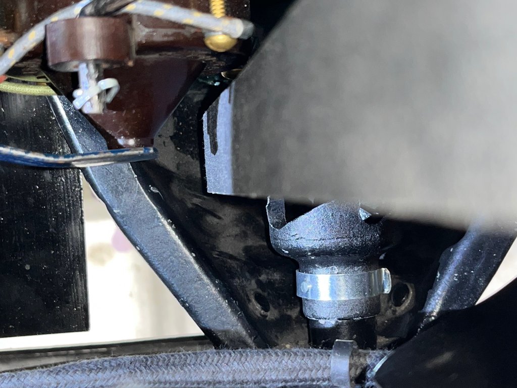

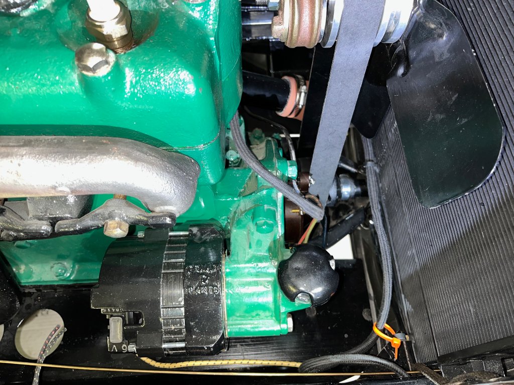

Norm, Thanks for the suggestion. I did what you suggested. However, I had to rotate the hub "clockwise", looking from the cab toward the radiator, not "counterclockwise". It solved my problem as shown in the attached photos.
The last two photos show the commutator rod in the two extreme positions.
