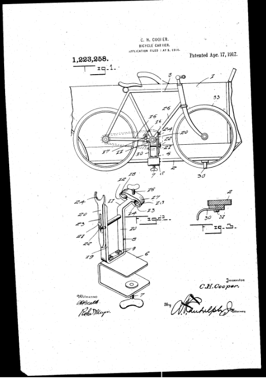

Found on the web

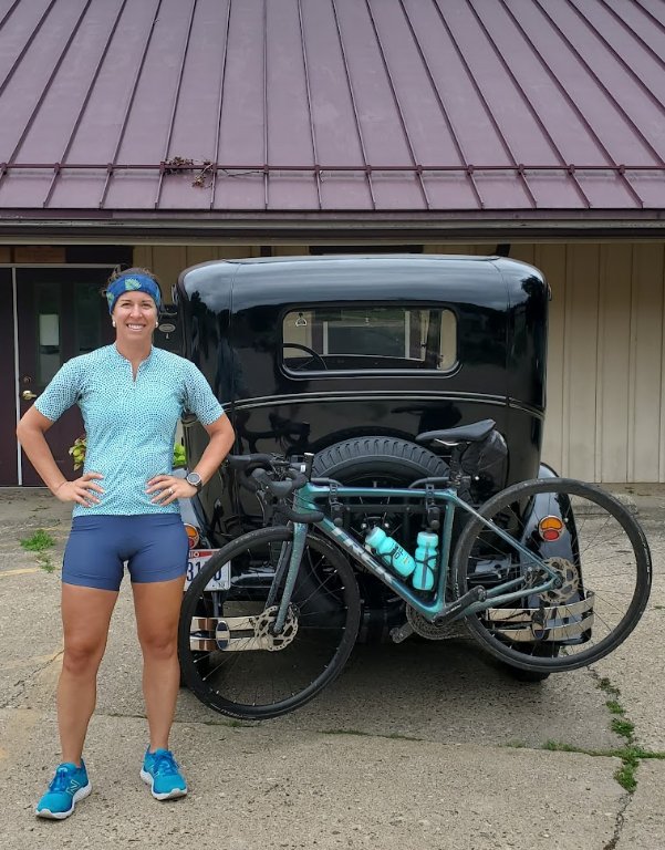

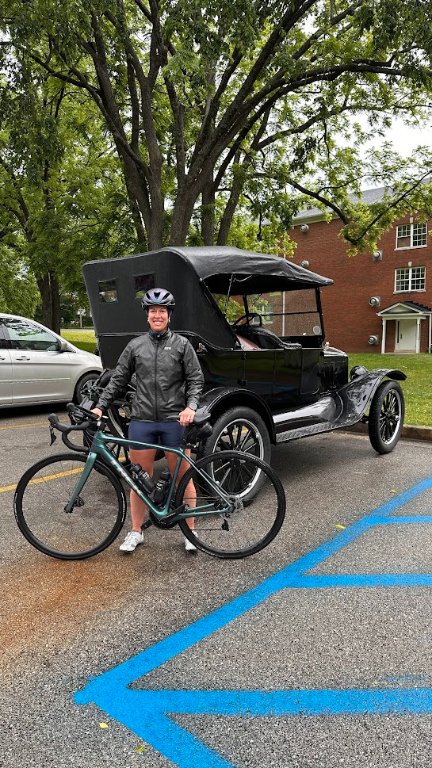

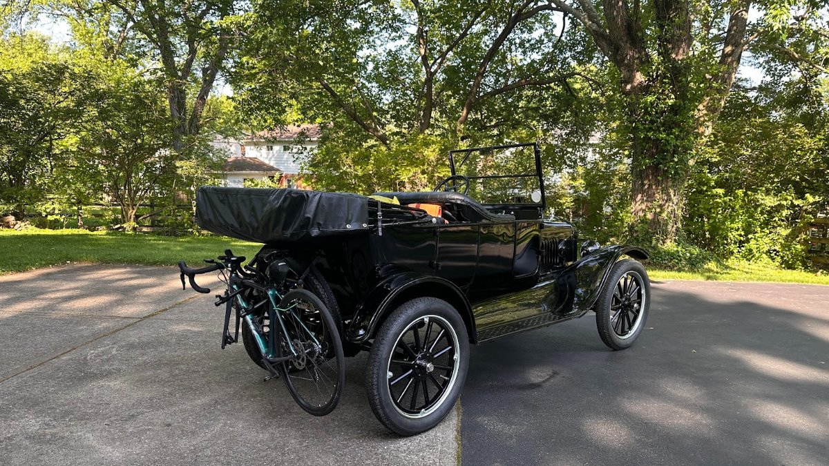

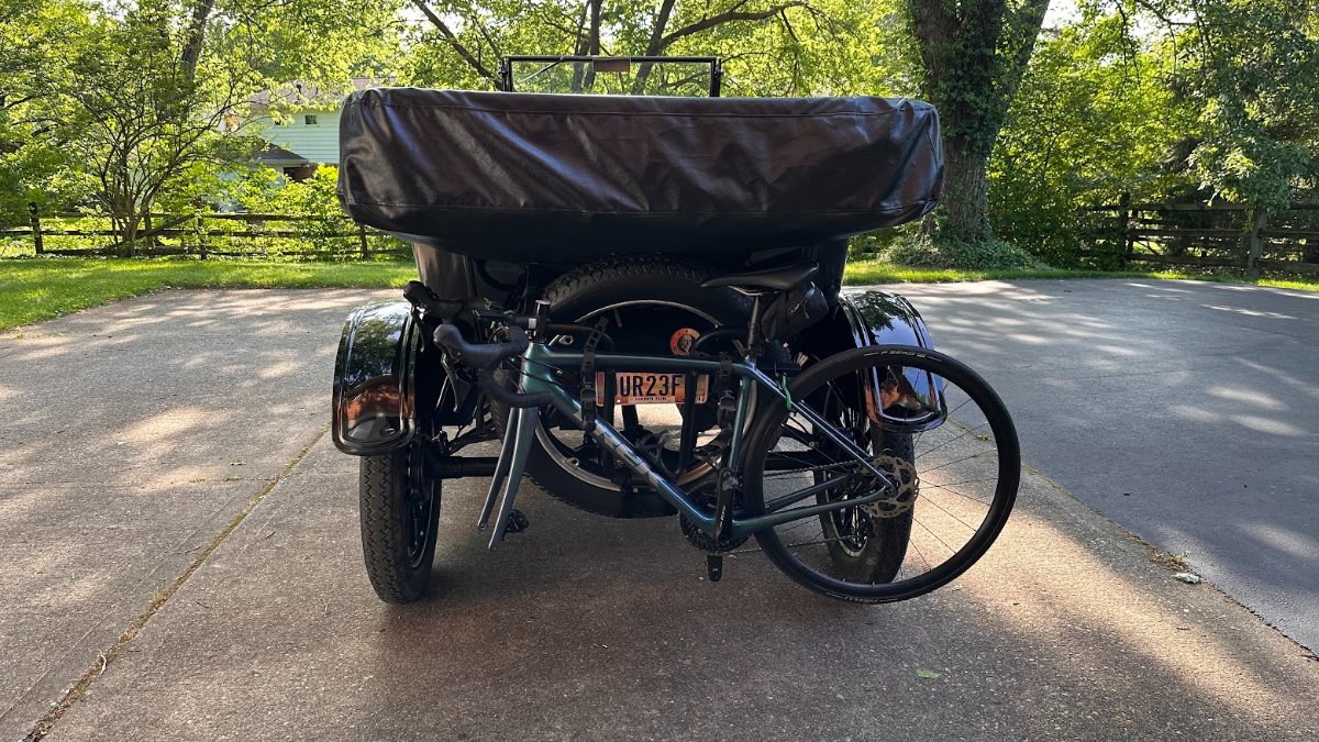

Dave,
I bought this rack last year and it works perfectly for both my Model A and Model T: https://www.amazon.com/Hollywood-Racks- ... th=1&psc=1
I bought two shorter bolts ($4 from the hardware store) than what came with the rack, that allowed the rear support bar to suck in closer to the spare tire. The whole thing goes on in 5 minutes and comes off in about a minute. And we lock her bike through the rack and to the spare tire on both cars, which gives us piece of mind when we stop to eat.
My wife just rode 160 miles over the weekend and I was the SAG in our 1923 Model T, I ended up driving a little over 490 miles in the Model T!
Let me know if you have any questions or want some more pictures.
~Jarrod
