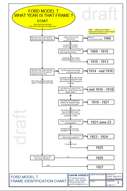

Does anyone know of a chart showing the differences between frames from 09 through 27? Showing number of holes and location both square and round for each year. The chart I am thinking of showed what year/years each hole configuration was used.
Thank you

Re: Looking for frame information
Several results
These links about Model T frame
https://www.mtfca.com/discus/messages/7 ... 1494003548
By Mark Barlow on Friday, May 05, 2017 - 12:19 pm:
I was looking at Mark Herdmans frame drawings when I realized that the square holes identify the frame years. Hope this helps
1909 to 1913 short rear cross member
Mid 1913 to early 1915 no square holes
Early 1915 to 1916 two square holes top of each rail
1917 to mid 1919 5 square holes top of each rail
Mid 1919 to late 1919 5 square holes on drivers side four on the passenger side
Late 1919 to mid 1920 5 square holes on each side
Mid 1920 to early 1923 four square holes each side
Early 1923 to late 1925 3 square holes each side
Early 1926 to end of production long rear cross member three square hole each side
Chart PDF
Thank you, that is what I was looking for.
