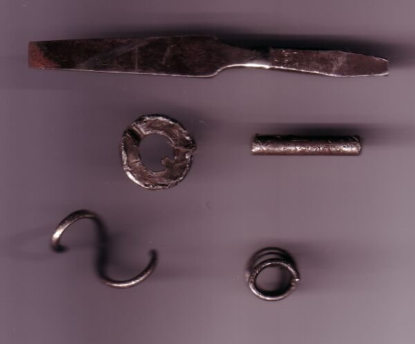

All these objects were retrieved from my transmission without having to pull anything apart. It had been driven for years with them in there. I supposed it helped that the magnets were weak.

JohnH
What is the long object that you got out of your transmission? Looks like a screwdriver or some sort of scraper? You’re lucky it didn’t get caught on the flywheel somehow!

John H., That's Grandma's old butter knife

Looks like a screwdriver designed to fit in an old bit brace.

It's a screwdriver bit for a brace. It was sitting in the channel that runs down the bottom of the bellhousing. I noticed it one day when I was changing the oil, and the end of it was in the drain plug hole. And yes, at some time it did get caught on the flywheel because some of the field coils had been gouged and one of the magnets forced over to the side. Not only that, the bottom of the bellhousing has a small dent which had been cracked and soldered up. So someone knew that something had happened. Amazing that it had been driven around for so long like this.John kuehn wrote: ↑Wed May 31, 2023 9:04 amJohnH
