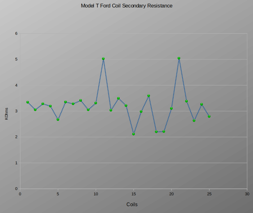

The results are shown below. I have not attempted any sort of analysis, the data is simply presented here as a record in case it's of use to someone.
Also included is a scatter plot which gives a visual idea of the resistance spread across the set. And before anyone complains, the dotted lines have been drawn simply for visual purposes, there is no particular relationship between the points.
Resistance was measured using a Meterman 5XP that had been previously checked against a series of 1% resistors within a few k of the requisite range.

That is quite a range of resistance values. Possible explanations for the variation in secondary resistance values is use of different diameter wire (resistance increases as wire diameter decreases), different number of turns of wire or both. This presumes all coil secondary windings are wound using the same wire material (copper) with negligible differences of impurities. Measurement of the secondary inductance would provide more detail as to the number of turns of wire used on each coil. The number of turns of wire is important because the turns ratio primary winding to secondary winding determines the voltage step up ratio for a given number of primary turns. The higher the turns ratio, the higher the secondary voltage gets for the same primary voltage.

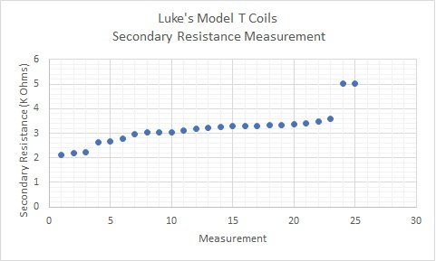

The random order of coil measurements is good because it shows the possible ranges one can expect from selecting 4 random coils from the box for use in a car. Here is Luke's coil secondary resistance data sorted by value; low to high to better visualize the range of values. Three distinct groups of coil resistance is more evident with the center group that conforms to a nominal range (3.11 K Ohms +/- 15.4%)

Thanks for ordering the data in your plot, it nicely shows the possible three 'classes' of sec coil resistance.
