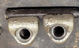

Are these Firestone clamps correct for a TT?

Post by RajoRacer » Thu Jun 01, 2023 10:28 am
Possibly - they appear similar - I've got Ford script clamps.

Re: TT Rim Clamp Question
Post by George House » Thu Jun 01, 2023 1:30 pm
Yes they are….On the 20” rim that requires a lock ring.

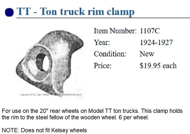

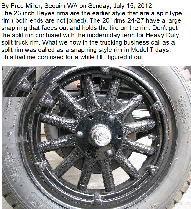

Post by TRDxB2 » Thu Jun 01, 2023 1:58 pm
close up........... &
They are marked Firestone
Post by Jacob Mangold » Thu Jun 01, 2023 3:46 pm
Yep, my locking ring type rims for my TT have the Firestone clips as well.
