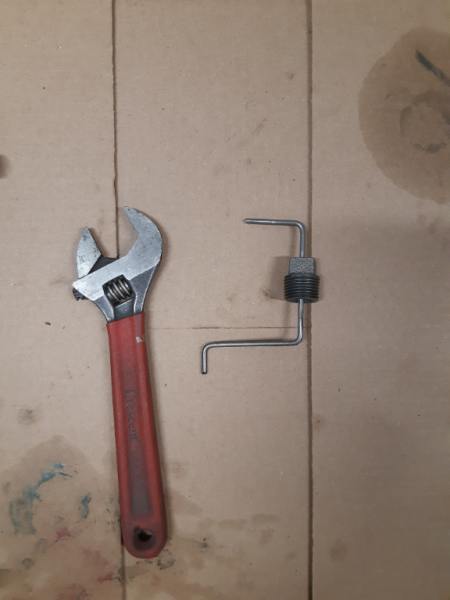

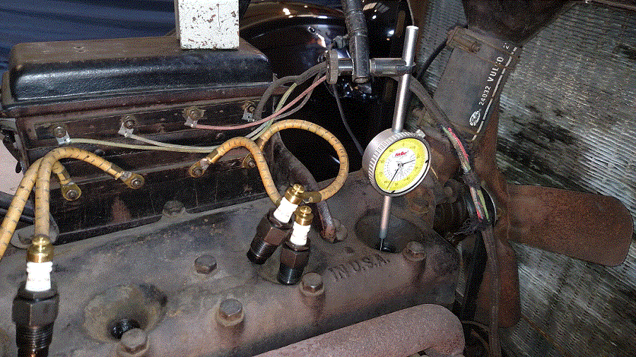

Remove the #1 spark plug, insert a wire like a coat hanger wire into the spark plug hole and angle it to ride the piston. Watch the wire go up and down as you crank the engine over. You will see TDC easily.

An old trick was to use a straw from McDonalds resting on the piston. You can also use a dowel, a metal rod, whatever. Or do it with a friend and have him/her watch the crank pin as you slowly crank it. Lots of good ideas here. Remember, if you go to far, 2 times around and you are back at TDC. If the crank is tight, loosen all 4 plugs and it will be much easier to turn.

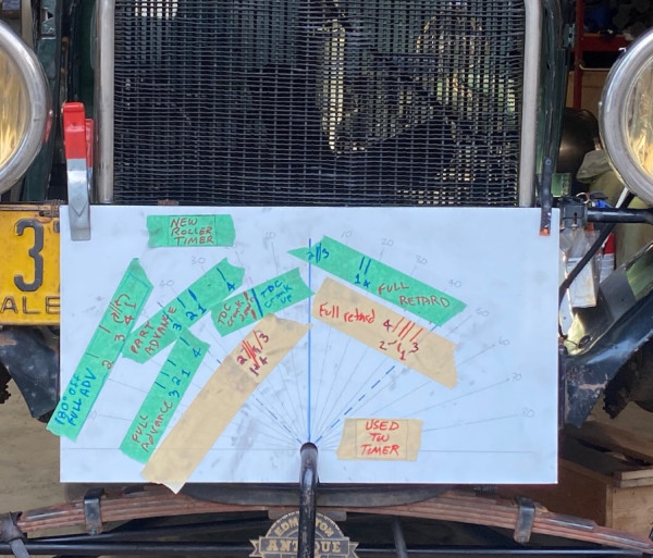

This has been interesting. And very puzzling.

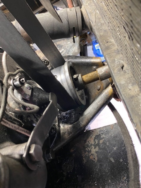

The TW timer appeared to be +/-10° earlier timing on #3, so I replaced it with an unused repro roller timer. I took Jerry's suggestion to align the pulley split straight up vertical to ensure the crank pin is horizontal, thus positioning pistons 1 and 4 at TDC. I bulked up a broken hacksaw blade and jammed it down the split as an indicator, then adjusted the crank position minutely until the blade appeared vertical when aligned with the block casting parting line. RH photo is with the saw blade reversed to confirm position.

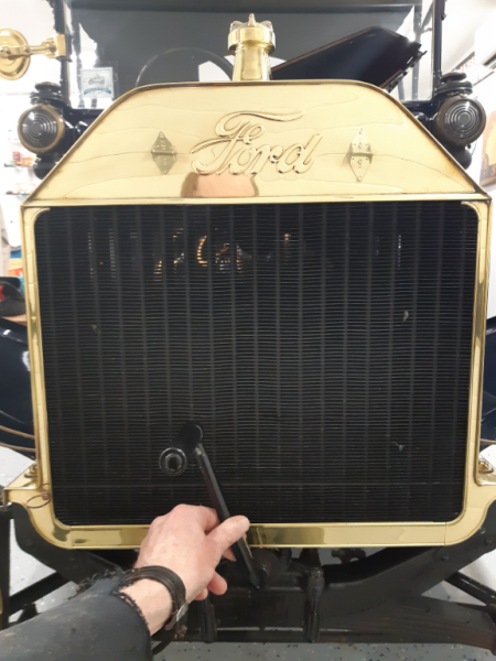

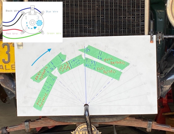

I then made up a rad-width protractor to mark and measure actual TDC and the first spark on Bat for three timing lever positions: full retard, partial advance, and full advance. There are two TDC positions shown (with the hacksaw blade unchanged). These are one reading with the handle up and one with it down (I expect the variation is socket irregularities). I used the Blue crank position for all readings. All measurements were done twice, although only the Full Retard is shown twice. There was good repeatability throughout. While the absolute readings are of interest, relative positions are probably most important.
- The crank pin is horizontal when this crank handle is 19° before vertical
- Full retard ranges from 21-37° ATDC (16° spread) compared to, if I recall correctly, typically 15° ATDC and minimal spread
- Partial advance varied 8-27° BTDC (19° spread)
- Full advance varied 28-48° BTDC (20° spread)
So, here's what I don't understand...
— why does the spread from first plug firing to last plug firing increase by 4° when the spark is advanced?
— Why does the distribution of firing times vary more with advanced start (from 2 pairs at retard to 4 different at advance)
— looking at the commutator wiring diagram, I see no scenario where segments 1 and 4 (opposites) are both late while 2 and 3 (also opposites) are both early. This would indicate the timer is oval shaped, no?
- although the timer cover is a bit sloppy in the front plate, I can't see which direction it should go to correct this imbalance in firing times.
The engine enjoyed a recent professional overhaul and the coils are adjusted for consistent time to fire (+/- a few Ms). I generally run on magneto, but assume if the timing is this uneven on Bat it will be out similarly on Mag. Big tour next week!
What am I missing?

Sloppy timer fit & gear cover variation will account for minimal firing variation. Your firing inaccuracy is due to the spacing in the timer bodies contact ingress positions. Try locking the timer down turned 180 degrees. Your new results should prove timer contact error. I would not have expected this kind of variation in a roller timer, but have not tested them myself.
Try a new day timer. They do have varying amounts of error depending on the position of the contacts in the mold. The worst I have seen can vary +- 6 degrees @ the crank.
If you want the most accurate timing, I believe that can be attained with a anderson type flapper timer. Using the same protractor setup, The variation can be removed by tweeking the contacts.
I have been able to get accurate timing from New Day's by re-cutting the ingress points on the contacts to take out the varying manufacturing error.
Of course, timing cover error is eliminated from the timer recess by accurately centering the gear cover.

Chris
when on battery, the plug fires exactly when the contact is first made on the timer housing and if that housing has any built in errors, then the plug firing (timing) will reflect those errors
when on MAG, the plug can only fire on sine wave output of the coil ring (and a contact is made in the timer concurrently), meaning, just because the roller/flapper has JUST made contact, no plug will fire until (while on some portion of the contact) the magnets pass a pole face on the mag ring. Ron Patterson did a very good paper on this and is worth researching on the forum
Note: if there are errors due to misalignment of the timing cover or a mechanical error (such as bent ANCO tab) then when on battery, no coil tuning whether by amperage or TTF will make the car run its best as you are at the mercy of whenever the timer first makes contact...however when on MAG, because the firing is dead even due to sine wave input from magneto assembly, then a very accurately tuned coil will result in a very accurately firing plug.
This is why when on battery, every tiny bit of timer lever movement results in spark advance, and when on MAG, you can move the timing lever through quite a range of movement (several notches) and nothing changes until a significant movement of the lever occurs...this change being the timer having finally moved enough that the advancement of the timer is sufficient to catch the earlier occurring sine wave crossing, or "node" as described by Patterson.
Don't sweat this thing and enjoy your tour.

I made a tool to check the timer accuracy and initial error The device consists of a used camshaft, a timing gear cover, a camshaft gear, and a fixture to hold things in place. I found a degree or so of error at the timing gear with roller timers. The crankshaft error is twice this. I will post a picture as soon as I learn how to post a picture.

Thanks everyone for your comments.
Scott, that makes perfect sense and I have known that but forgot it. Yes, with minimal coil TTF variance, the ignition should fire pretty much evenly on Mag.
Speedy, excellent suggestion to rotate the time cover 180° and re-check at full advance. Results are in the photo, far left.
I replaced the new roller timer with the previous, used, TW timer. Much less variation from one cylinder to another (beige tape in photo). I find it remarkable there was this much variation in a brand new roller timer. No surprise the timer industry was a big, big business back in the day!

nsbrassnut
Posts: 148
Joined: Sun Jan 06, 2019 5:30 pm
First Name: Jeff
Last Name: Lee
Location: Nova Scotia
Re: Question re setting timer position at full retard…
Post by nsbrassnut » Tue Jun 06, 2023 12:37 pm

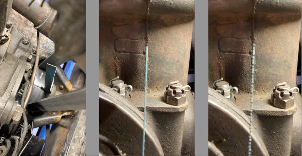

Hi Mark
Agreed, 1/2" or so is way far retarded. And too much retard will make them very hard to start, especially on the hand crank. I actually target near TDC on my own cars. So please ignore my earlier comment on piston position.
So to help with the discussion I went out this afternoon and actually measured (more or less) where my '15 is currently set for full retard.
I think that I originally targeted TDC or where the piston just started to move down. Its current setting is actually slightly BEFORE TDC to fire the coil on battery. The coil is firing about 1/16" +- before TDC. And even there I can choke the engine cold, turn 5 spins full throttle, then turn the throttle back to 1/2 or so, and get a free start 4 times out of 5 cold. And it will start hot with only a pull or two and needs very little throttle to start hot.
And I haven't experienced any "kick back" hand cranking with it in this position either. Although I would recommend aiming for more for TDC or just where the piston changes direction.
Here is a picture of where my crank is when the coil is firing on battery. And also one of my low buck home made piston position indicator. A pipe plug with a small holed drilled in the middle and a coat hanger wire indicator. The top of the wire is bend over to point in the same direction as the wire that will sit over the piston so that you can check that its aligned.
Drive Safe
Jeff

Posts: 6672
Post by Scott_Conger » Tue Jun 06, 2023 5:37 pm
Jeff, you will, eventually as it is a mechanical and statistical certainty. With only the slightest wear in the linkage, your timer will be even more advanced than it is and it is going to bite you. With a hand crank car, I'd really suggest that you rethink your position ;)
For those with good insurance an high tolerance for pain, timing the car at TDC is how you get the most performance and greatest advance possible when running on a 6V battery and has been the "secret" performance improvement of many "T" owners for years. I would not recommend it. And, I'd advise folks who do, to only use a starter and keep a repairman's phone # close at hand!
There is another 6V performance "secret" which involves coils but I do not wish to bat that bee's nest today.
