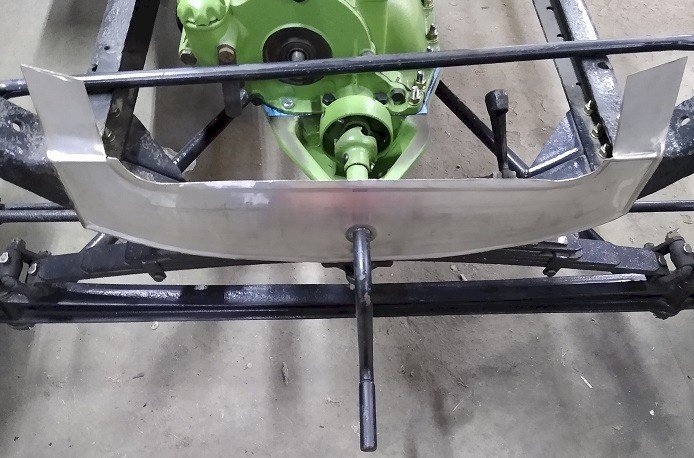

I’d install that below radiator shield (through which the crank protrudes) before the front fenders.

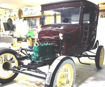

And install that steering column after the body is lifted up and on the frame, would be too high a lift to put that tall coupe body over the steering column.
You may want to refer to a series of posts by Bruce Brakke on his '26 coupe assembly process with nice photos. Just click on his user name, BLB27 and his posts with titles will come up for easy viewing.
Here is his 'body drop' day photo, body on frame, yet to place steering column.

Re: 1926 Coupe assembly order? need help
Thanks,
George,
I forgot all about the radiator apron. Need to finish making the part.
George,
