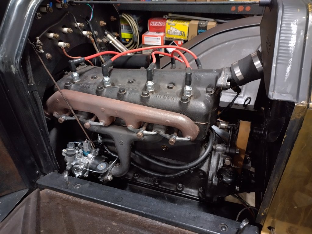

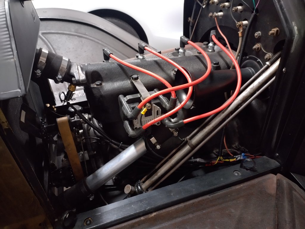

Some of you may have seen this on the Facebook model t page but I wanted to post a couple of photo's here also. Spent the last year and half working on this. I've been wanting to learn about DIY fuel injection for several years and finally decided to use my 16 t for the project. This isn't so much to replace the carb and Ford ignition but more of an experiment. Since my t is a hobby vehicle I could let it sit for awhile during the project.
In a nutshell I'm using a Honda CB250R integrated TBI, VW smart coil and a Speeduino NO2C DIY kit. Merging modern electronics to a hand cranked primitive engine was quite a challenge but I figured out a work around for most problems. Still in the tuning stage but it's slowly running better.

Is that a thermocouple for coolant temp on the hose flange at the head?

Re: Fuel Injected t
GM temp sensor

(1/1A) Anderson timer is used, advance/retard is manual just as Henry designed it. I designed and built a couple of circuit boards to fire the VW smart coil from the Anderson timer.
