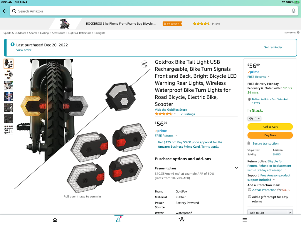

Has anyone used the wireless LED bicycle turn signals available form Amazon for around $60? They are rechargeable, said to be bright and easy to install (on a bicycle). If adaptable to a Model T without drilling holes, running wire etc. this could be an ideal safe solution to driving in traffic.

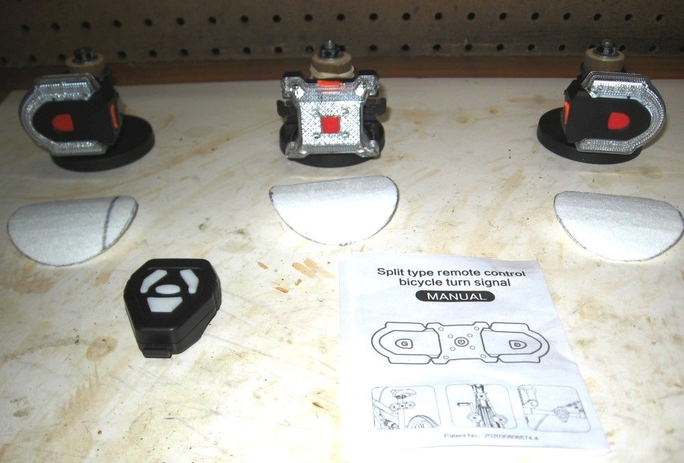

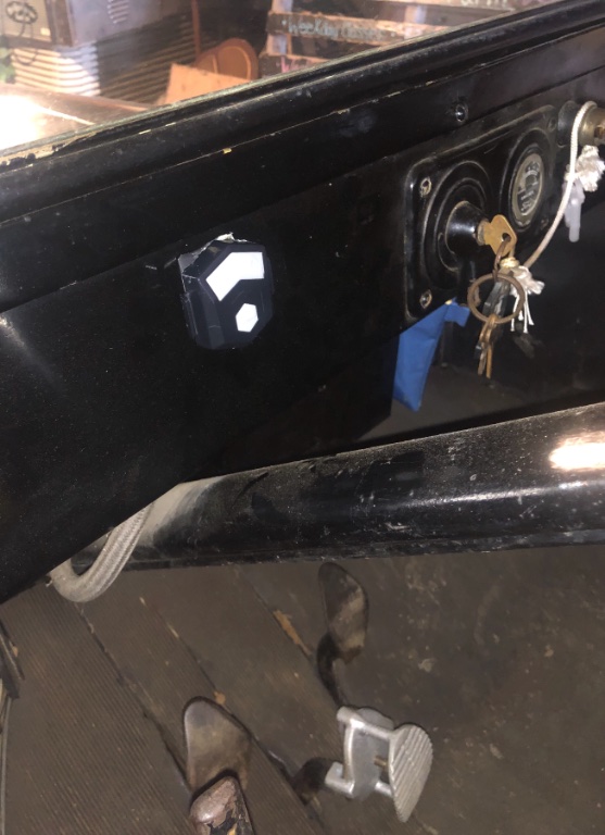

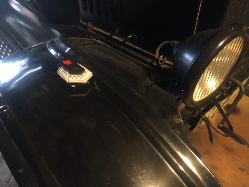

I use them on my roadster. I bought rare earth magnets and glued them to the signals. They work great and it allows my wife and daughter feel better when I take my granddaughter for a ride. They make me feel safer because many of todays drivers take a left turn hand signal as an invitation to pass me instead the correct meaning.
I find that they last for a few trips but don’t hold a charge if I leave them unused for a week or so. They come with a charger that does all 4 at once, but not the controller, it needs a separate cable to charge.

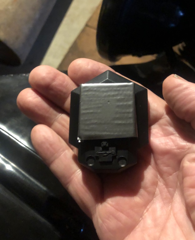

Re: WIRELESS BICYCLE TURN SIGNALS
I have been using those wireless signals for months now. They work great!
I also added strong magnets to the back of the signals and dremeled off the protruding plastic square on the back. I added duct tape to the magnet to prevent scratching.
I did the same to the controller and stick it on the firewall in front of the steering wheel.
The signals work well but need to be charged periodically.

Just to follow up. I have purchased a set of these and after initial charging I am impressed, and at only $60!! I will be attaching strong magnets to the back of the lights and attaching the controller to the steering wheel spider with the included mount. I can experiment with the light locations to achieve the best visibility. Now, if they last more than a year I'll consider it a WIN!!!

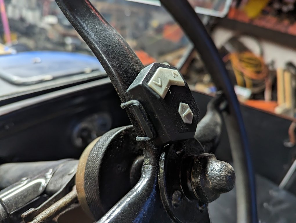

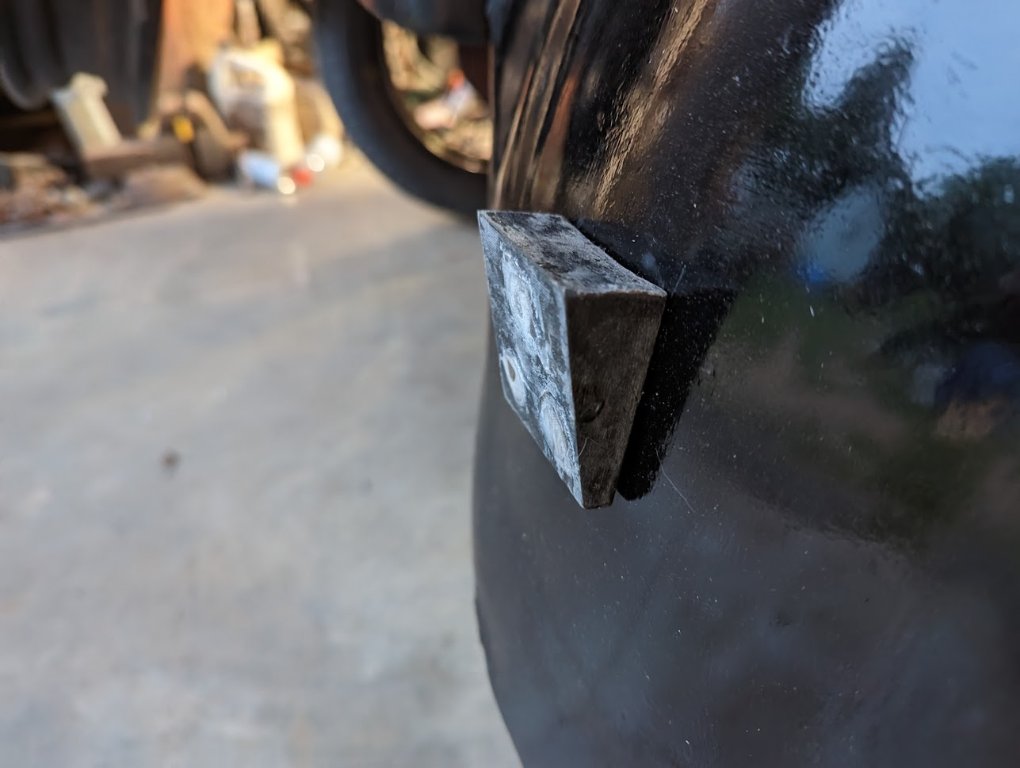

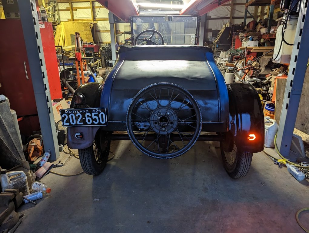

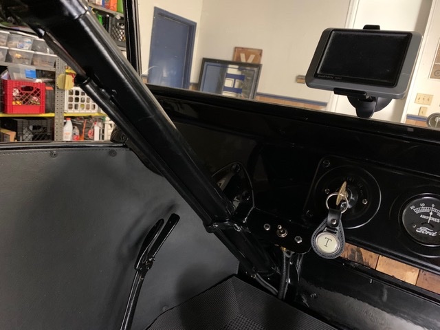

Here are some pictures of how I mounted the bicycle lights on my 1926 Roadster. The front and rear wedges are 3-D printed with a curve to fit the fenders. They have recesses for the six magnets, three to attach to the fender and three to attach the light to the wedge. I will be attaching cloth to the wedge to keep it from scratching the body.

Robert, They look great. Will do the Steering mounting like you did. Will look for magnets!robertw413 wrote: ↑Thu Jun 08, 2023 9:17 pmHere are some pictures of how I mounted the bicycle lights on my 1926 Roadster. The front and rear wedges are 3-D printed with a curve to fit the fenders. They have recesses for the six magnets, three to attach to the fender and three to attach the light to the wedge. I will be attaching cloth to the wedge to keep it from scratching the body.

I bought a set of wireless bicycle turn signals to try on my 1912 Flanders. I made some mounts on magnets to hold them to the rear fenders.
They worked as advertised, but in my opinion I don't think they are really bright enough to be of much use in the daytime.

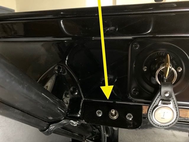

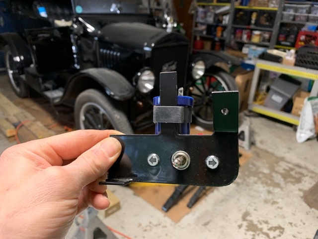

Just wanted to show a wired version I made up for my ‘23 Touring. I made a bracket that uses the bolt on the steering mount and screw that holds the lower left corner of the instrument cluster so no modifications.
The blinker unit is on Amazon for around $8 for two, the signal indicators and switch off Amazon as well.
For lights I found some glass turn lights at a flee market. Makes a nice wired kit and plenty bright and runs off electrical system so no battery worries.
David
David
