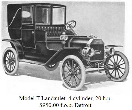

Ford USA used the following illustration to explain what they meant by Landaulet:

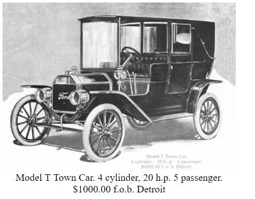

Ford USA used the following illustration to explain what they meant by Town Car:

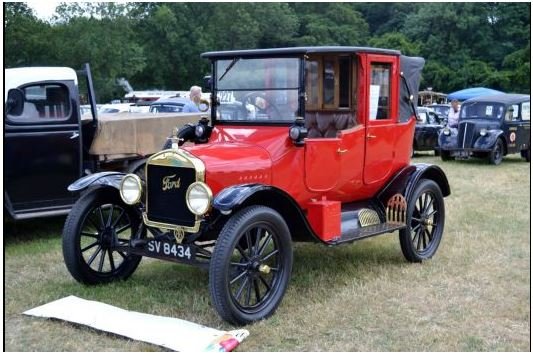

Found a library picture of the car at
https://www.google.com/search?q=model+t ... WfBXJGOWTM:
Couldn't work out how to post it, sorry.
Len
Len

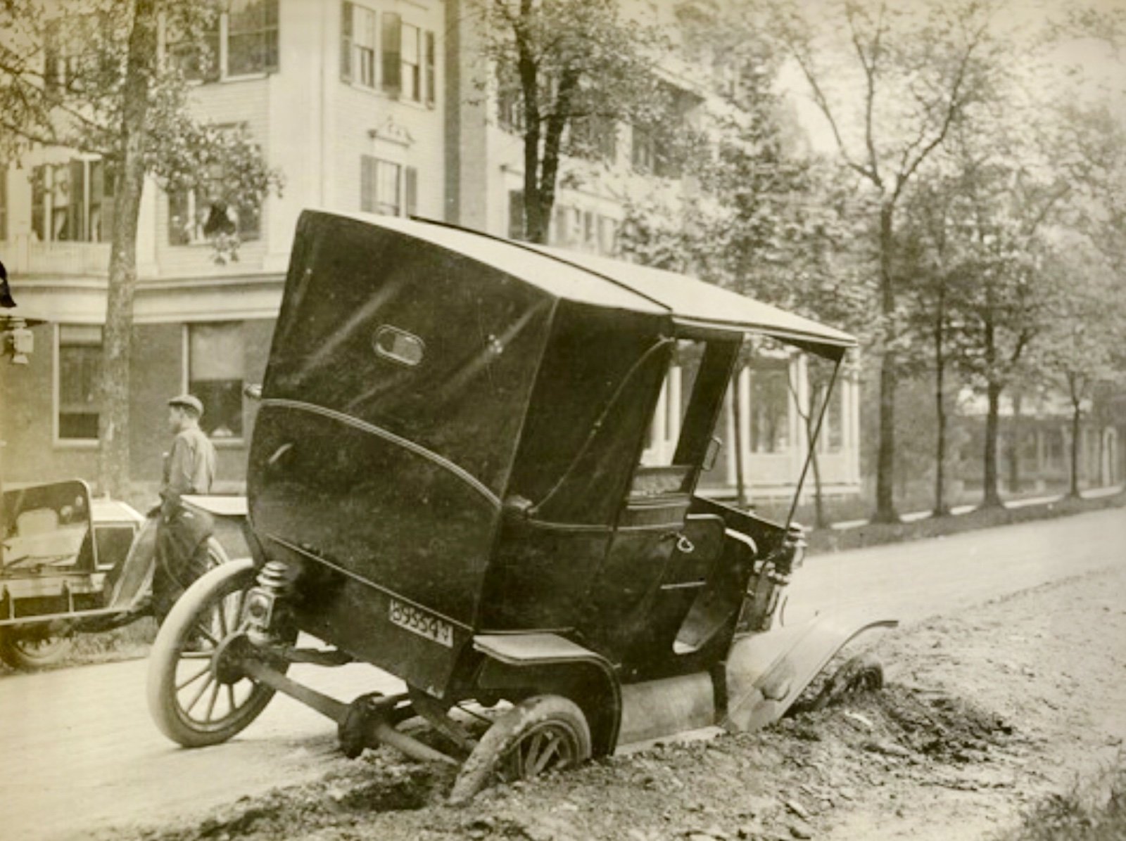

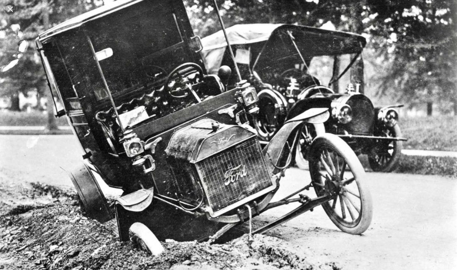

Here are two photographs of a 1909 stuck in the mud.
KP
KP

When I clicked on your link it took me to the photo shown below. "IF" that is the photo you meant, and "IF" the fenders, hood, radiator, are of the same style that originally came on the car from the factory, it would be a 1917 or later. All those items could be changed out (bolt on items).
There are quite a few photos out there. But if this is your first Model T Ford and if you are planning to drive it quite a bit, I would strongly recommend that you check it out for size. If you have a slender build and are 5 foot 8 inches or so -- it probably would be bad. If you are over 6 feet or like many of us -- getting a little more round than we once were, you will find that the 1915-1917 town cars have less room between the steering wheel and seat than the open touring and runabout cars.
Also if this is your first T I would urge you to check out the English Ford Registry at: http://www.modeltregister.co.uk/ They are a chapter of the MTFCA and can be a great assist in helping you become more familiar with the cars etc. Also the Tuckett Brothers have a great support for the Model Ts in the UK -- see their site at: https://www.modeltford.co.uk/
