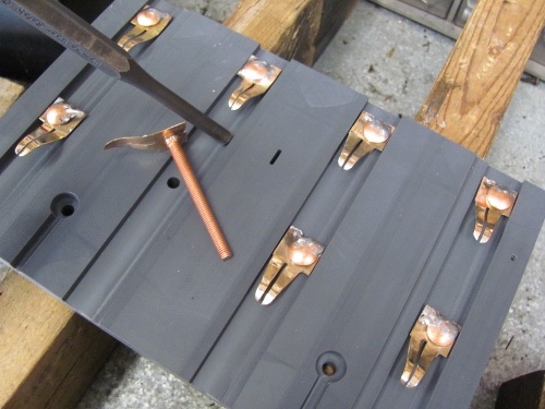

Chris
simply drawing the bolt in may possibly damage the porcelain tubes
use a small metal stump that fits into the recess and use it along with a vice or press. With the plastic fully supported around the outside, press the bolts home and they will force the plastic to flow and make a nice tight square hole. A small diameter deep-well socket is perfect for this as it will allow the bolt some place to go and will support the plastic very close to where it is being smooshed.
Take this opportunity NOW to sweat-solder your contacts to the underside of the head, allow to cool, clean flux off (use RMA mildly activated rosin flux, not acid!). Now you're ready to press things into place, using care to align the contacts before pressing.
Good solder flow:

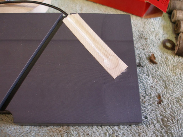

Fiberglass tape to insulate wire from bottom of box (your wire will likely lay in a different slot, but for your sake, be sure to use the tape to avoid a future short):
FWIW, it was a good choice to chose the plastic kit over the wood kit. The increase in reliability far exceeds any perceived downside of using non-original materials...no one wants to be stranded in a downpour.
Welcome to the affliction!

Re: Using composite Coil Box rebuild kit from Langs
Post by Bill Anziani » Fri Jun 09, 2023 4:56 pm
When I did mine, I did not use any heat or re-drill any holes
The square end did suck into the composite and secures the bolts

Posts: 6834
Post by Scott_Conger » Sun Jun 11, 2023 9:07 am
Chris
don't solder the contacts after installation...the bolts will take enough heat that the plastic may go soft.
EVERYTHING MUST BE CLEANCLEANCLEAN!!!
drill a hole in a piece of wood to fit the bolt
flux and solder the underside of the bolt head then shake off the solder
flux the tab
install bolt through tab and place on wood block
apply iron to corner of bolt and tab...solder should flow from below to make a nice silver ring around bolt head with no extra solder. If using an iron, be sure a small amount of solder is on the tip to make a thermal "bridge" from the iron to the part or it will take forever to get things to flow. A SOLDER BRIDGE IS A MANDATORY TECHNIQUE FOR SUCCESSFUL SOLDERING WITH AN IRON
alternately, with a propane torch, just wave back and forth over the assembly...flux will sizzle and then solder will flow. Don't dwell or overheat.
ideally you'll use flux-cored eutectic solder (63/37) which is electronic grade and is a solder which goes from solid to liquid in a very small range of temperature. Normal solder has a very long plastic stage and you do not want that. Also, find RMA (Rosin, Mildly Activated) flux to use NOT ACID FLUX.
RMA flux and 63/37 solder may have to be bought from the internet as you are unlikely going to find it at a Hardware store.
All clean up is done with alcohol.
AVOID LEAD-FREE SOLDER...you're not eating off of this, so there is no need to go through the agony and overheating of your parts trying to use the stuff.
Finally...for the bottom strip...determine which rivet your wire goes through (either left side or center). Clean, flux and tin the contact strip at the appropriate location. Flux and tin the wire. ONLY AFTER TINNING IS THE STRIP INSTALLED ONTO THE PLASTIC. Bring wire up and once it's through the rivet, form as necessary, flux and reflow solder to get a good joint. A good joint will be bright and you'll still see the wire strand lay in the wire. Clean with alcohol and you're good to go.
Last edited by Scott_Conger on Sun Jun 11, 2023 10:33 am, edited 2 times in total.

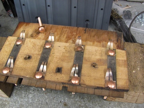

Posts: 4114
Post by DanTreace » Sun Jun 11, 2023 9:22 am
For easy soldering , used the old wood board and arranged the cleaned contacts and new bolts in order. With a small electric solder iron, easy to solder the contact edge to the bolt head.
As for insertion, transferred each one, in order to the new board, and used a punch on each bolt head and drove that carriage head bolt soldered to the contact into the new plastic insulator board. :)

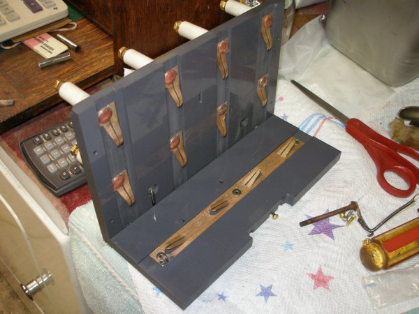

Post by IanMacLeod » Mon Jun 19, 2023 2:39 pm
Thank you all, friends, for helping me with this project, Scott Conger- your thoroughness is appreciated. I opted to special order the correct flux and 67/33 solder....project went pretty well, I installed the unit and reattached all wiring & surprise! It all worked! Thanks 1,000,000! C

Posts: 6834
Post by Scott_Conger » Mon Jun 19, 2023 3:59 pm
You're welcome
I'm glad things went well (that solder flowed nicely, didn't it?)
