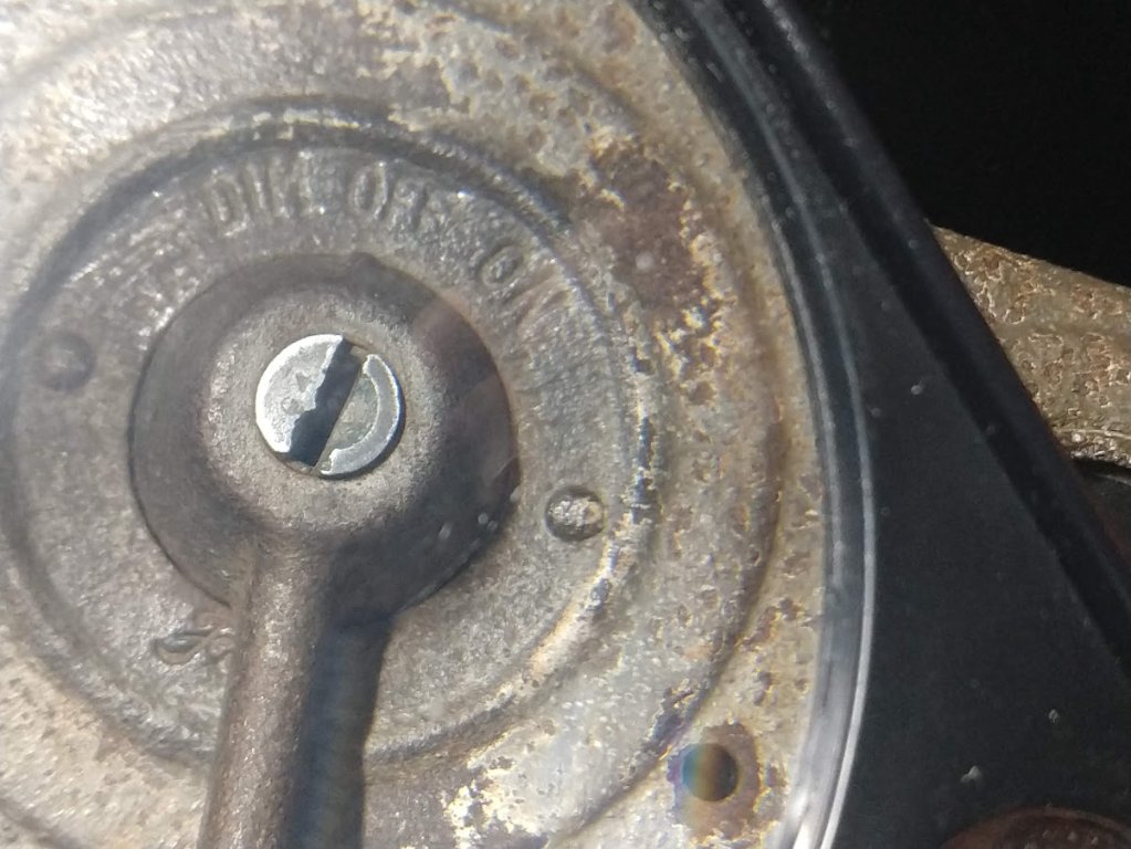

I am trying to figure out what this number is stamped on the ignition switch. What do you all think?
Thanks,
John

Looks like number 64

Looks like 64

I loaded the picture into my photo editor and cranked he contrast way up. I agree, 64. :)

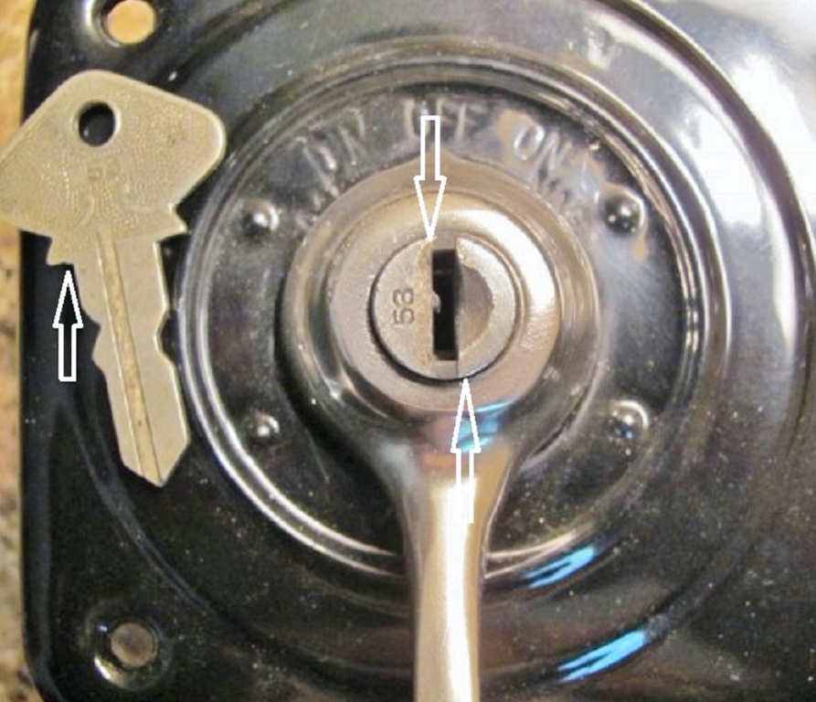

Good of that fix, so your key can operate the switch. As others noted, the pot-metal tumbler gets very worn out over the years, esp. with hard snapping of the switch, rapid key placement and removal, and even hanging a wad of other keys on a chain that dangles from an inserted key.
The design is made to give protection to the soft metal tumbler, as that tumbler has two corresponding recesses in the face.
Note the Model T key has mating notches that engage the tumbler and rests on the recesses, that helps to prevent too deep key placement that can lock the innards up. Plus it gives the proper leverage for the key to turn the switch to BAT or MAG.
Taking care to insert the key gently into an old switch tumbler will help preserve it.

There is a bit of missing pot metal at the bottom and top of the key slot as Dan's photo shows. Thanks Dan.

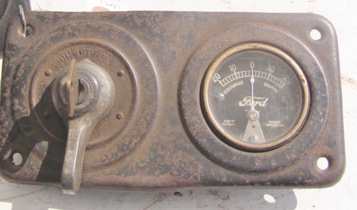

Dan's photo has 4 rivets holding the switch on. Mine has only 2. Is this an early/late thing? Which would be which?
John

The multiple rivet switch plates are early, there are many variations, esp. the early closed cars in 1919 that were first to have electric start, these used a unique switch without a panel and the ammeter was also separate up to about March of 1919. The open cars followed. Switches then came combined on a rectangular steel panel with the ammeter, and were made by several companies early on. Ammeter varied too in design, the early ones are very distinct. Then Ford kinda settled on a particular design, that is the common 2-rivet plate after about the 1920 model year, perhaps 1921.
Switch types.jpeg (37.23 KiB) Viewed 2316 times
Switch types 2.jpeg (67.31 KiB) Viewed 2316 times
Early 4-rivet plate.
Early 2-rivet with Bat and Mag on the center collar of the large cast nickel plated switch handle.

NY John T ..... Your 1926 year switch assembly was always mounted with two rivets on either a painted or plated mounting plate, that is oval sized instead of the earlier rectangular sized plate..... Except on the 26-27 TT TRUCK that still used the earlier rectangular plate mount assembly.
