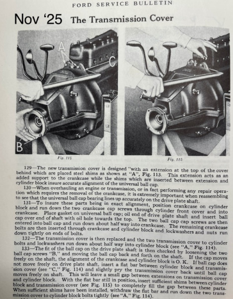

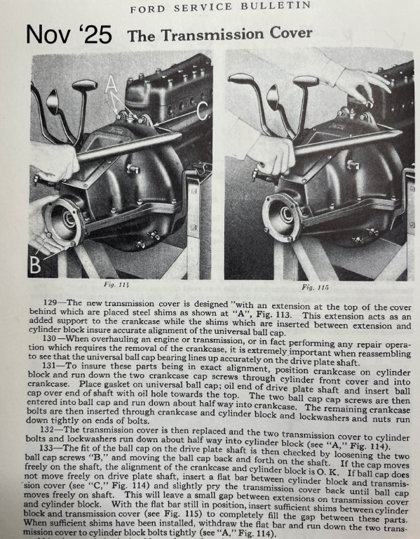

That new transmission cover for the Improved Car is shown in Nov. 1925 Service Bulletin, sans the straps. Gives info that the bolts and shims used are to secure the 4th main, to keep it true on the driving plate shaft.
As for when used, can only find ref. in the later Jan. 27 Parts and Price List, for these, #3117 Brace, Arm to Trans Cover Left, and #3116 Brace, Right.
Earlier 1926 Parts and Price List don't show the braces. Once restored a really original Nov. '25 Improved Car, the motor didn't have the braces, but I added a set. Perhaps the early '26 didn't have them? The braces were added for the later 1926-1927 model years.
Do know when working on a 'shimmed' hogshead, and then adding the braces, when the bolts have to be removed, takes some care to prevent the shims from falling down and away.

Good info, Dan. I've worked on quite a few both old and professionally rebuilt 26 & 27 engines, and I have never known to shim those bolts, if needed. I've never have seen a late block that had shims present, either.
Now I know!
