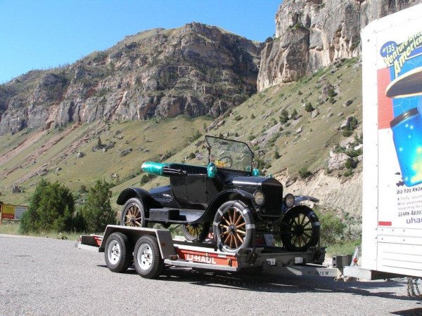

Beth, I towed my runabout from FL to WY on a UHaul trailer. Folded the upper windshield down and used 18" wide stretch wrap around the lowered top...many layers. Towed just fine. Just be sure to put a sandbag (child's sandbox sand) on the floorboards and remove the seat cushions. No problem.
We stopped for a stretch in Wind River Canyon
