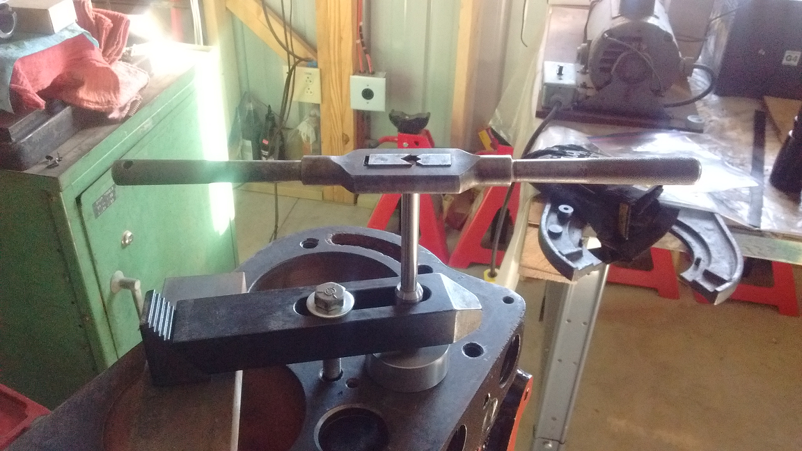

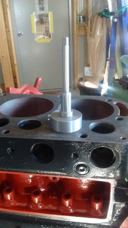

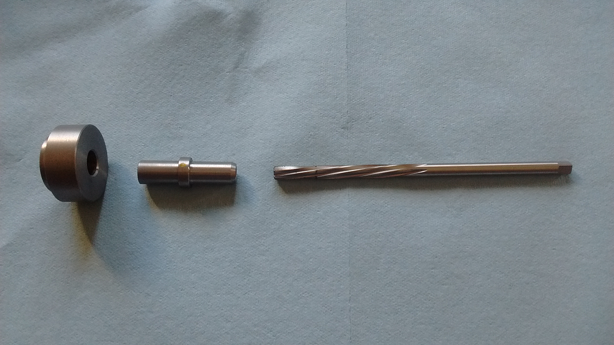

Not a problem, but you need to make a guide for the reamer:

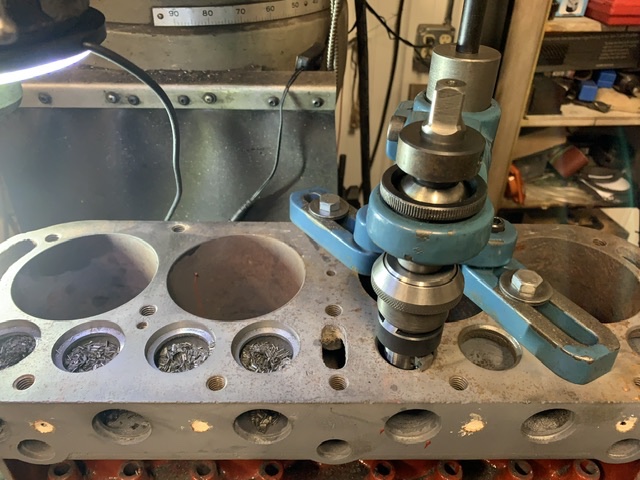

and after that, you'll need to cut new seats for the new valves...the Neway Cutter product is first rate and if you call them, they know Model T's and will build you a kit which will do everything you need. No subsequent lapping is needed nor recommended.
There was a Stevens Speed-up Tool made to do this job like my home-made setup, but you'll take 1/2 lifetime finding one and it probably will not fit your reamer if you do...

well, what not to do is drill it free-hand...I've had to fix a few of those and it takes awhile
someone will step in eventually and help you out...just wait and request it as necessary
In any event, I've never done an Improved Ford but suspect that the firewall will present an obstruction to this work and you may still need to hooch the engine forward to gain clearance/access to do the reaming...Just for info and not pertinent to your case but here it is anyway: after reaming the guides, the Neway valve seat cutter shouldn't be a problem as it is low profile and I've done plenty of valve seats (most of them) with the engine in place in the car.
