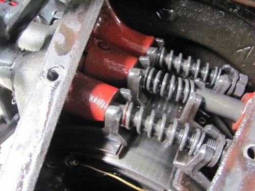

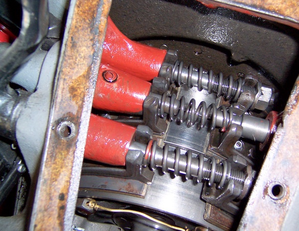

When can you tell it’s time to replace wooden transmission bands?
Posts: 4084
Re: Wood Band Replacement
Post by DanTreace » Tue Jun 13, 2023 4:21 pm
Like other linings, when the adjusting screw has compressed the band spring, and you can't get low to pull the T up that rise!
Here is a wood low band lining, that gave out it's effort, spring was drawn up rather fully on the low pedal shaft.Maybe there was more life left, but time IMO to change. You don't really want to change linings during a long tour!/b]
When new, note position of adjusting screw shaft
When adjusting screw has drawn up compressing spring.

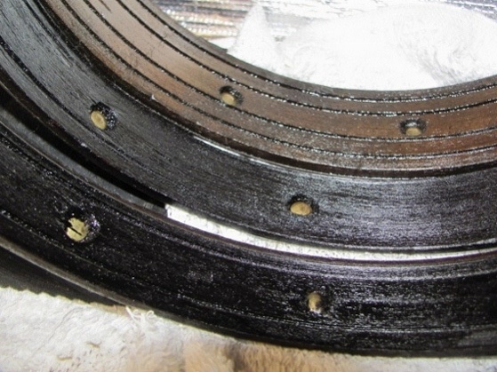

Look of wood low pedal lining after removal, compared to brake lining above, (R-M Brakes so little wear) and reverse lining below.

Thank you! Those pictures are incredibly helpful!
