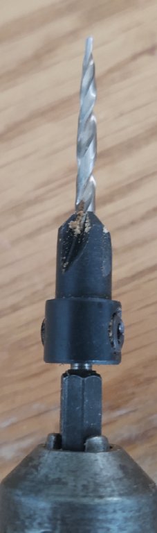

What size coutersink bit would I need?

Instructions and size of bit comes with the wood band liners when you order. If you do not want to mount the liners yourself, just contact the supplier and he will mount the wood liners on your bands, for slight extra charge that is.. picture is of the bit that I used, sorry I cannot find a size stamped . ......... Supplier: Jim Guinn. 714-222-6867 cell, 6082 Ridge Way, Yorba Linda, CA 92886. .... WEB :: www.guinnbands.com. , Email : jim@guinnbands.com . Jim advertises in our Vintage Ford magazines.
