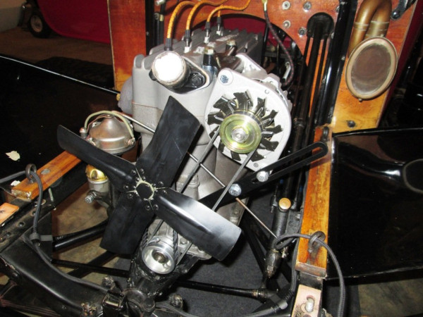

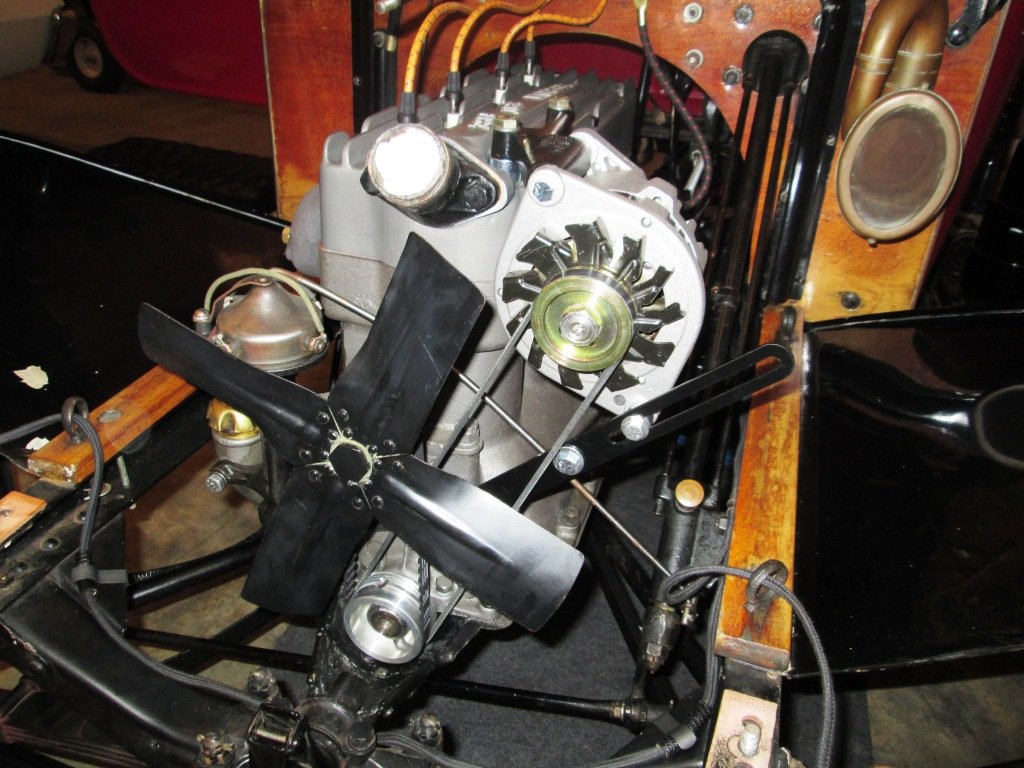

Here's an alternator kit on our '14 - be tough to fit a water circulator in the midst !

Thanks for the input fellas! I’m hoping to NOT go overboard on this project…🙄. I have been eyeballing the head mounted option but having a hard time envisioning the belt routing. Steve, your pic of the dual belts gives me hope, is your crank pulley a modified aluminum repro?

It was the pulley that came with the TTP kit Kevin. I agree with the Atlas circulator suggestion - could be a viable option. I might even have enough of them to make one or two if interested.
