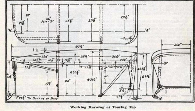

Post by DanTreace » Tue Jun 20, 2023 10:03 am
This working drawing of '20-'21 touring top may help, shows the center line distance of the upper footman loop on the rear bow. The lower looks to have an offset, but could help locate that footman loop on the rear tack rail.
