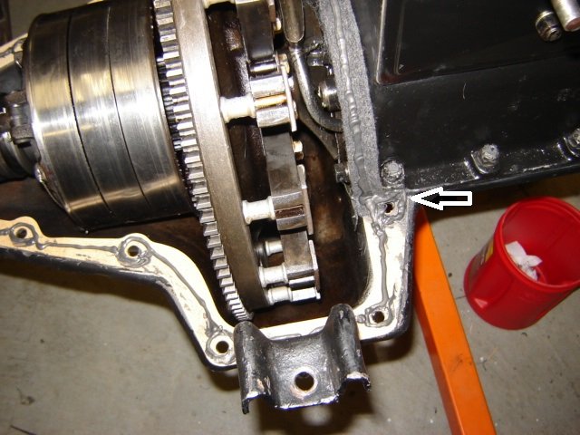

FROM By Mike Seager on Saturday, January 16, 2010 - 09:19 pm:
I just use the permatex ultra black and the standard felt out of the gasket sets and it works fine. I glue the gaskets on the night before so they cant slide around when i am putting the hogs head on. Then a nice coat of sealant before putting the HH on. It is leak proof never had a drop come by the hogs head. --- Note the arrow is a must place for permatex

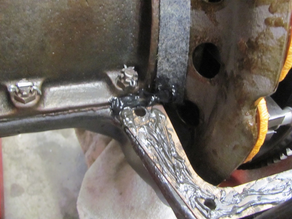

Re: Hogshead felt seal
i have always used the felts supplied in the kits. I have never trimmed the length. I lay it on the plastic wrap it comes in and work a heavy coat of black silicone into each side, ending up with felt reinforced RTV silicone gasket. i fit the two ends at the pan rail with 1/4" or so bent out onto the rail. Then the full length of the felt is worked down onto the land at the back of the block.This is just like fitting band linings. Fix the ends first, and work the rest into place. This worked just as well on the alloy covers on my three early cars.
It helps to hold the pan gaskets in place when fitting the cover. One of Ted Aschman's tinkerin tips was to cover the gaskets with RYV and fit them down on the rail. Put a couple of pan bolts through from underneath, and hold them there with cotter pins. These can then be withdrawn as you work the cover down into place.
