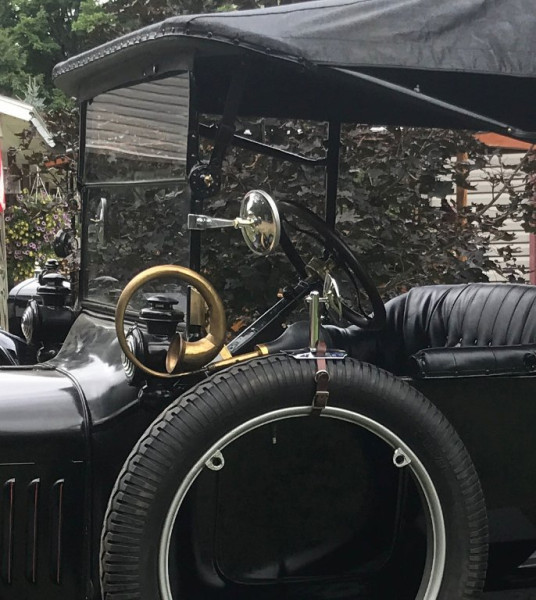

After trying other mirrors (clamp on) I settled on a pair from antique motor sports for my 1917 Touring. In my opinion they are the best available. For extra coverage I have a Model A type mirror attached to the spare tire on the left running board.

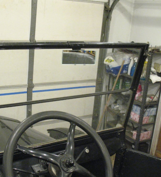

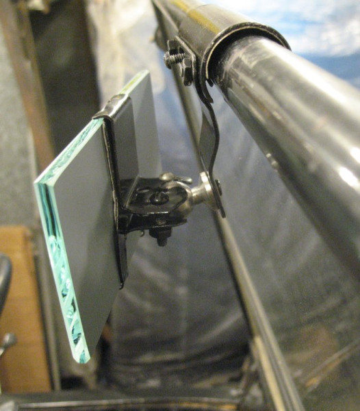

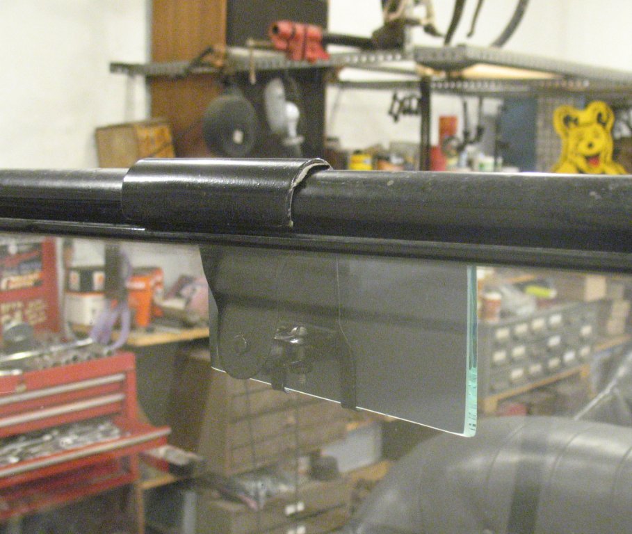

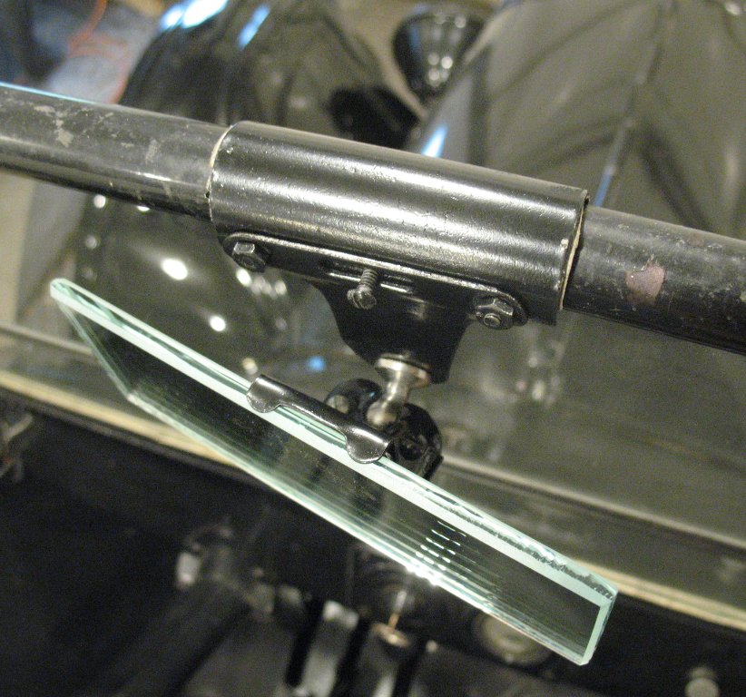

This mirror came to me in a pile of auction plunder. I made the windshield clamp from electrical conduit and Gorilla tape.
