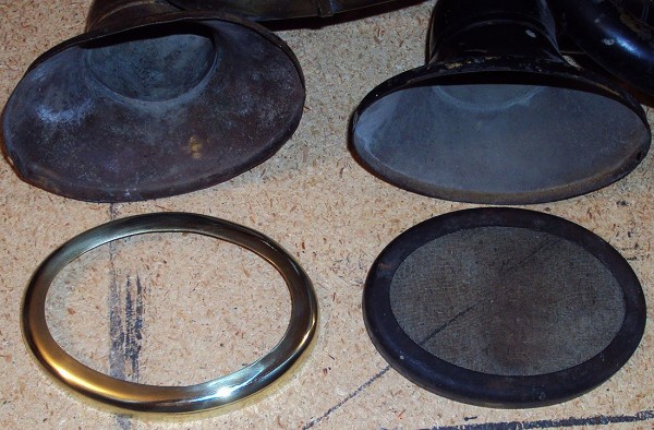

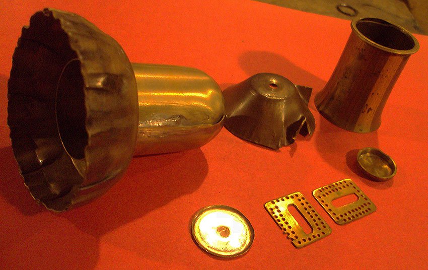

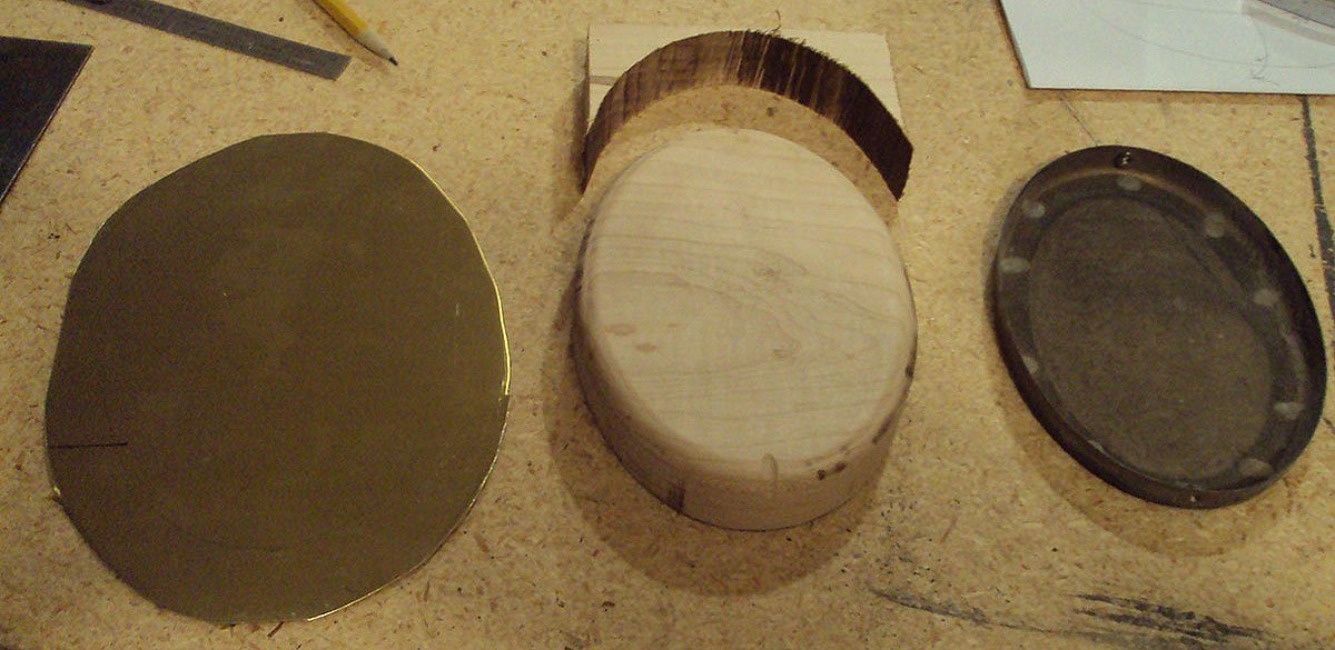

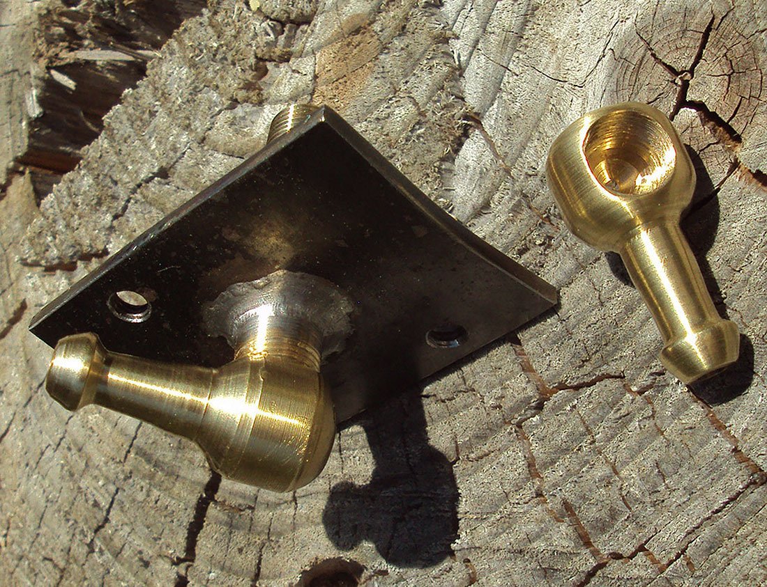

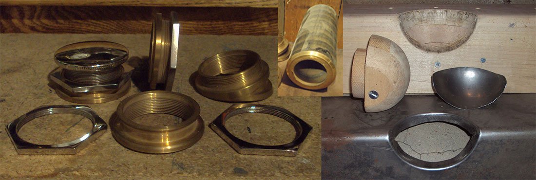

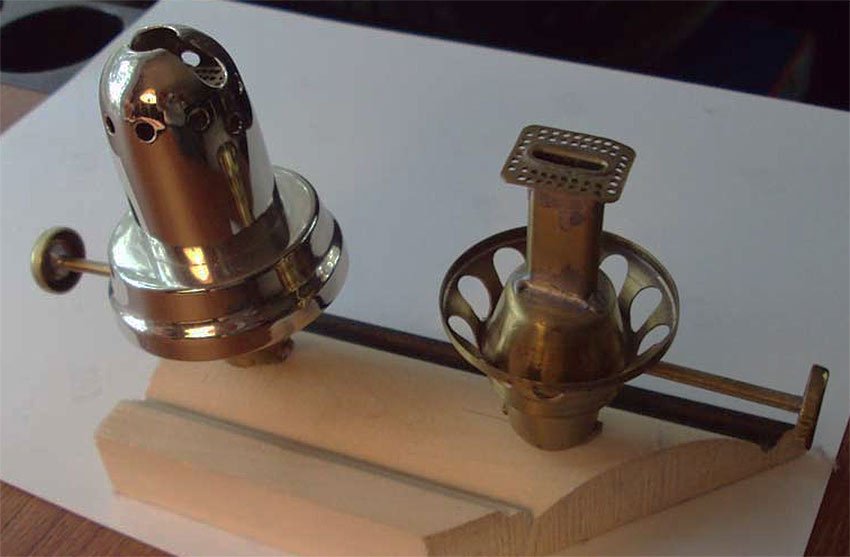

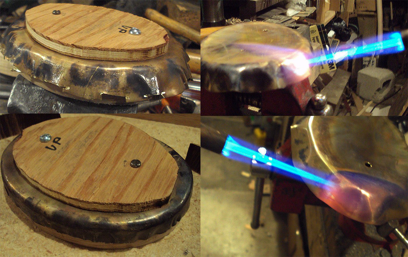

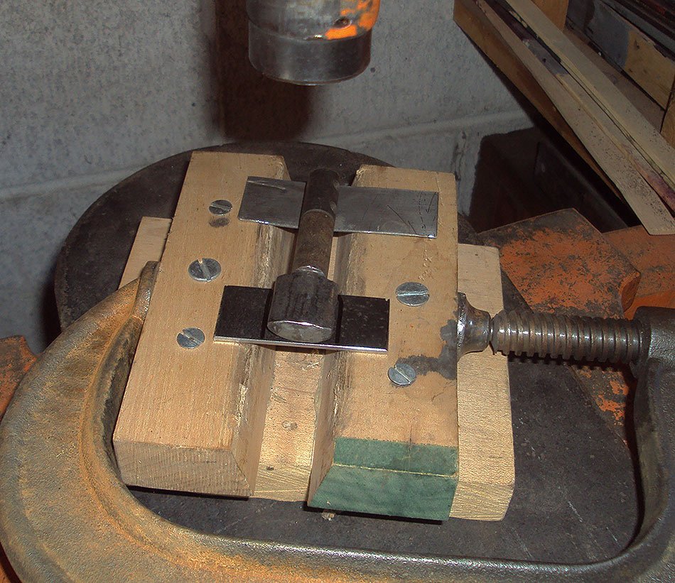

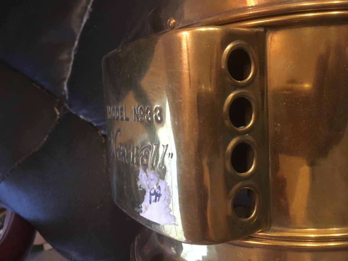

Part of the fun of keeping an old car is being able to make needed parts for it. Touring and maintenance have kept me busy and I haven't had to make anything lately. I thought some parts I made years ago might be fun to post now.

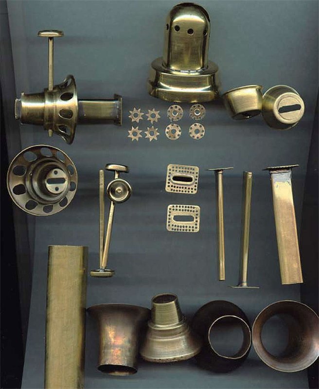

When the nice repro E&J burners were only $85 I decided to try to make some from scratch. Here is the post from 2012:
http://www.mtfca.com/discus/messages/25 ... 1326907131
Whether 5 weeks making 5 of these was worth the savings is debatable but the satisfaction was more that worth it.
There isn't much we can't make if we really want to. Forum members and other car nuts have proved that.

Very impressive as usual, Rich.
Not infrequently I find reproduction items don't quite work like they should, or one detail or another is lacking. I try not to look askance when that happens, as I know how incredibly difficult the work can be from my own experiences making "stuff". If time is money, I'm just glad no one is making me pay for the fun I have making things !

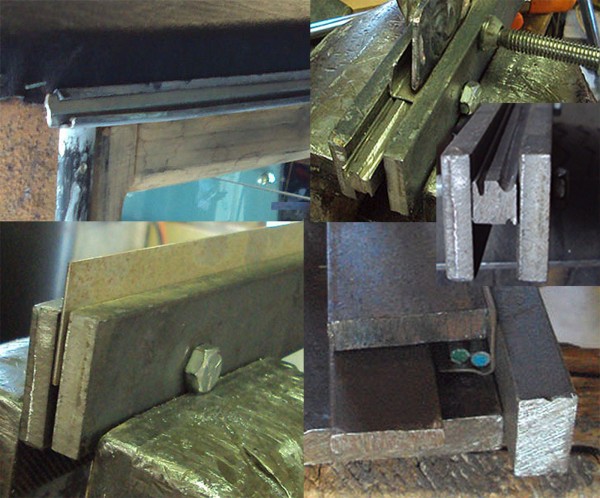

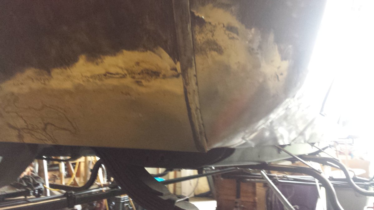

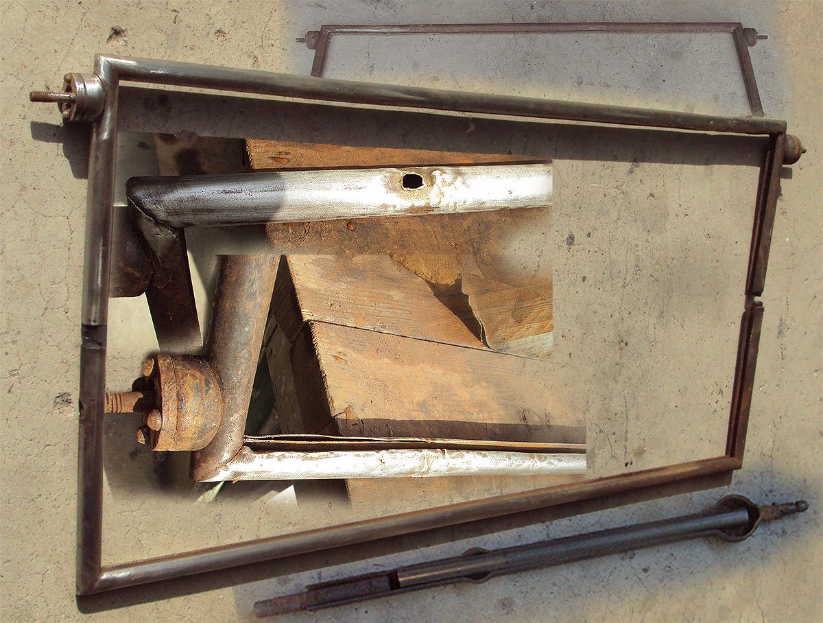

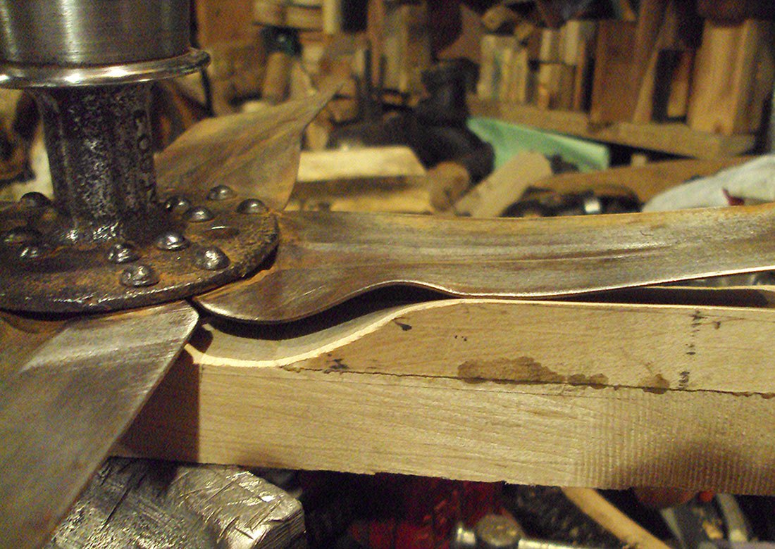

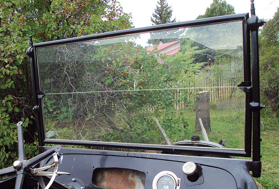

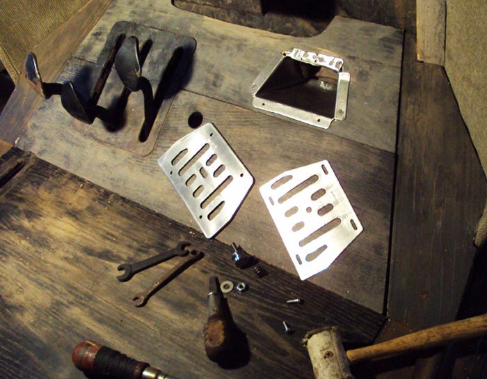

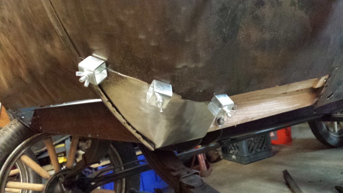

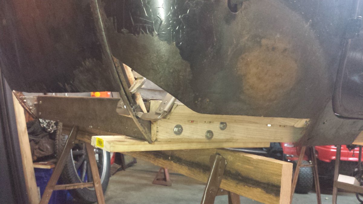

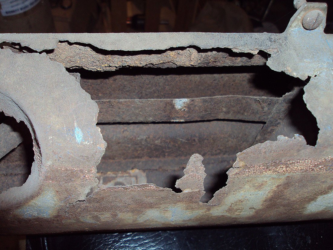

This was particularly satisfying, fabricating the lower rusted out patch panels on my 24 Touring, this is the rear corner that always rusts through I cut it out for a template
Don't know why the pictures posted out of order

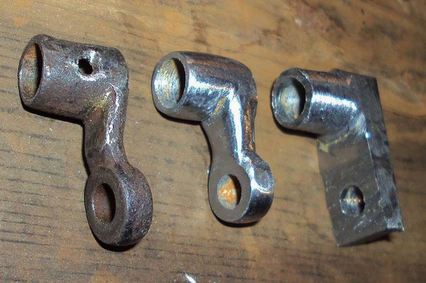

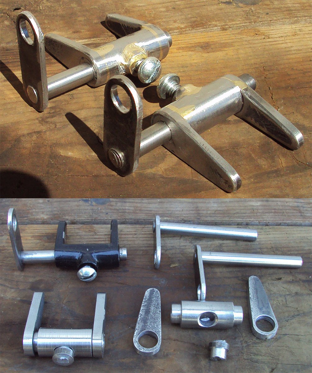

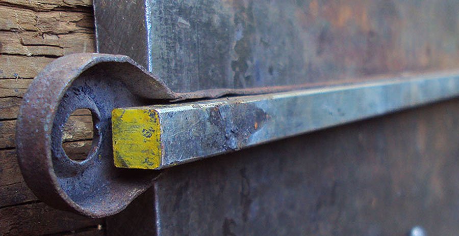

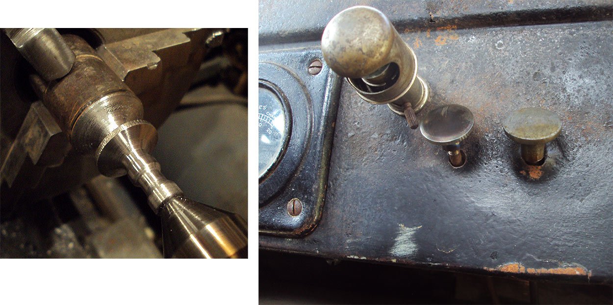

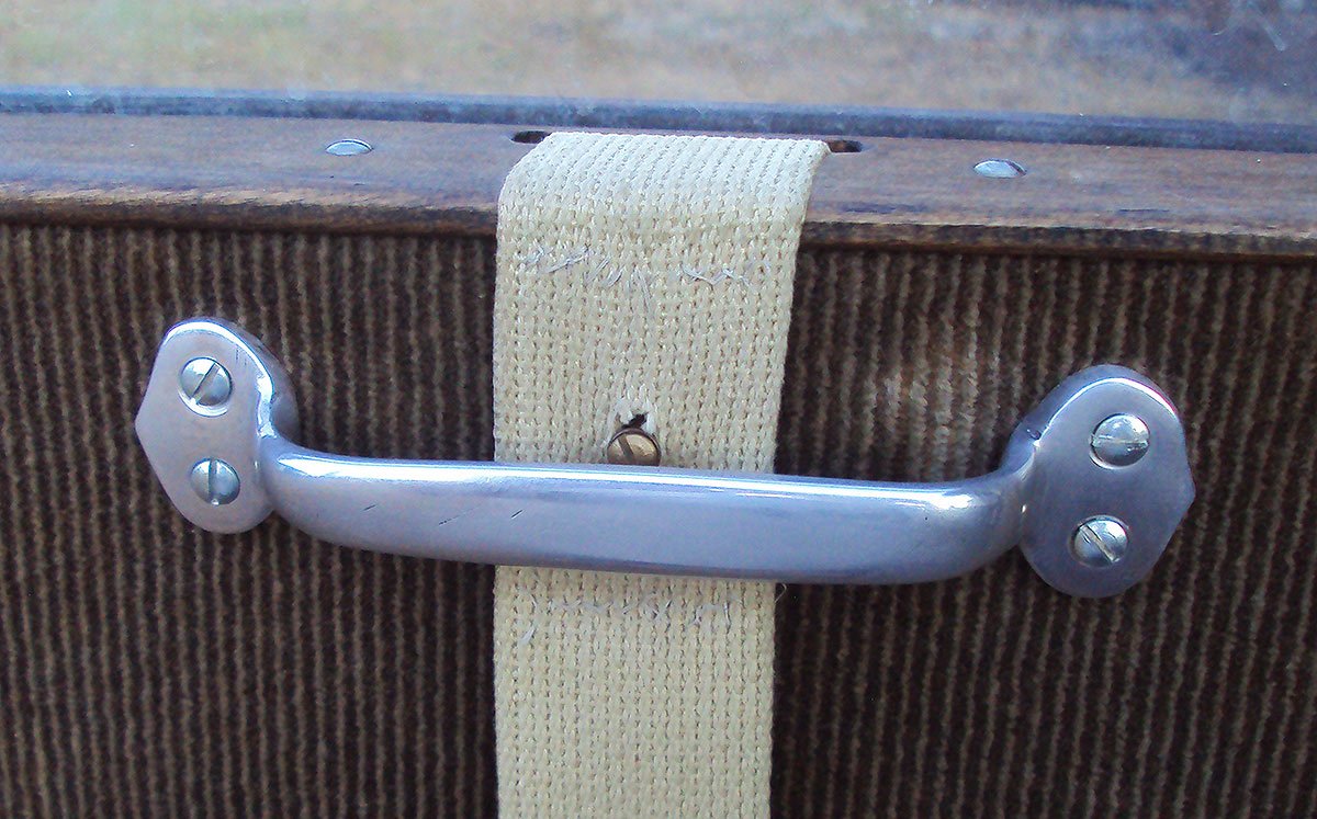

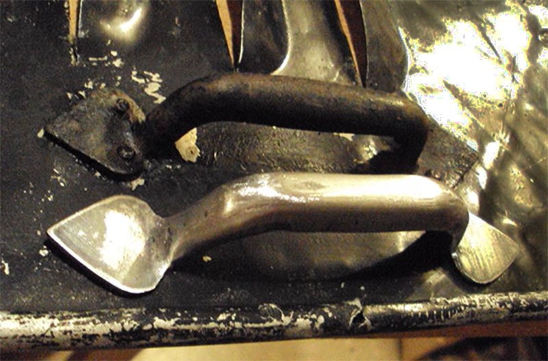

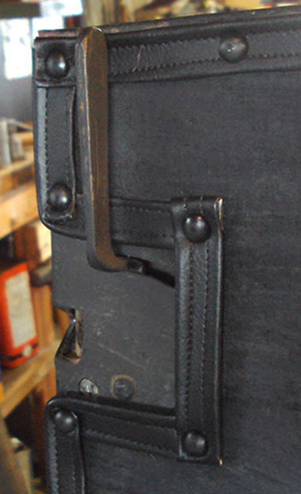

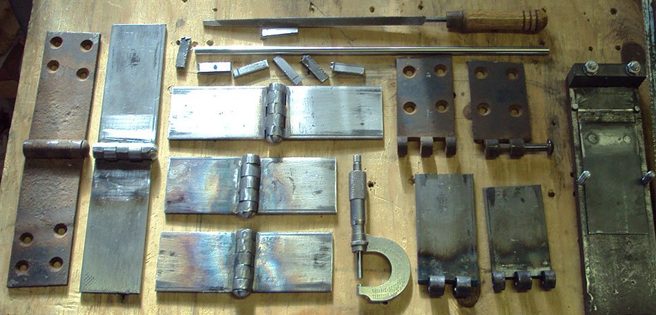

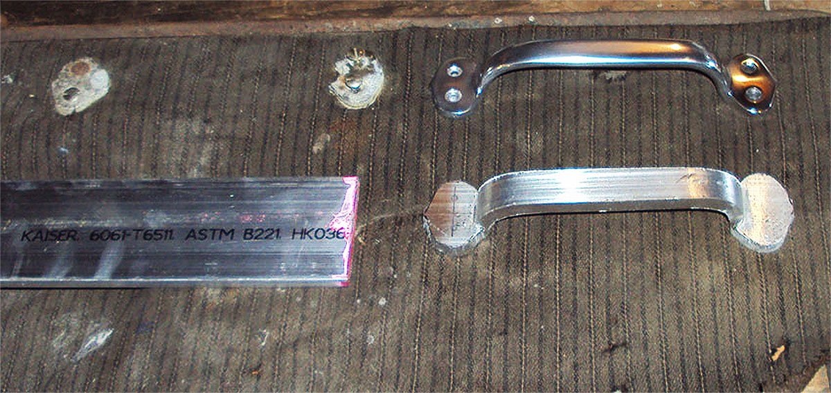

This is a simpler project. I needed a handle for my '15 hood.
http://www.mtfca.com/discus/messages/70 ... 1497523020

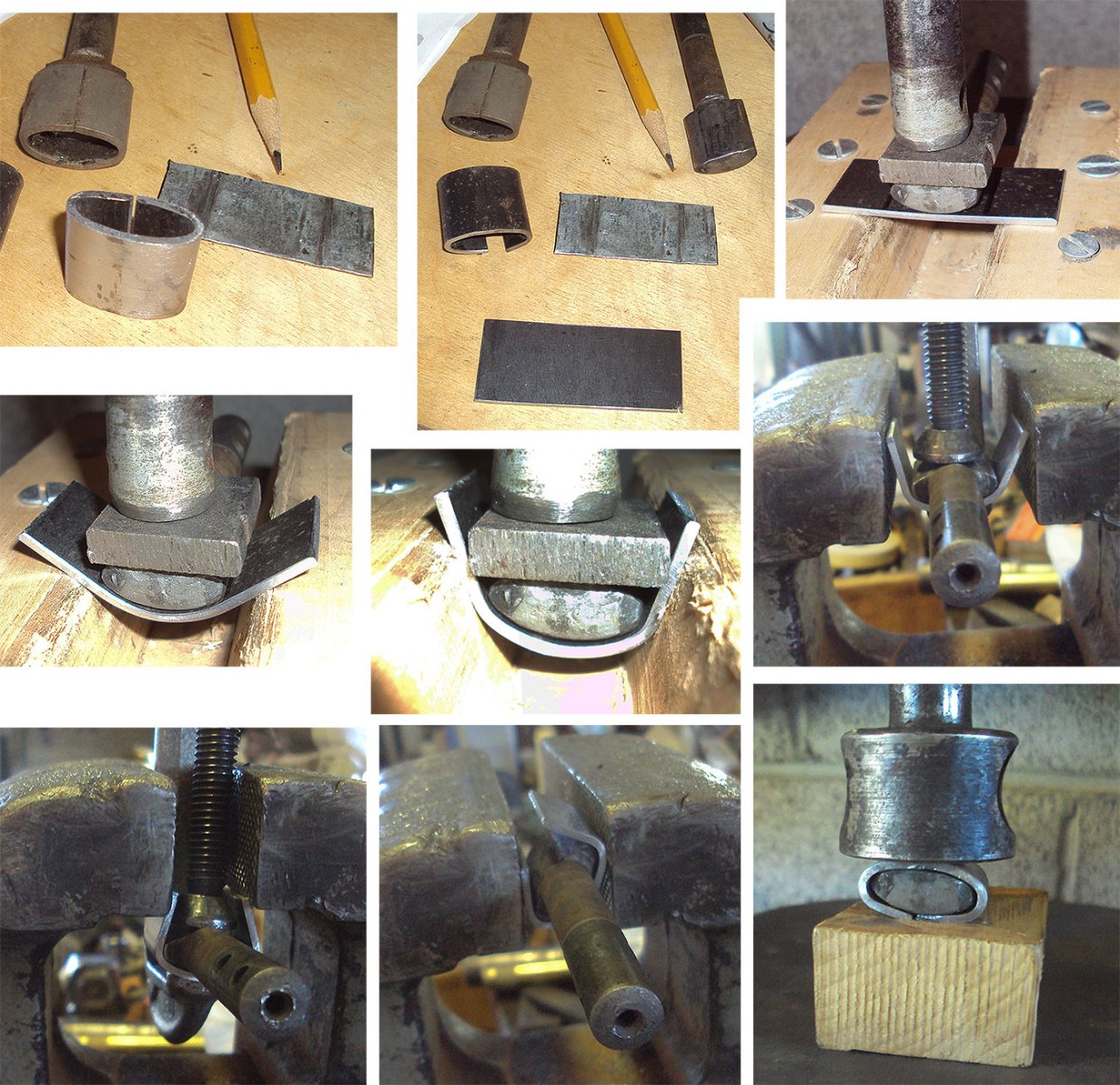

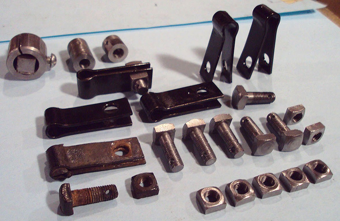

Making new sleeves for some top irons is show in this thread.
http://www.mtfca.com/discus/messages/70 ... 1510684831

I don't know how you formed those lamp burners. When I form parts they always look home made. My hood handles look wonky & uneven and yours look die formed.
Topic author - Posts: 6895
Re: Revisiting some fabrication
Maybe we make it look too easy when we just show stuff that turns out. Many of my parts do look horrible at some point and as if they can't be saved. I have a pile of things that didn't turn out. With some persistence most can be tweaked, tapped on or filed and polished to a better look.
Just keep at it.

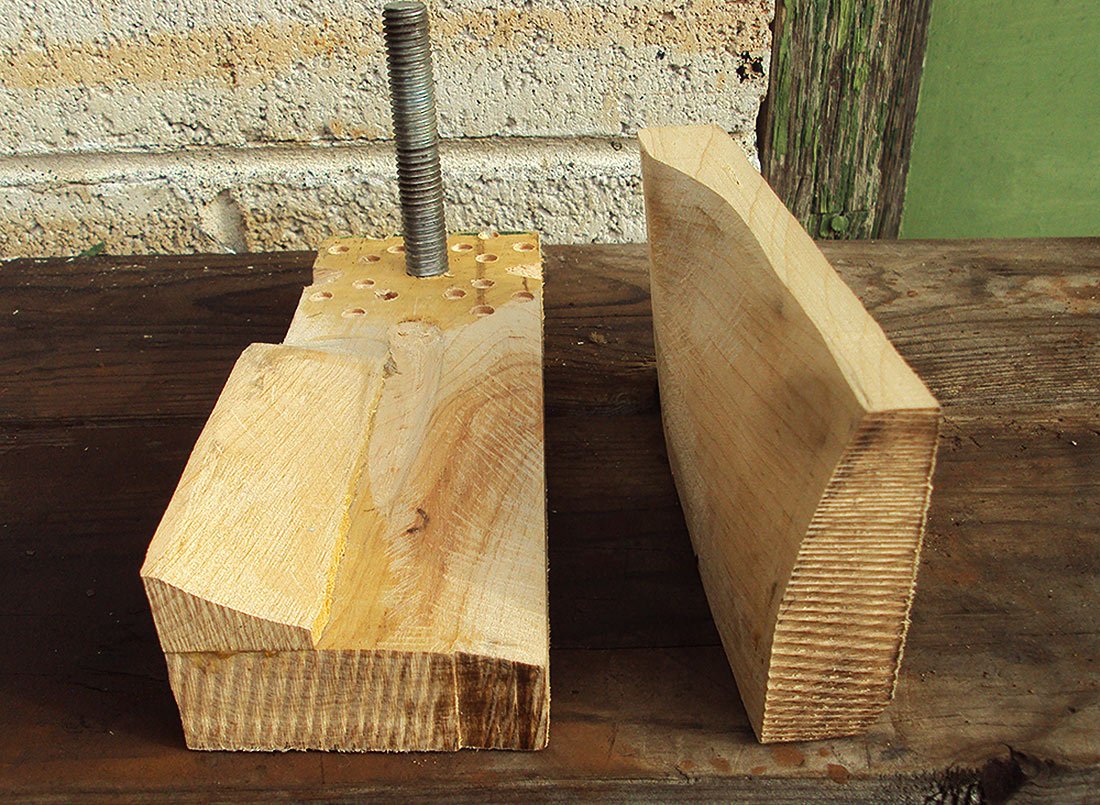

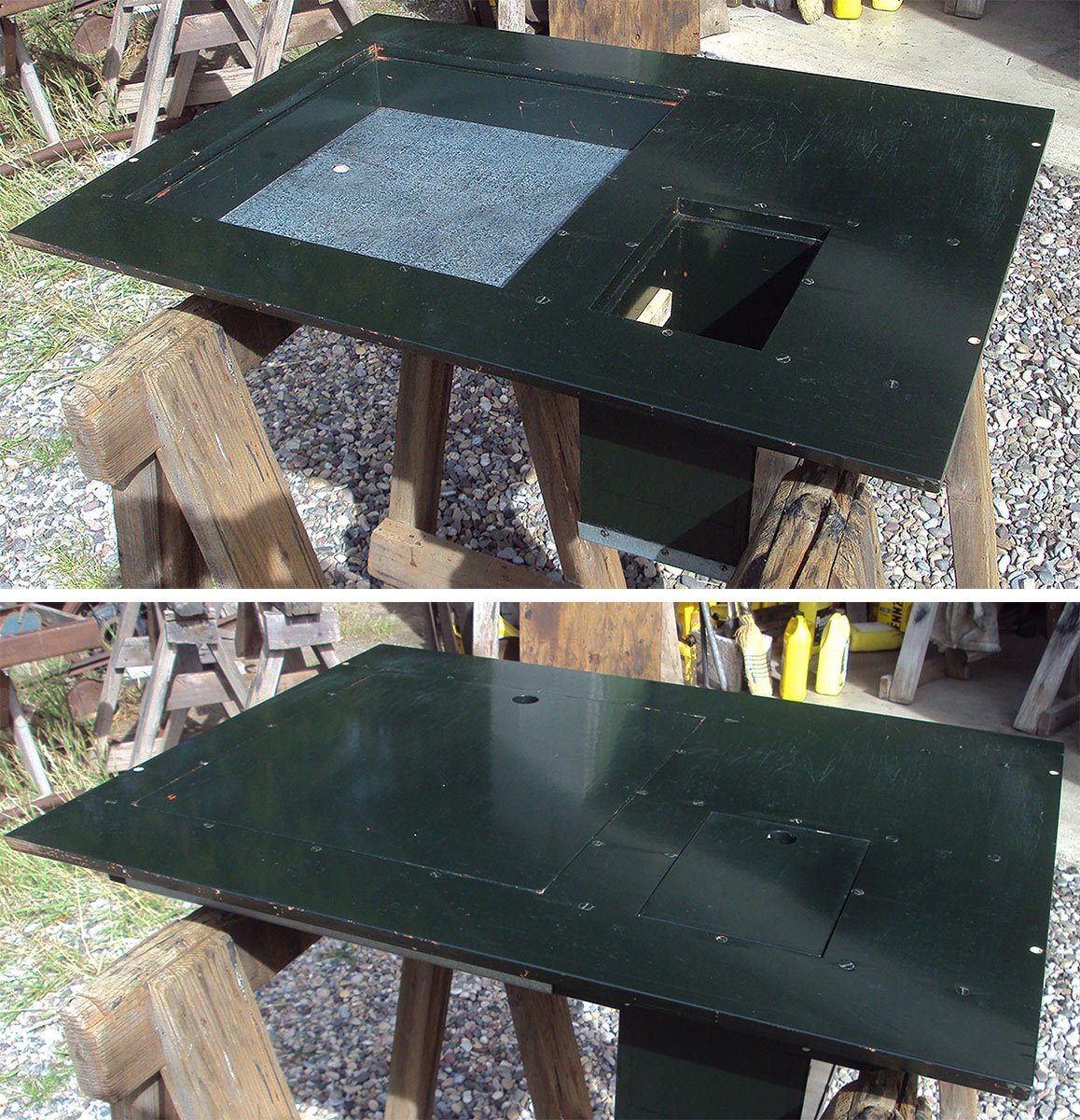

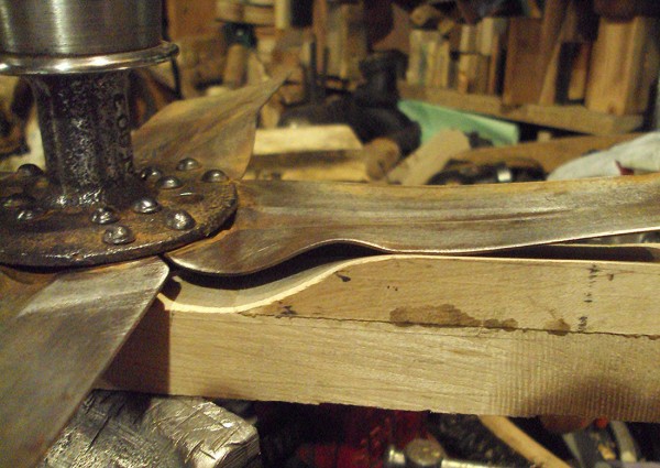

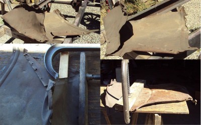

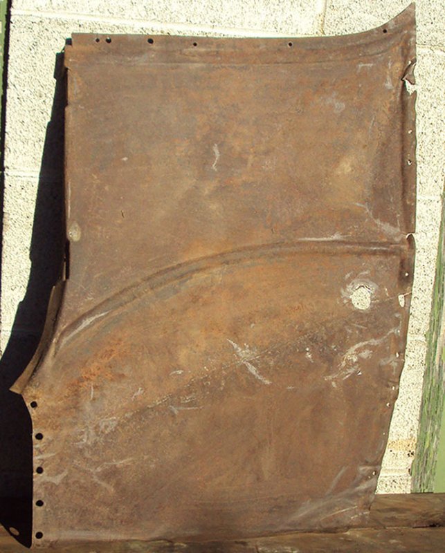

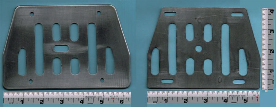

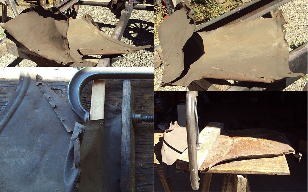

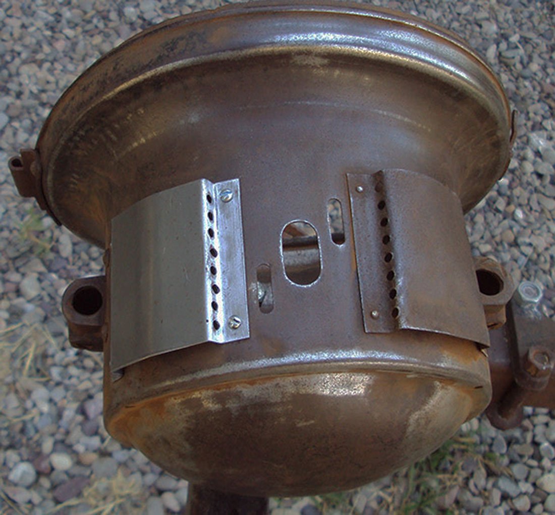

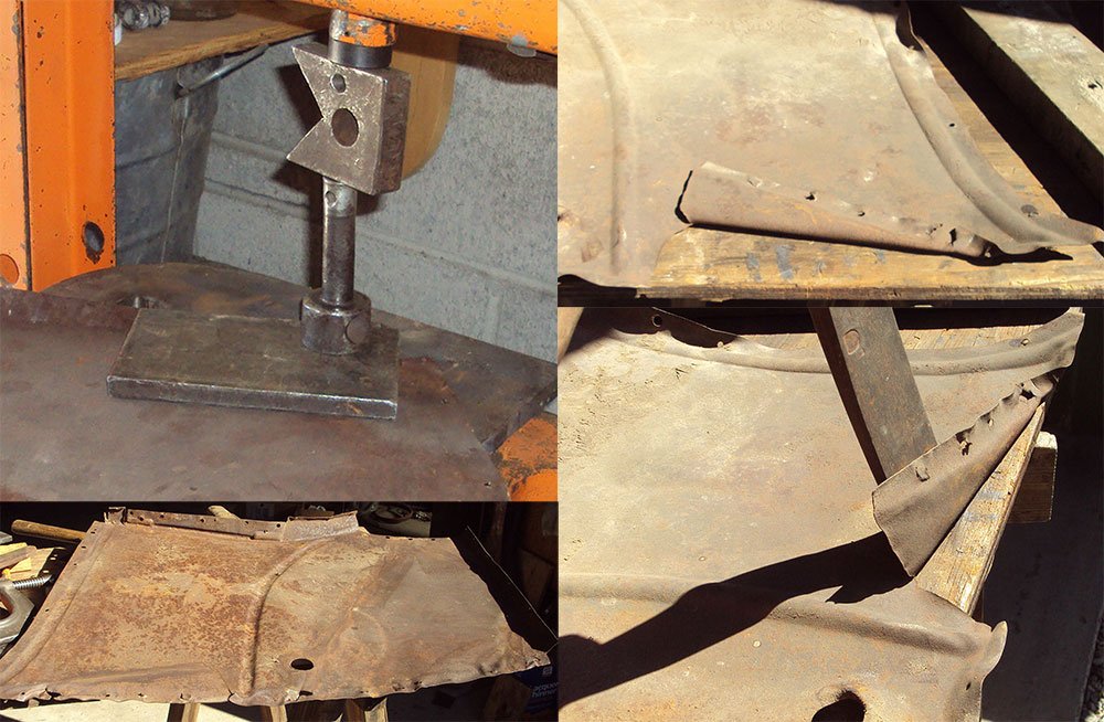

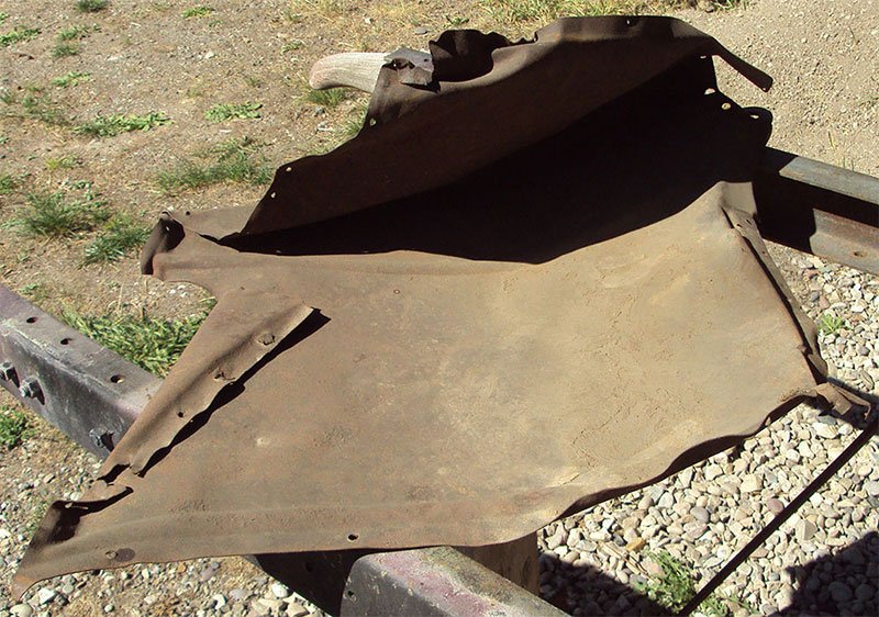

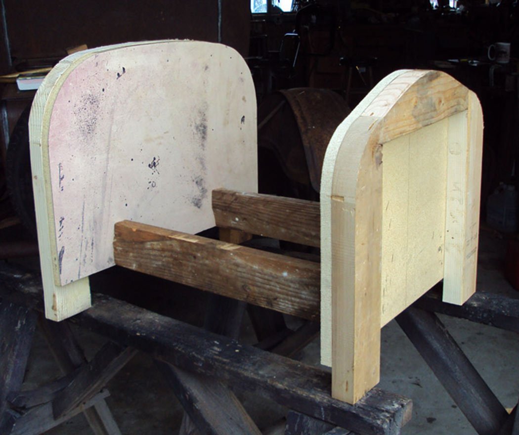

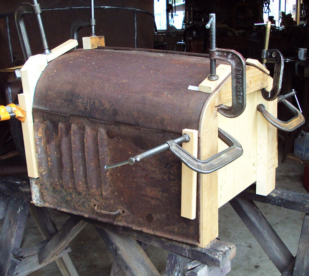

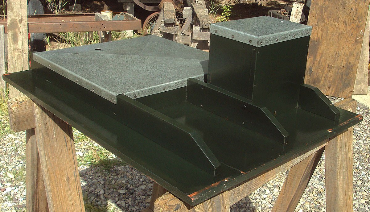

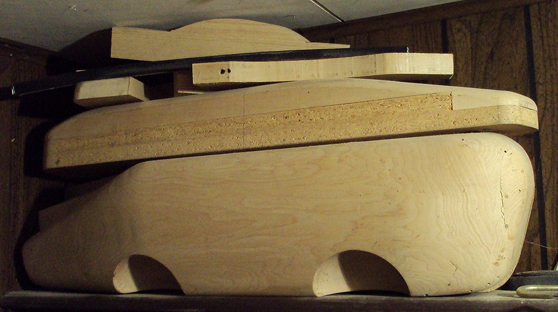

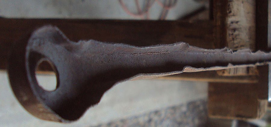

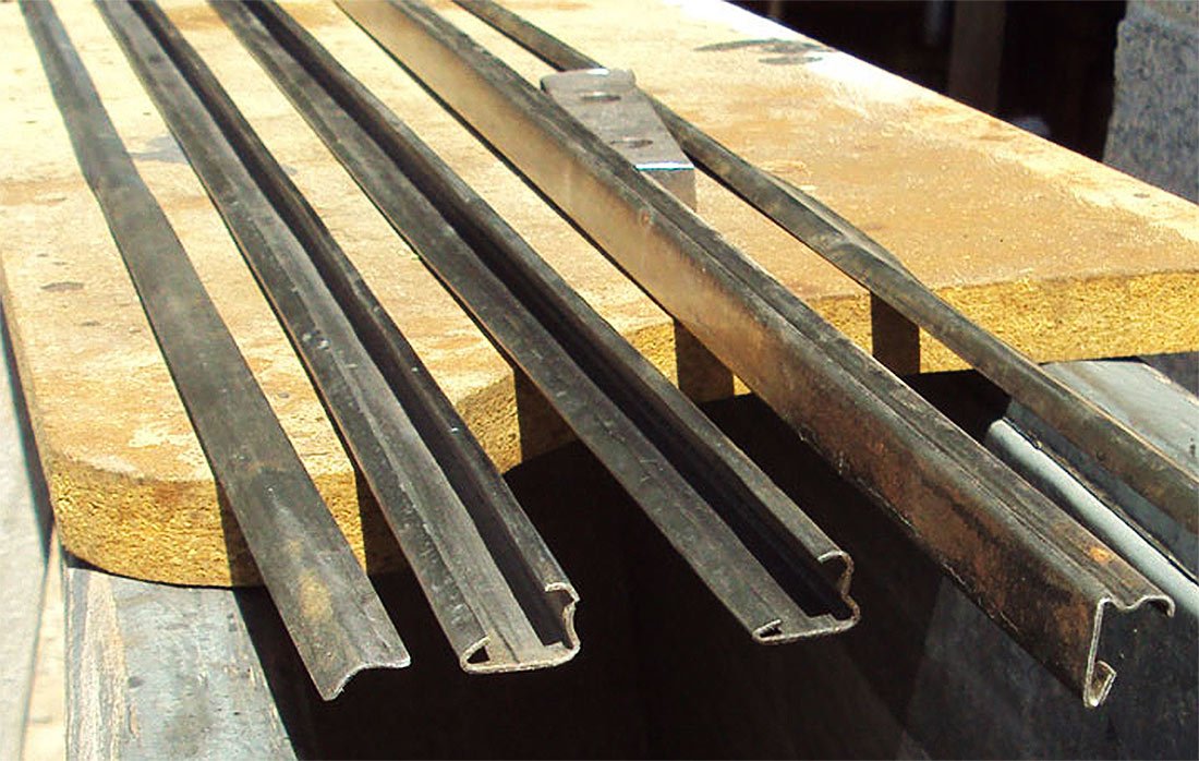

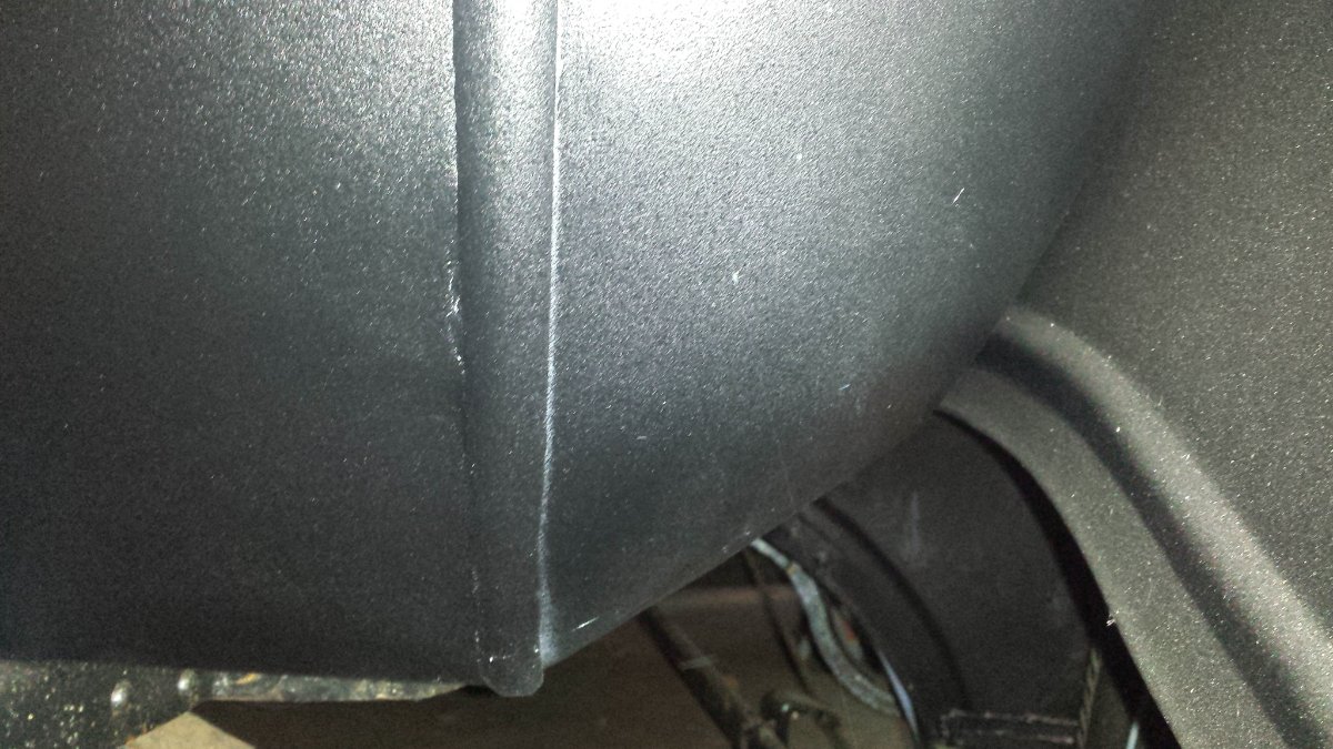

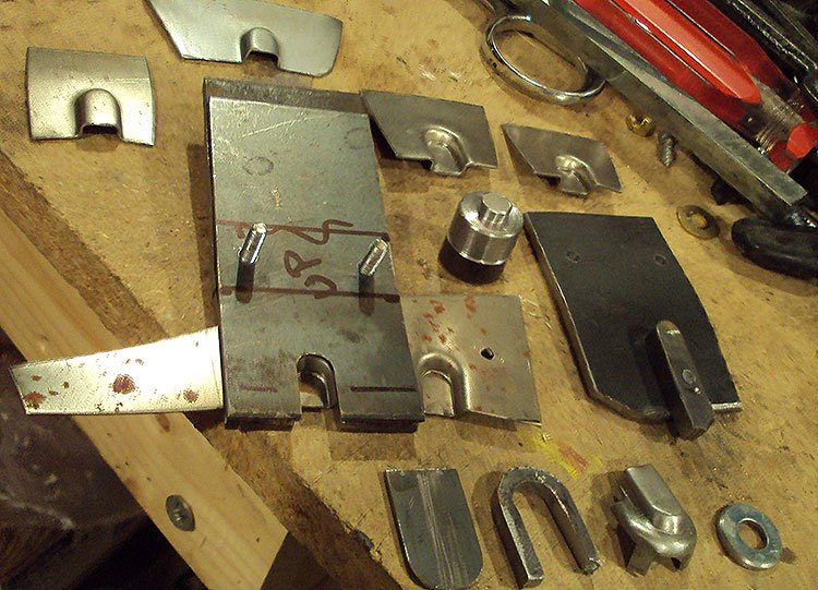

Straightening panels seemed to elude me so I started building a few new ones. The more I did the better results I had. Getting the feel of working the metal helped me learn enough to tackle things I couldn’t do earlier.
I wanted to try to save this quarter panel for my ’14 Touring as it was the only one with the correct fender bead. It was so bad I had nothing to lose. Reversing a wrinkle without stretching the metal any further is the key. Using simple tools I used in fabrication I could persuade the metal nearly straight again. Clamping large areas with lumber and pressing steel flat are shown here. Further smoothing and flattening might return this to show quality by someone with more time and expertise. As this car was not to be given a glossy finish the work done was good enough for now.

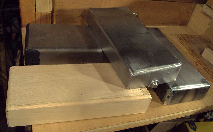

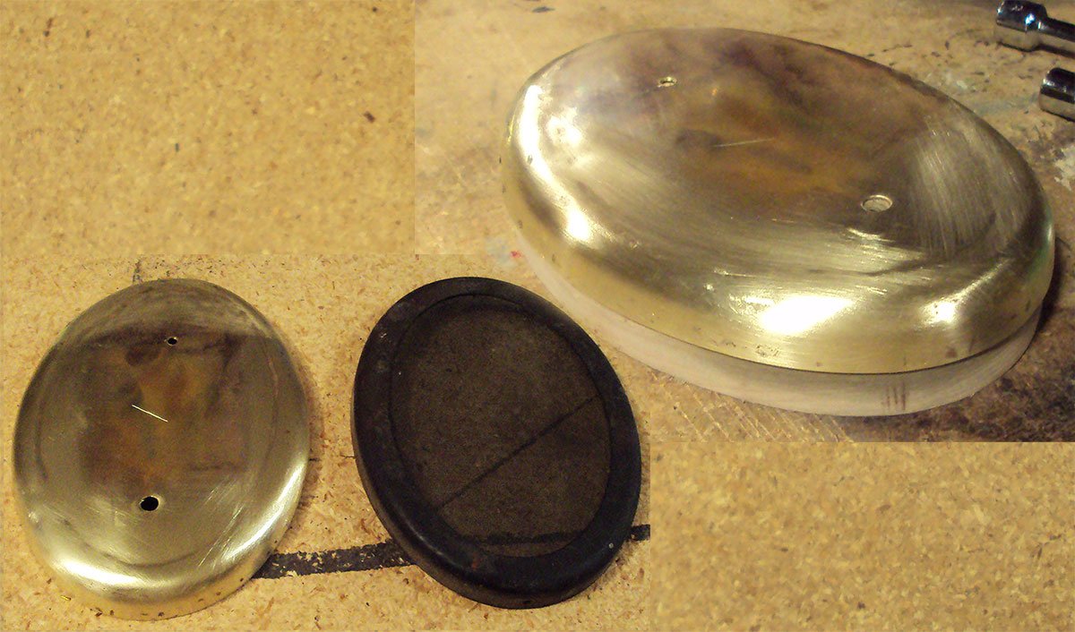

I found a '14 coil box but the lids were hard to find or expensive. It took 3 tries to make one that fit. The latch tops were lots of fun and pretty satisfying.

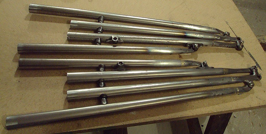

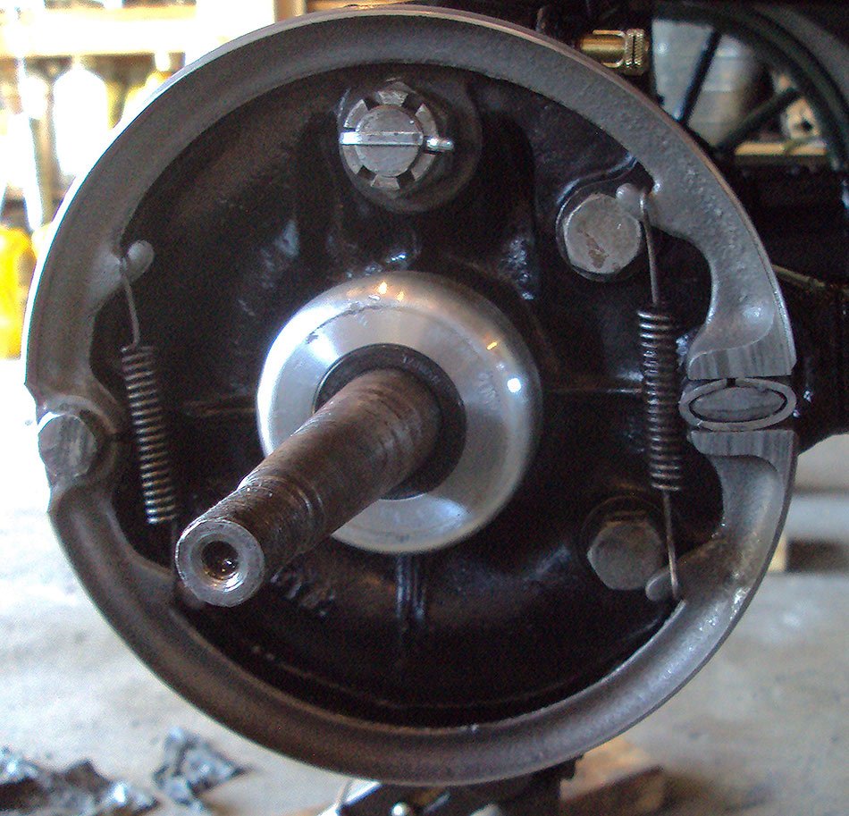

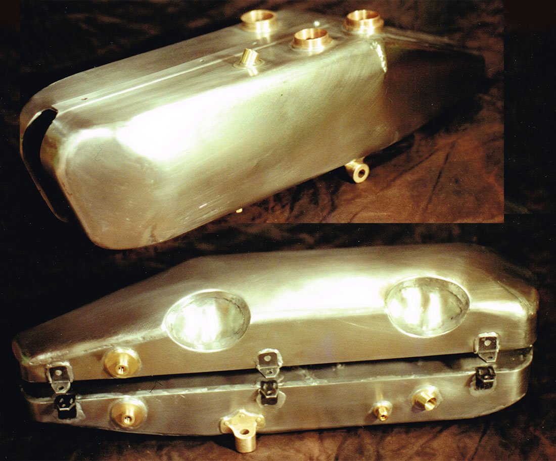

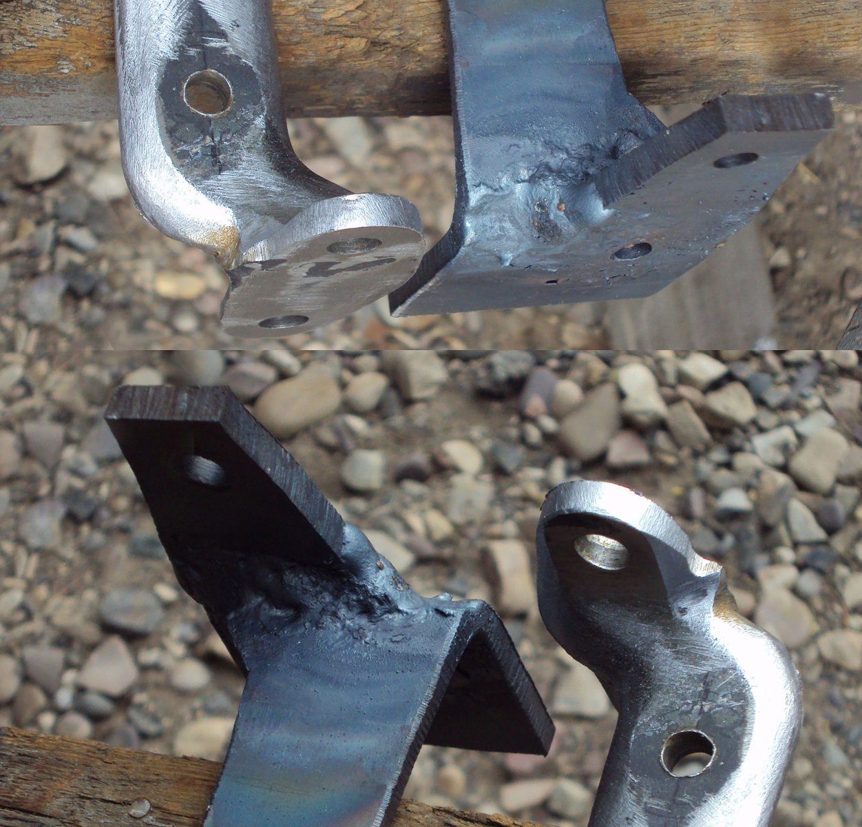

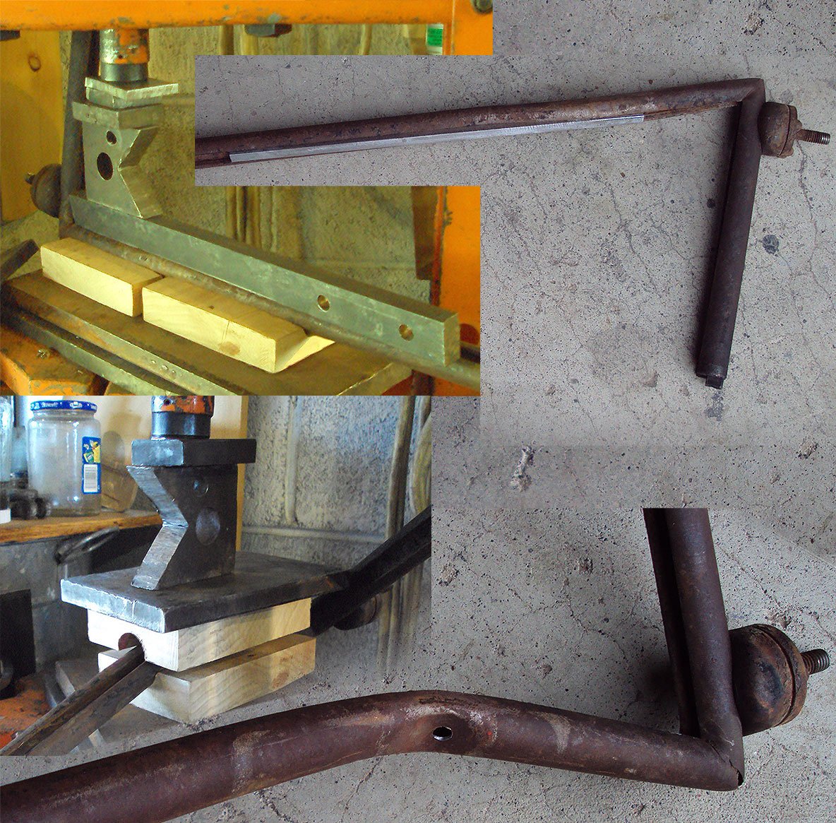

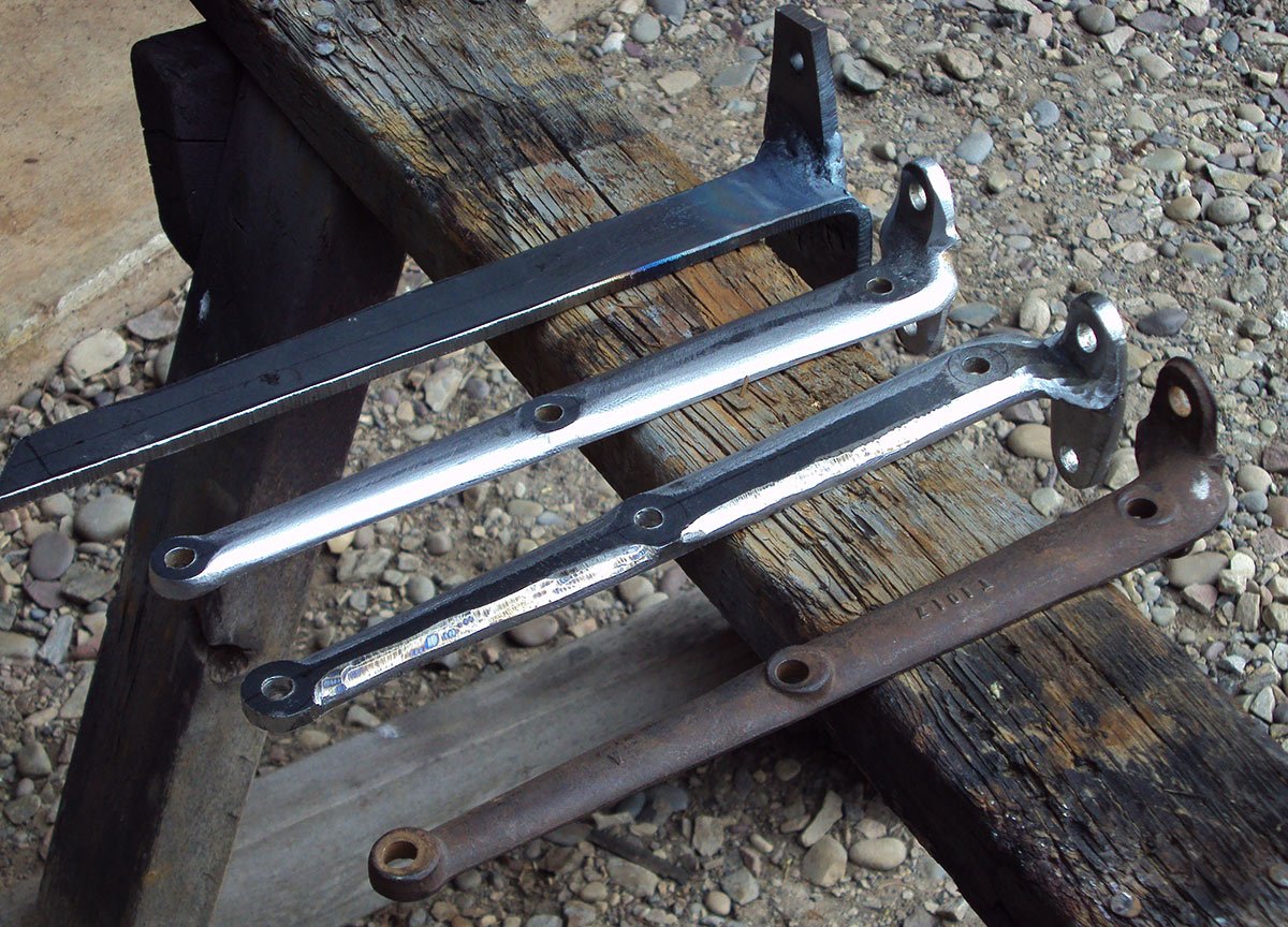

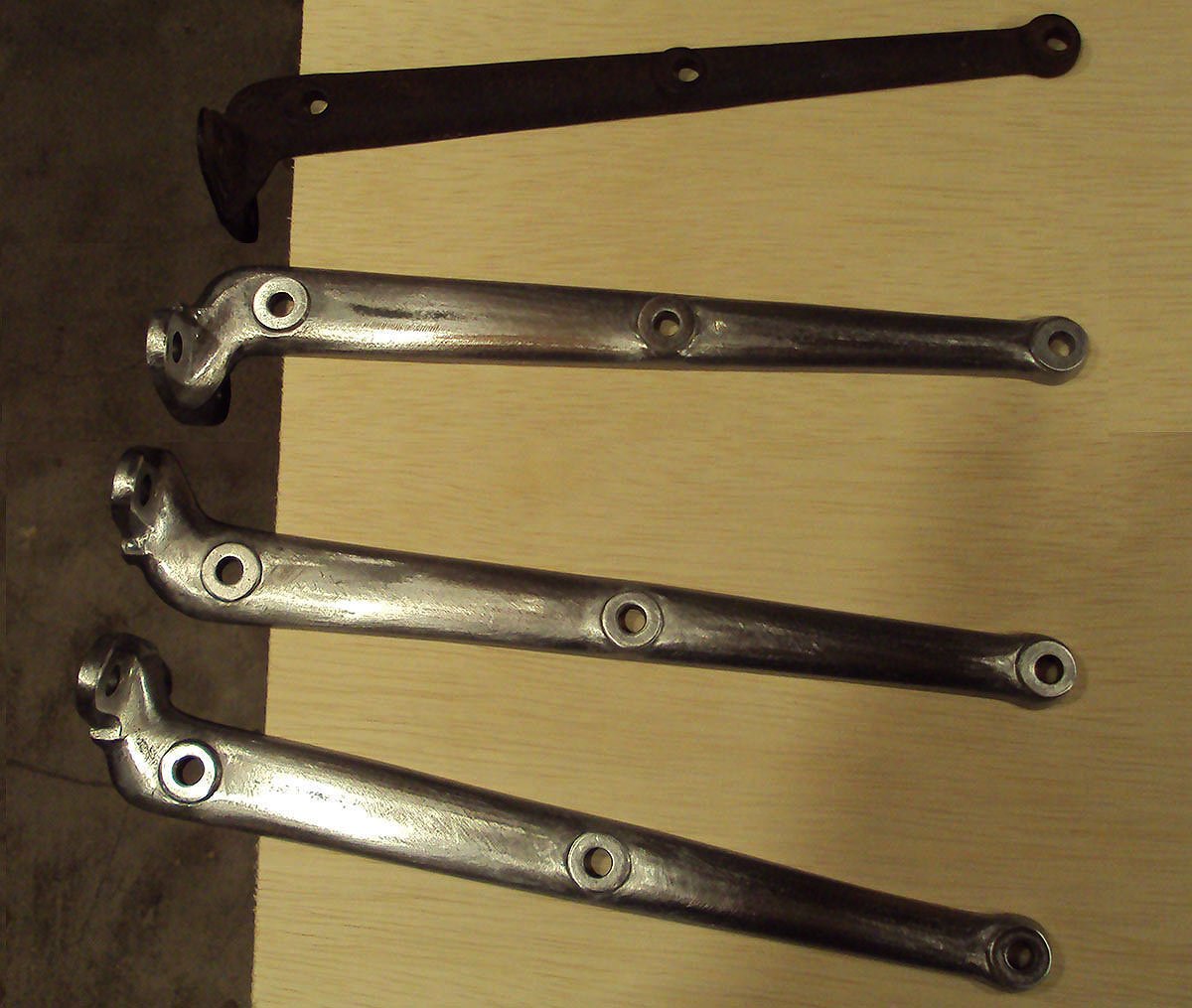

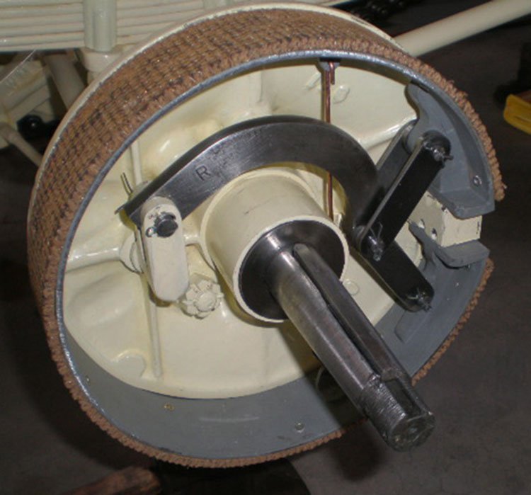

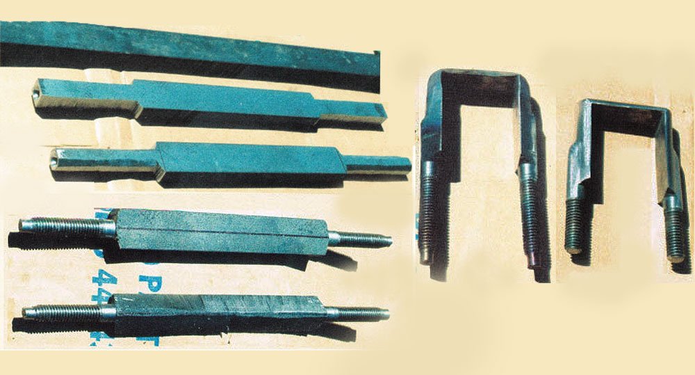

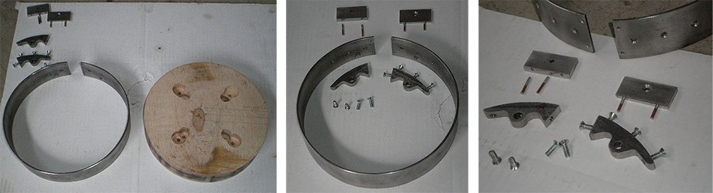

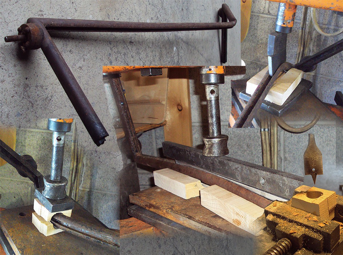

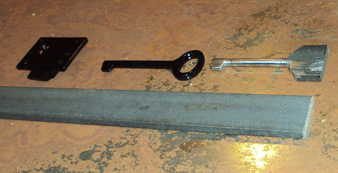

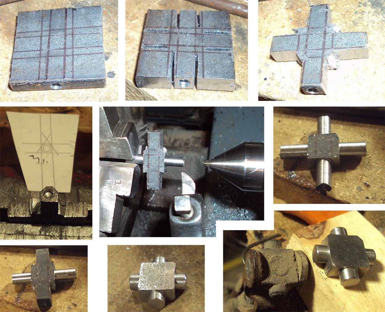

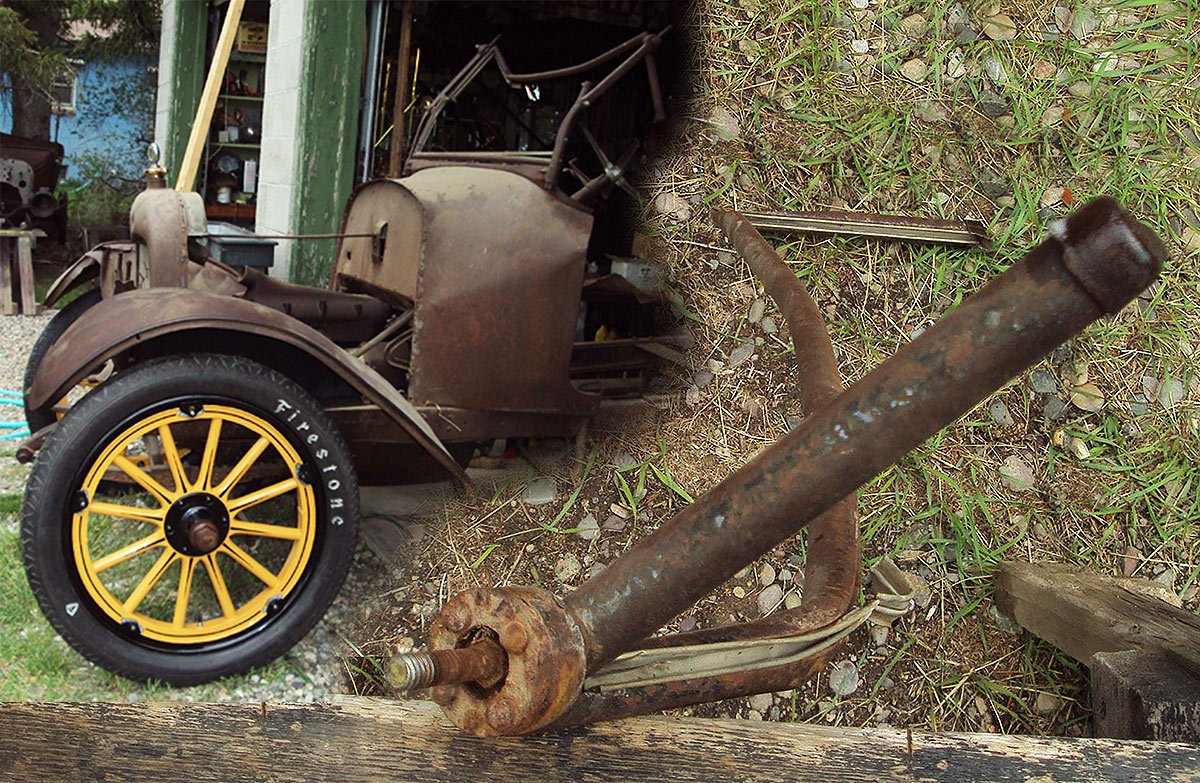

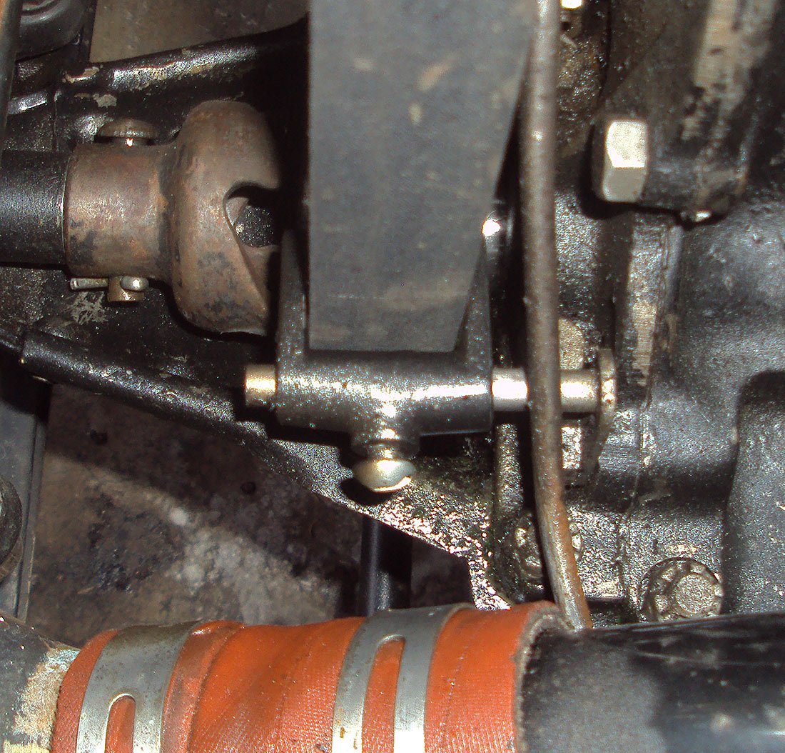

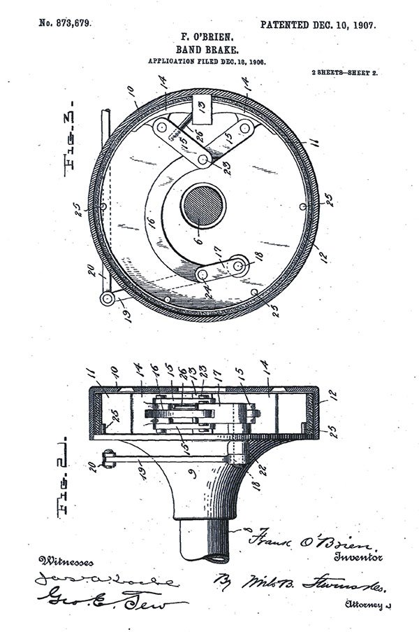

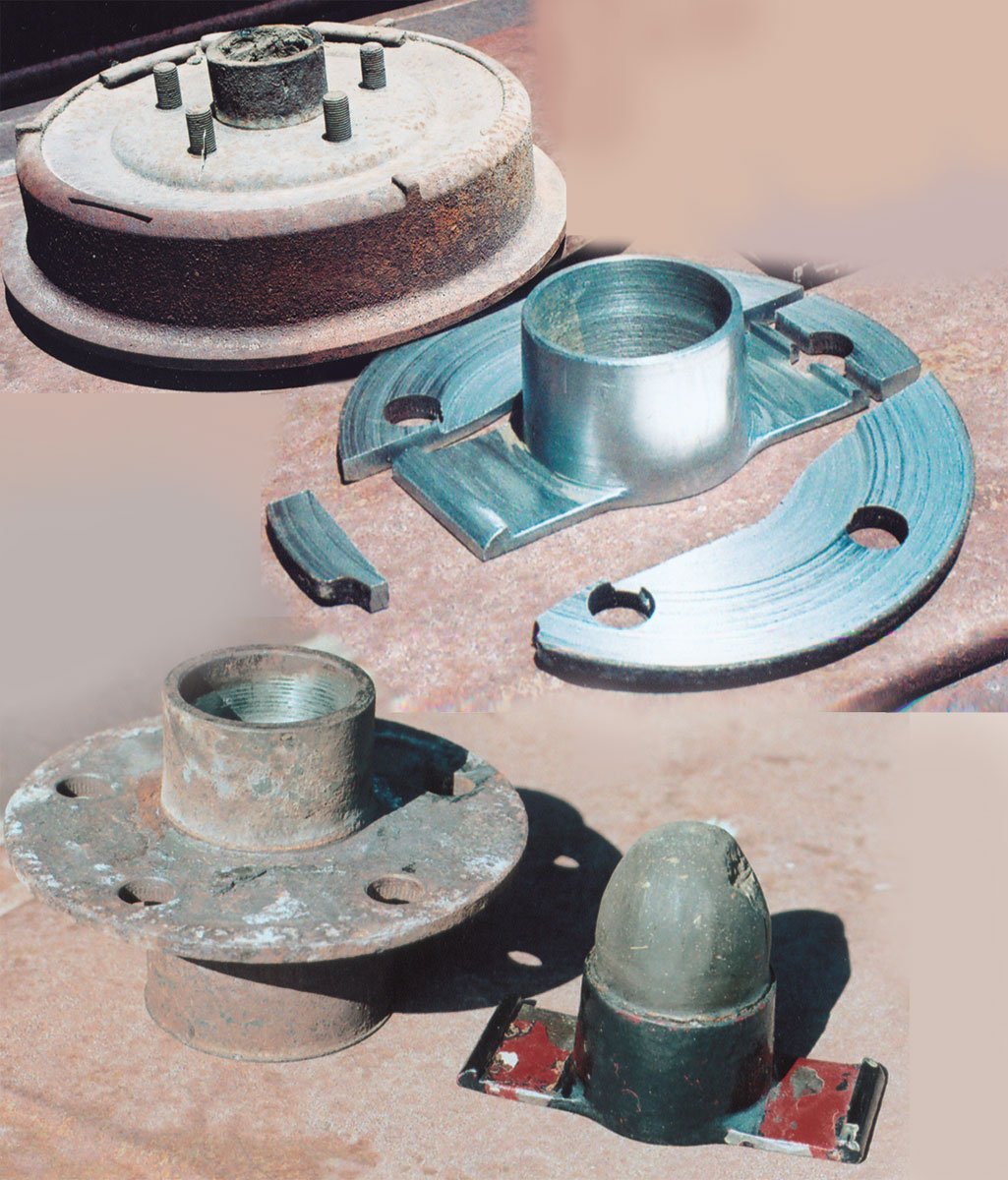

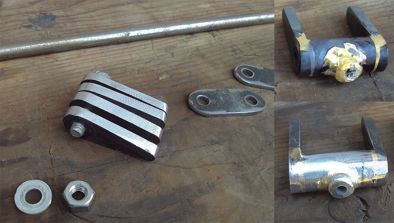

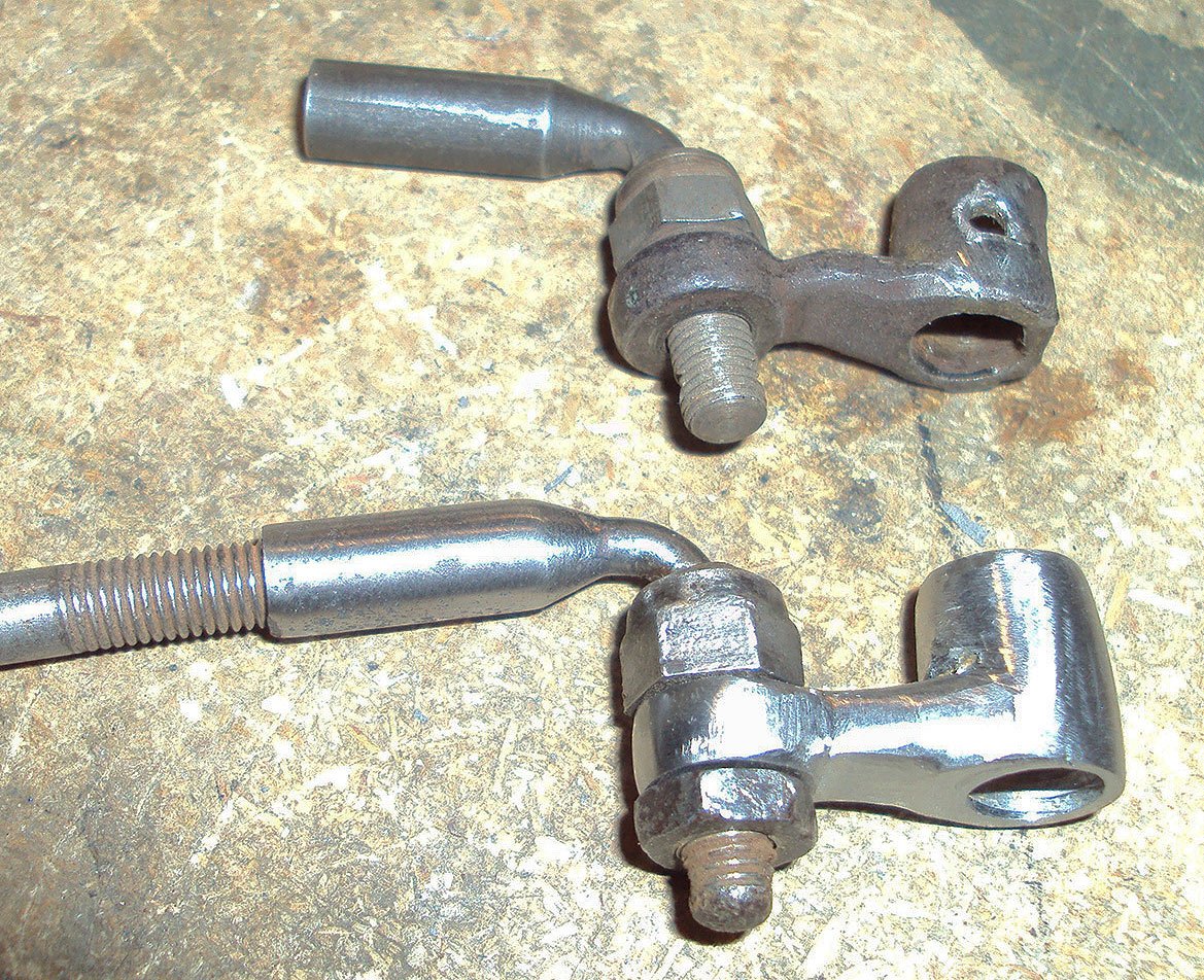

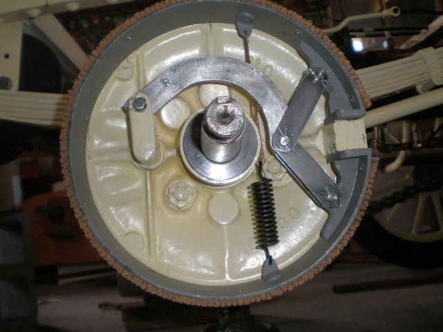

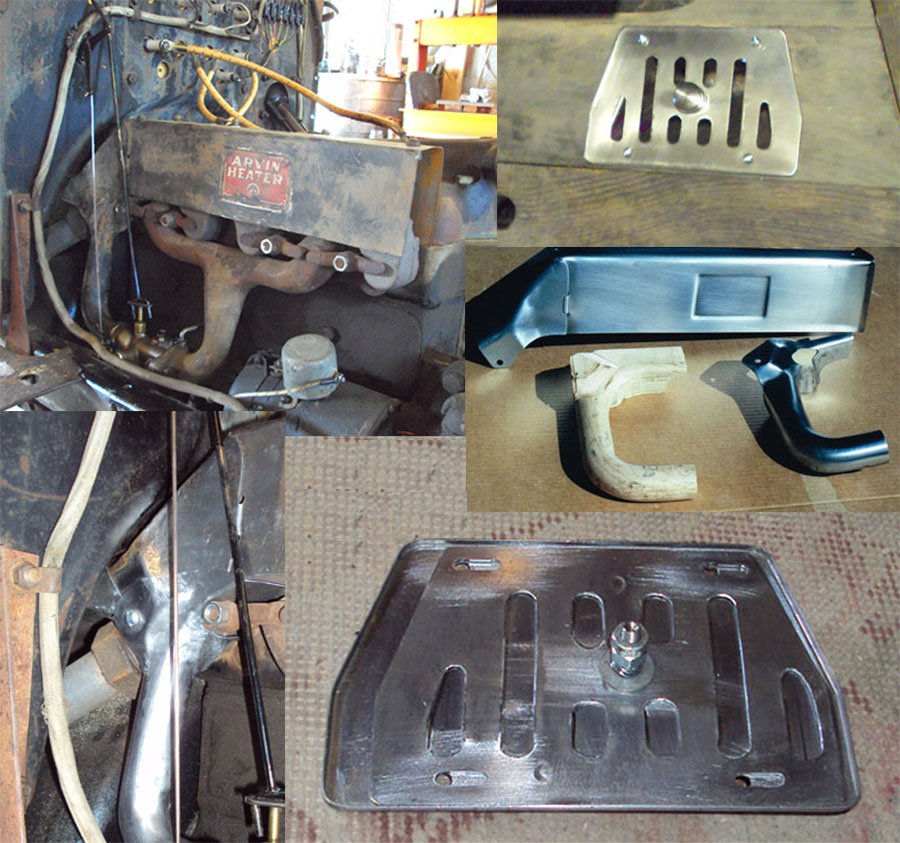

While this isn't a Model T unit the techniques could be used on anything. The rear axle brakes on my 1907 Buick were cobbled together such that they were dangerous. I tried to improve the mechanical advantage but couldn't improve the makeshift parts. I happened upon some Buick patent drawings for a different model but thought it might work. Scaling the drawing to my drum size I could trace out the parts and cut them from steel. The band is just cold rolled bar shaped around a maple block. Screws and pins are riveted and hold it together. Welding might work better but I rivet better than I weld. These work as well as a 26-27 T hand brake now. The Buick planetary had no brake. Just reverse and low drums so I need the rear brake.

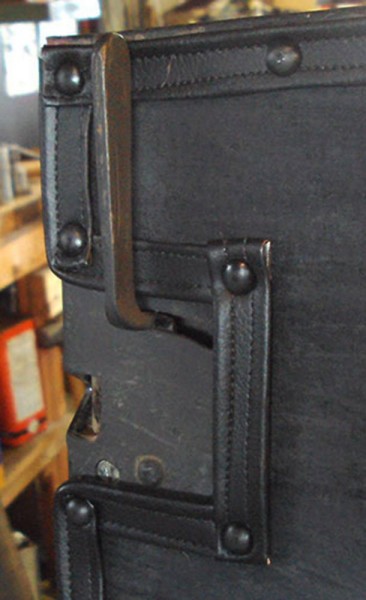

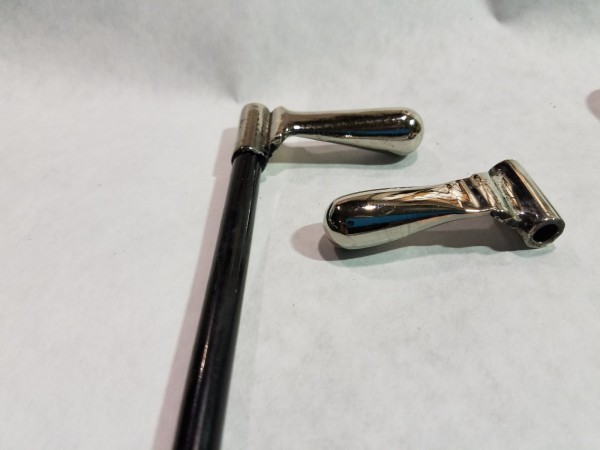

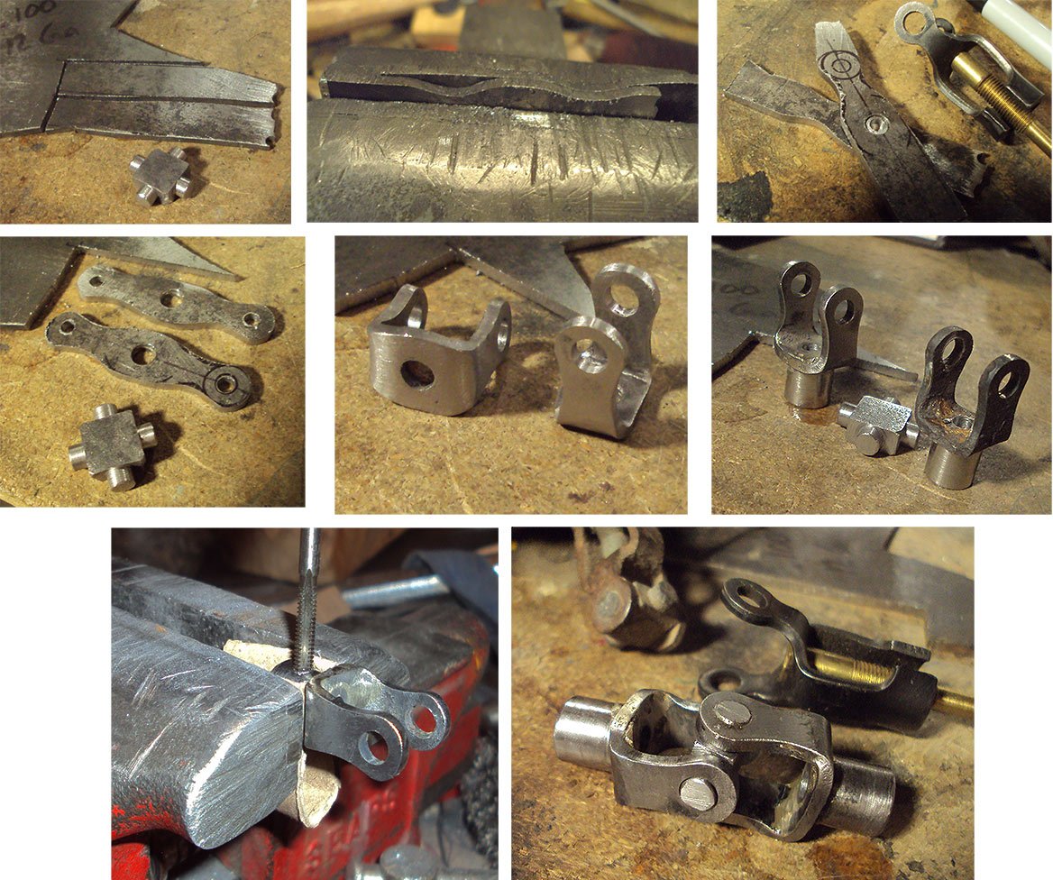

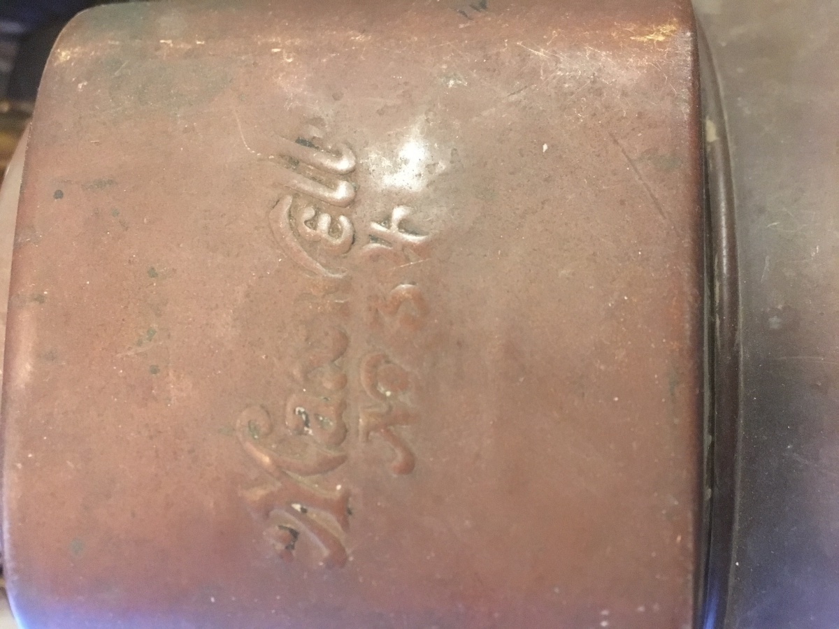

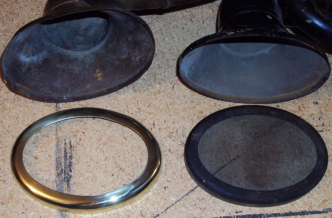

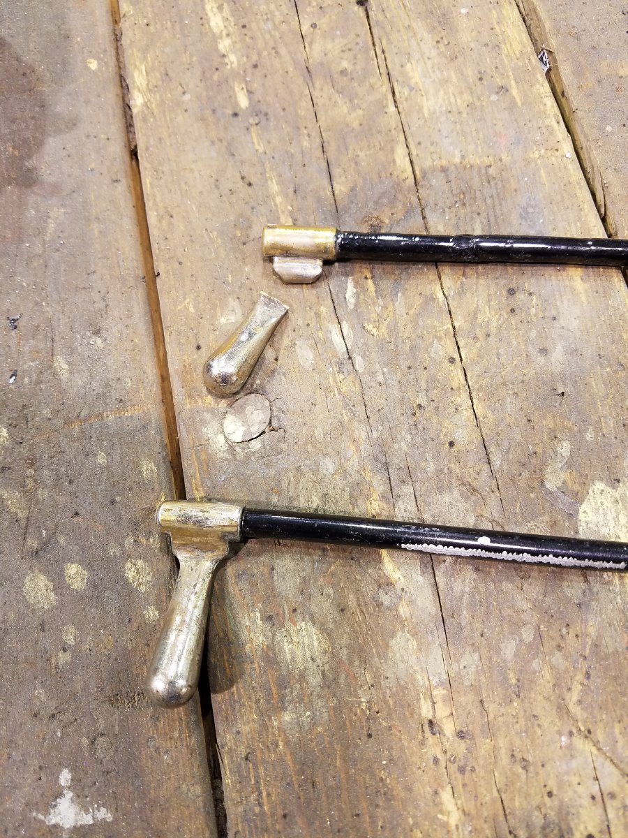

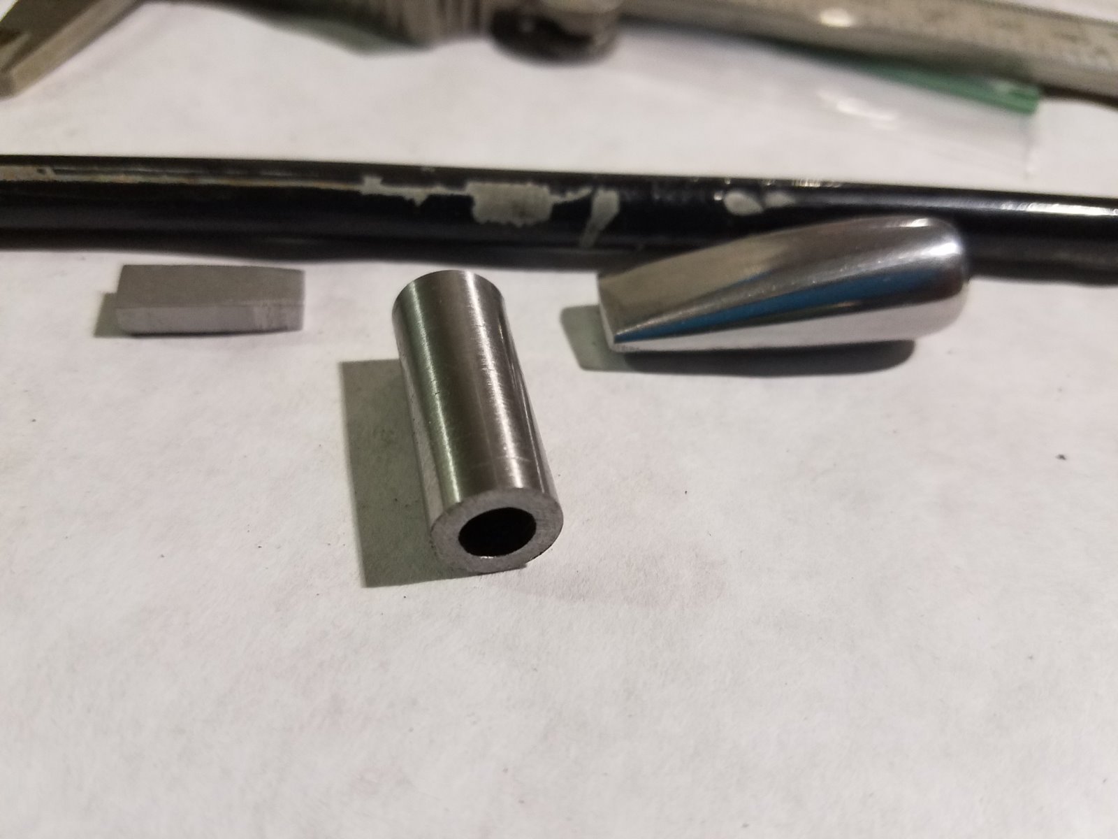

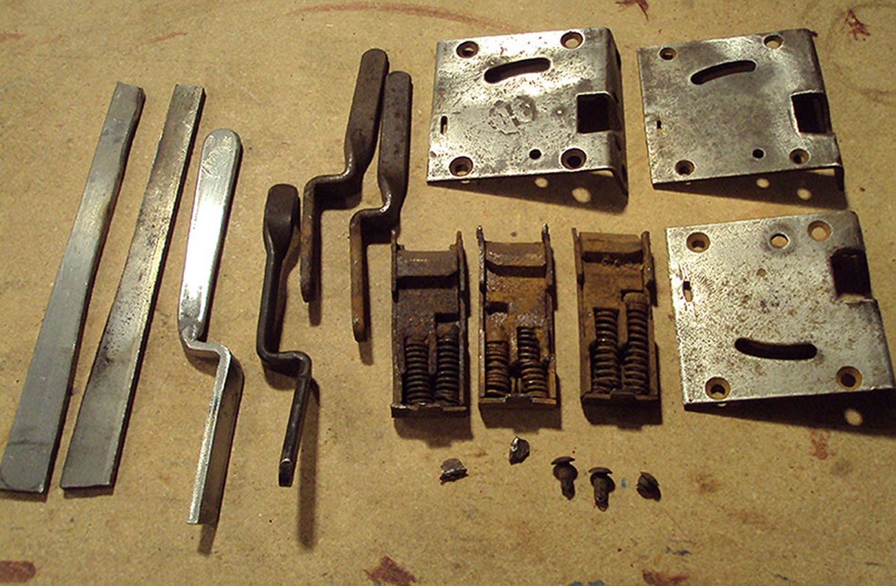

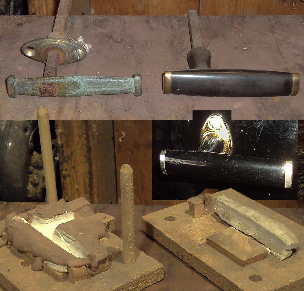

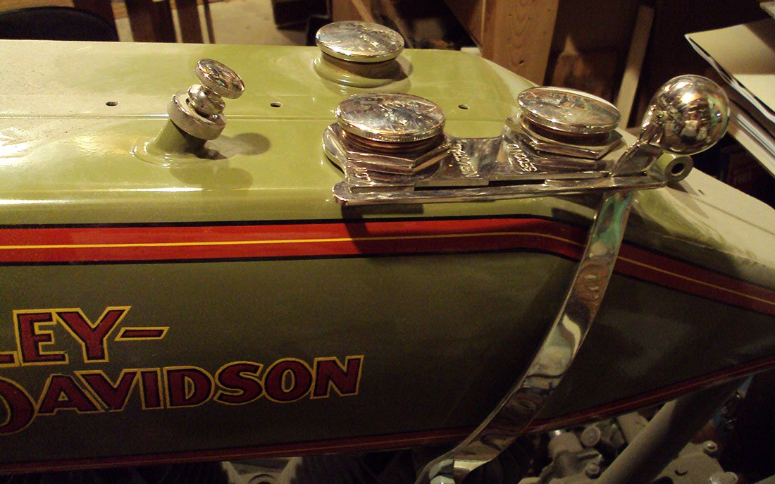

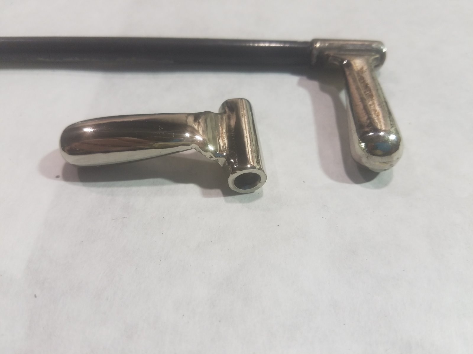

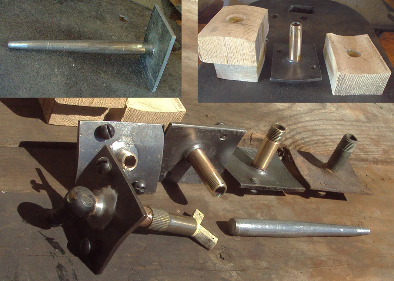

I broke what I call the regulator handle on the side window on my 1925 coupe. Looked for several years, and seemed I would never find one. One day, I decided I would make one. Took three pieces, welded them up, and nickel plated it. I thought it turned out pretty good.
Duey_C
- Posts: 1558
- First Name: Duane
- Last Name: Cooley
- Location: central MN
Holy cats Mike! That regulator look a lot like the ones for a late Center-Door project I had been waiting for and wait to do.
Rich, this is much fun and inspiration for me right now. As always.
Thank you.
In the past, I was close. But I waited a week for the idea to unfold in my head for the clutch arrangement on a Twin Y (Maytag) toy tractor for the kids and me I was working with.
I had the lever (discarded lever for something and a vee belt), and some other bits. A week later. Got it!!!

Beautiful work Mike. Thanks for posting it. I have found when you make things like this that you can't find they show up at the next swap meet.
I really enjoyed seeing this.

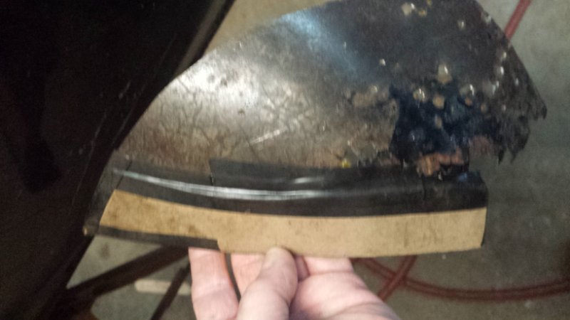

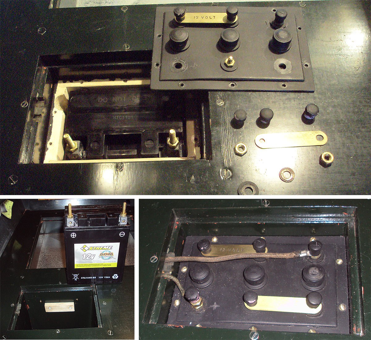

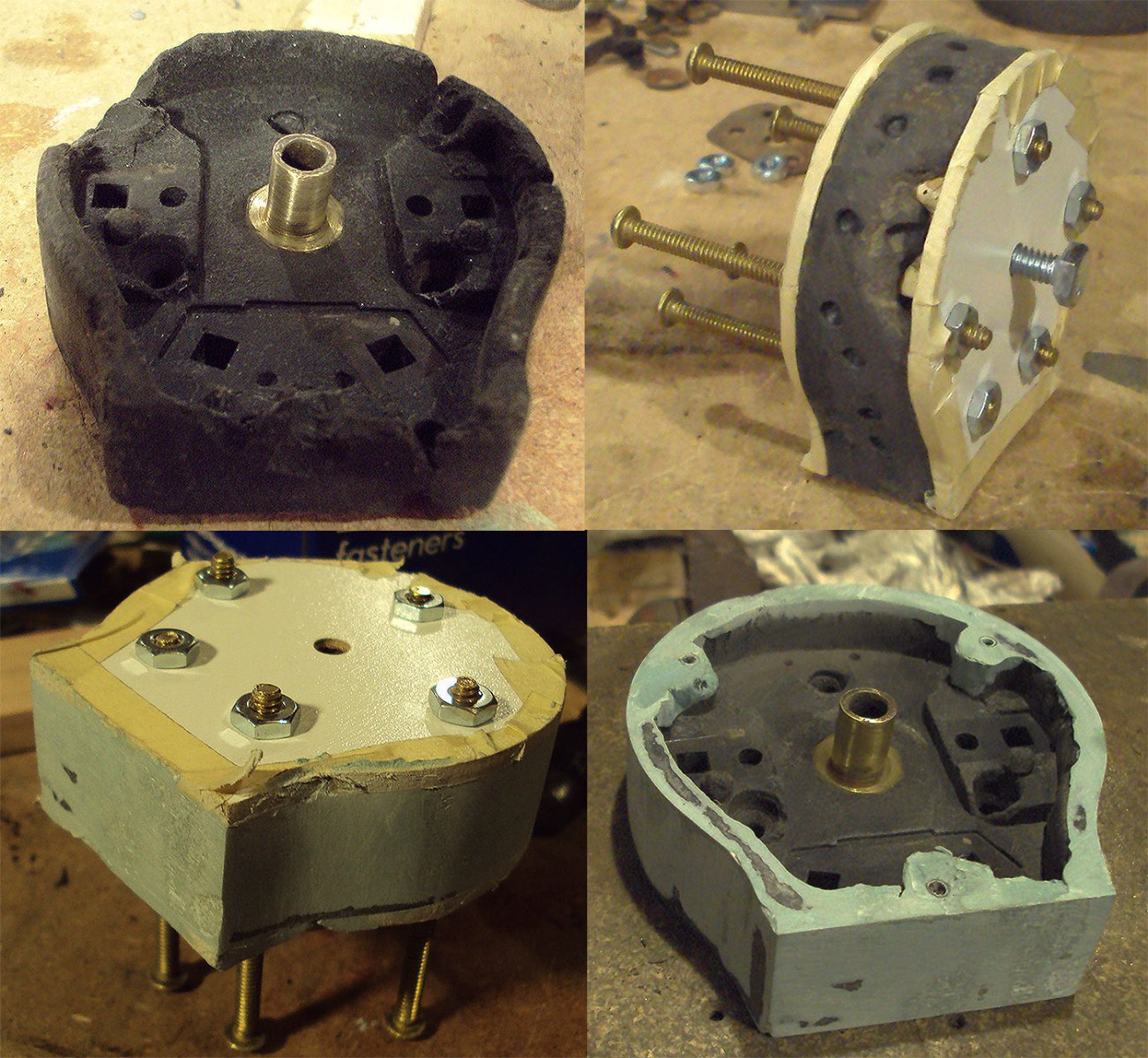

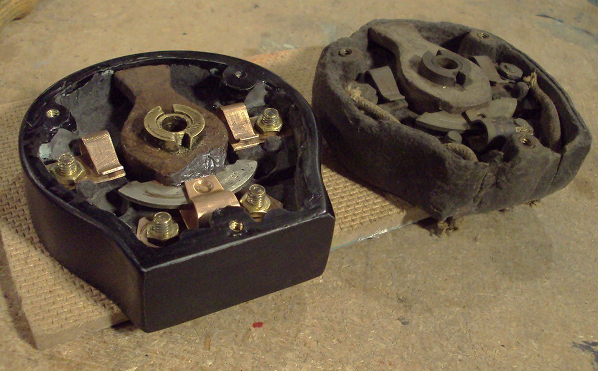

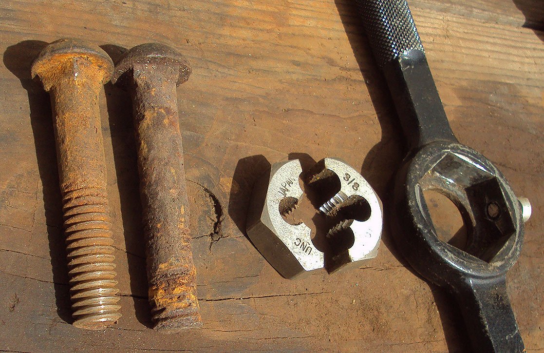

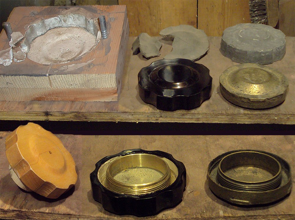

Bakelite parts can be difficult to repair. I have tried a few casting resins but they seem to dry up in their container between projects. I have found that Bondo casts well and holds up fine for me. I used it on my 1925 Tudor door handles (1999) and a radiator cap for my 1923 White (mid 80s). I make wood fixtures and sculpty clay for the molds. The pattern for the cap is maple. The cap has withstood high temperatures and the only problem is a little wear on the corners. Both items were painted with enamel paint.

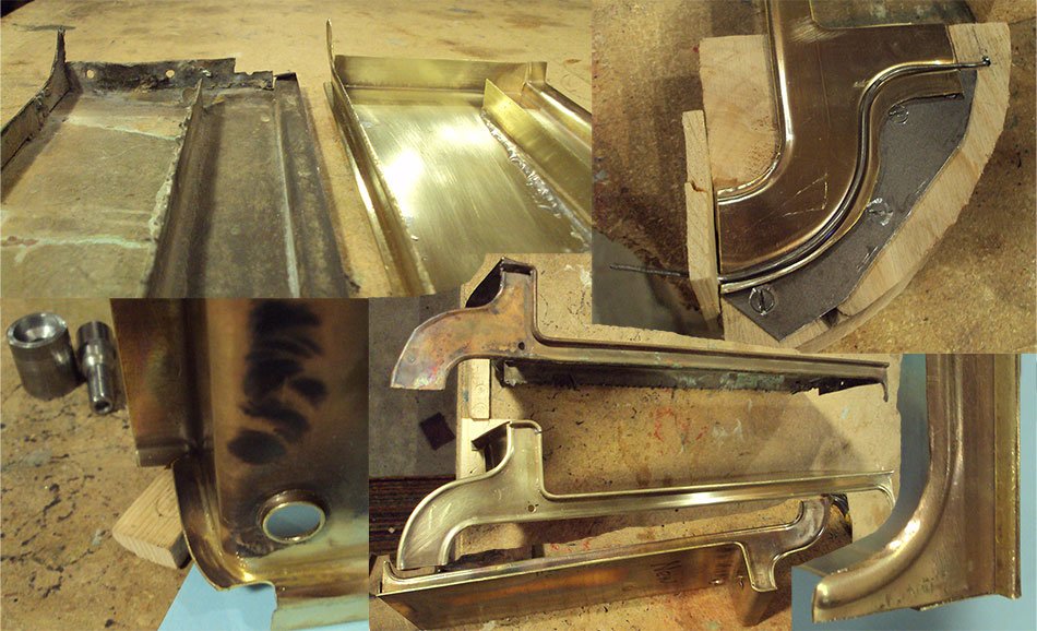

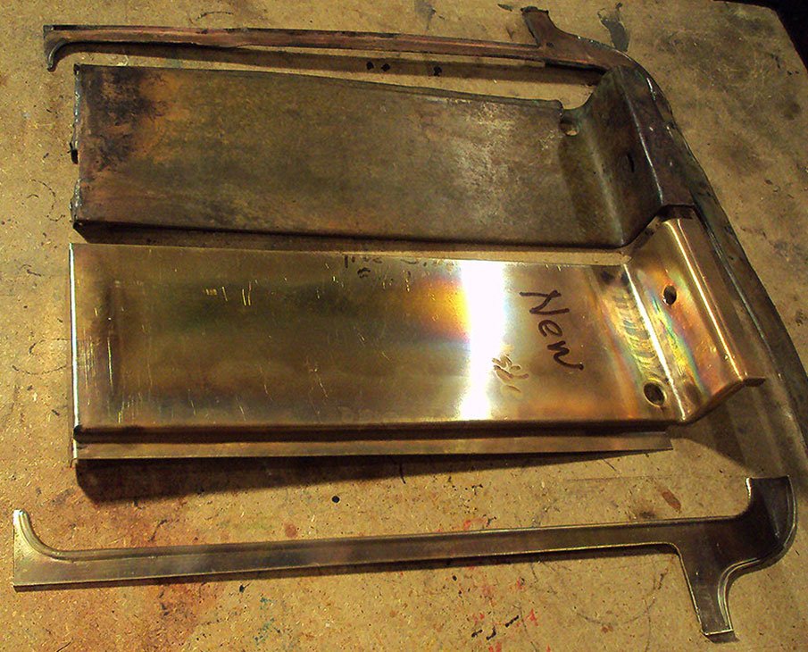

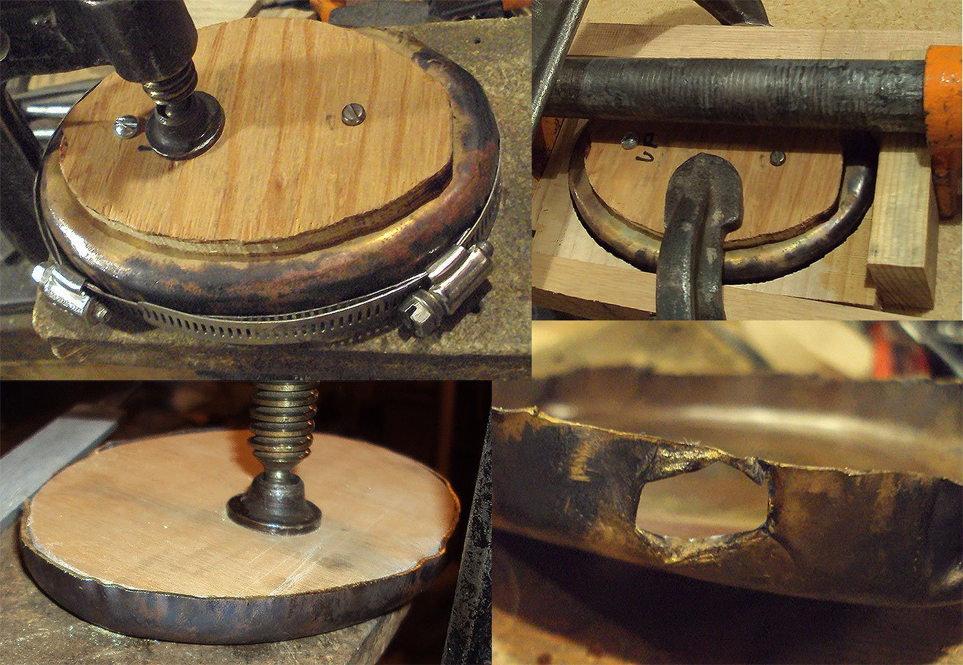

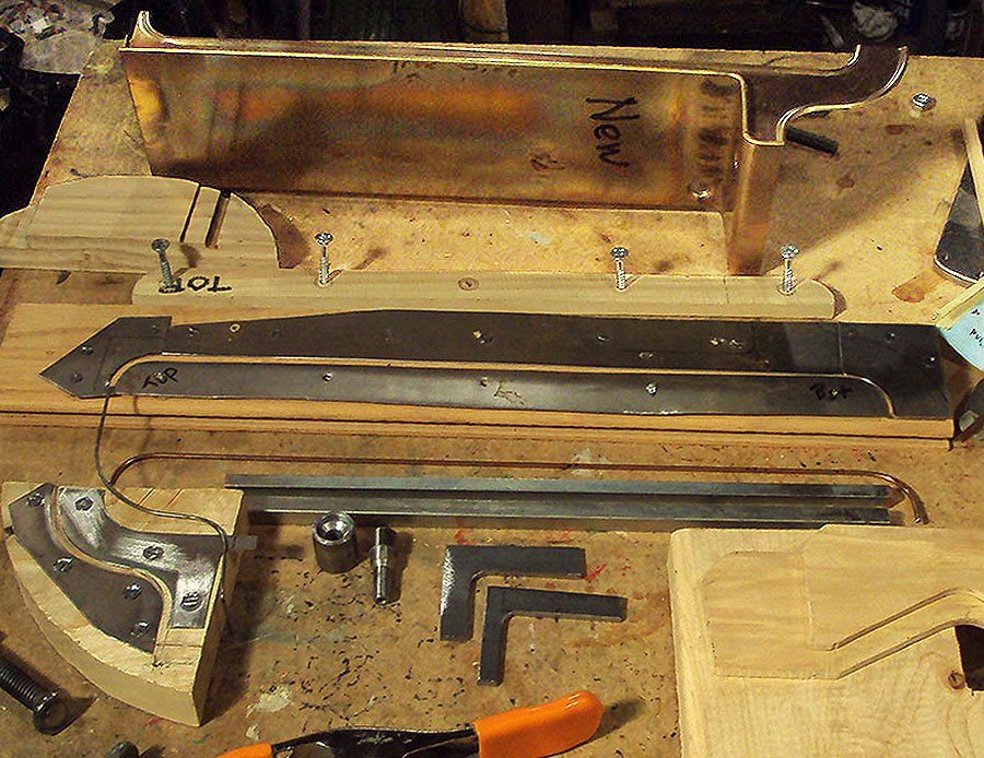

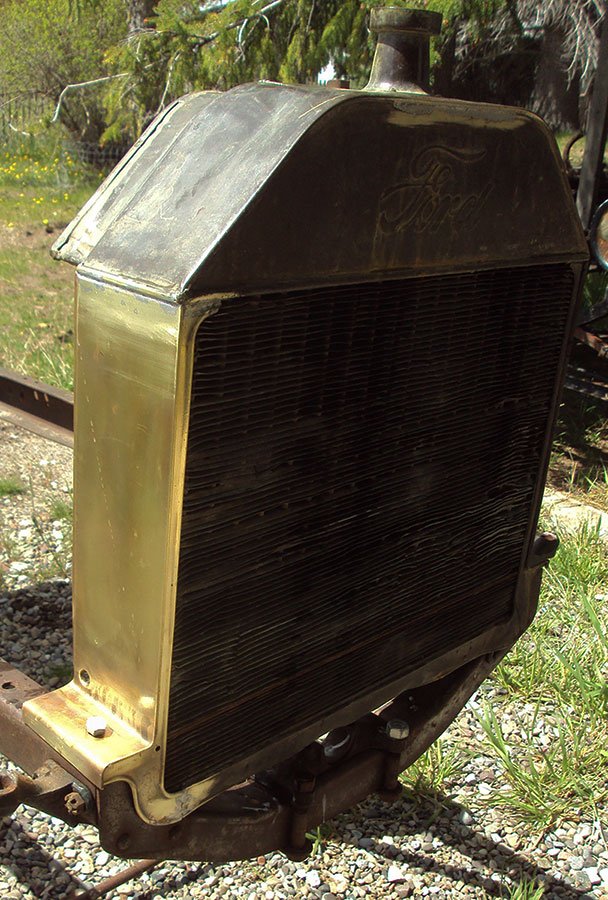

My brass radiator was missing a side. These are available but I had some sheet on hand and decided to make it. This shows some of the steps and tooling.

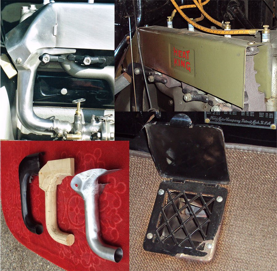

I have built heater shrouds and doors for my two closed cars with heater manifolds. I had a tattered old shroud to work from but had not seen many doors so I designed my own. In addition, new carburetor stove pipes had to be made.
These were for my 1922 Coupe. The grille is made out of 22 gauge and has a .100" lip around it. The slide door is 20 gauge The pictures were taken it may of 2013.
The below pieces were for my 1925 Tudor. These were made earlier. Perhaps 2002.
There are a few more details and discussion here:
http://www.mtfca.com/discus/messages/331880/386580.html

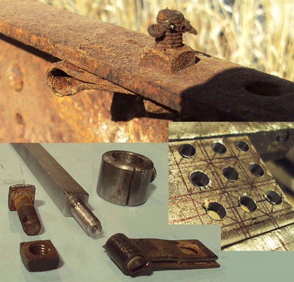

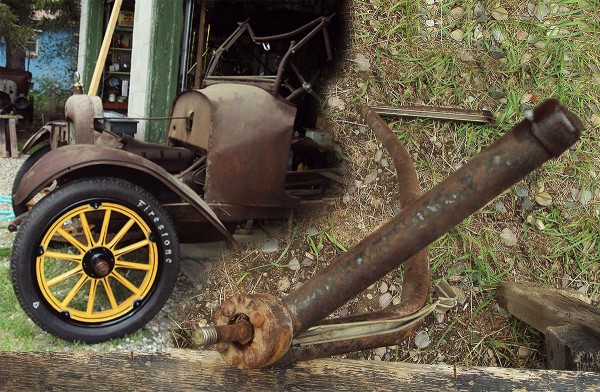

Yes there is John. The bumper and casting were missing from one side of my 1907 Buick rear axle assembly. The U-bolt ends had broken off with the nuts sometime in the last hundred years. They were long enough to assemble without the casting which didn't stay with the car. My plan was to make the bumper holder by welding something to a plate that would work. Sadly, no standard pipe or tubing was the right size. One day I glanced at a brake drum that came with some Model T parts. I discovered a bumper holder was hiding inside the hub. It was just a matter of machining everything away that didn't look like the holder. Dimensionally it is the same as the existing one.
The next step was to make new U-blots that were the right length. This was done by whittling some 1"x1/2" bar and threading the ends. Heating and bending (hammering) over some 1 7/8" stock finished them to specs.
Those happy discoveries make restoration fun and rewarding.
I suppose someday someone will need that hub but for now I am happy.

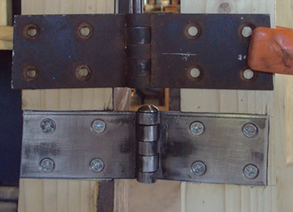

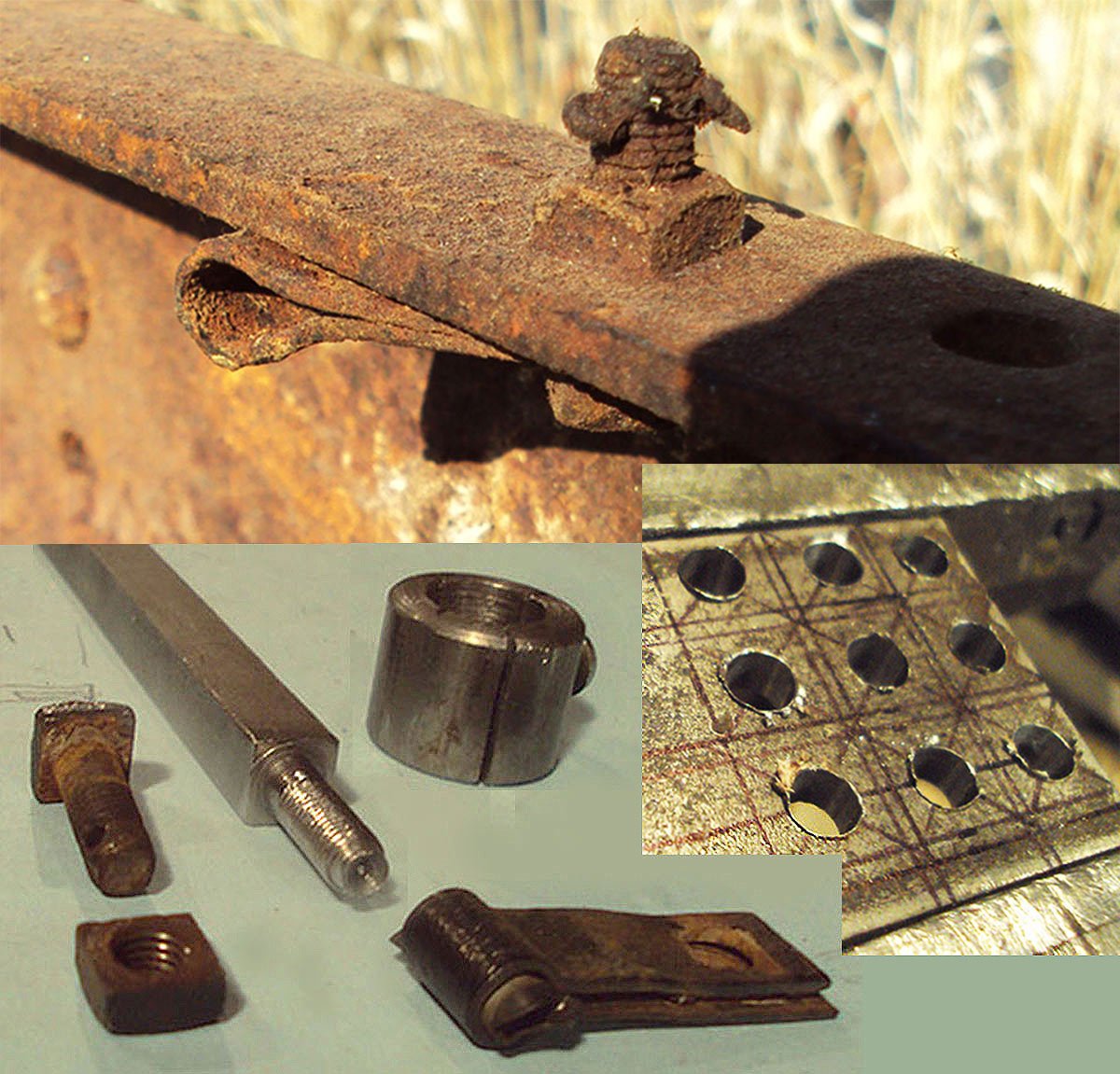

My 1922 Coupe project had only 2 of the 6 required door hinges. I made these from flatbar by notching and bending the ends around a pin. Some careful filing made them fit like new. I don't remember exactly how I used the jig at right but it helped bend the ends. (2013) Forgive the Philips head screws. I despise them also but use them to fit things before installing the "good screws". I did anneal the ends after bending. I have made other hinges without that have worked fine.
I also would have taken better photographs if I'd know I was going to show them.
My 1919 Harley Davidson has given me opportunities to learn some new skills. The gas and oil tanks were rusted out but I could see how they were constructed. The sides and pockets for the intake rocker arms were soldered in place. There were baffles and a divider in one tank that separated gas from oil were visible through the rust out. I made some maple forms to bend some sheet metal on. The filler necks were bronze and turned from bearing stock. The caps, nuts, shifter gate and shifter lever were made of steel and nickle plated. Since I knew the distance between necks I could enlarge a catalog cut of the shifter gate and trace it onto steel plate. The little pump in the tank sends extra oil to the crankcase when needed. Everything in the pictures was hand made except the frame the tanks are mounted on. Although I let car projects take over my time the Harley has increased in value more than the Ts since I bought it for $75 in 1973.

After several tries I made this 3 foot 2 x 4 from a 6 foot 2 x 4 !
That is exactly where I started. Good work and keep it up.

I make my hinges much the same way.
And that tank is nice.
The battered horn for my '14 needed a door for the screen at the front of it. I have one with my better horn for another car I used as a pattern. Forming .025 thick brass over a maple form was my plan. You can only form the brass so far before annealing.
The brass buckles badly but can be worked. I started out with soft hammers of rubber, leather and hardwood but soon steel seemed to be the only thing that worked. Clamping shoes left over from cutting out the form worked well at one point.
Feeling the propane torch wasn't fast enough I got out the acetylene torch and annealed a hole right through the piece. Oh Scrud! It is best to take your time. Soon the piece looks like it is beyond repair but have faith.
I made a second form the right thickness to allow trimming and filing to the final dimension. Too much extra material made the buckling bad but kept me from not having enough. It's a learn as you go thing. Hose clamps worked well at this point. Low and behold, with a little patience the bumps work out and the brass can be filed and sanded and then polished. As the wrinkles work out the brass becomes thicker as it is being compressed. By the time you file and sand it it gets close to the original thickness again. Pretty neat. This was one days work forming the brass. Another day could make it much nicer but this one is good enough for this horn. Yes that is the same piece I started with and the hole I burned through will not show. Now, where did I put that screen I bought 20 years ago?
otrcman
- Posts: 366
- Joined: Sun Jan 06, 2019 2:25 pm
- First Name: Dick
- Last Name: Fischer
- * REQUIRED* Type and Year of Model Ts owned: 1912 Touring
- Location: Arroyo Grande, CA
"Hose clamps worked well at this point."
Rich, were you using the hose clamp to keep the flange from moving around while you tightened up the corner radius ?
Dick
Dick
Tapping on the upper part of the curvature tended to spread the metal way from the form. The hose clamp kept the outer edge tight. It really made a difference.
A few pieces had to be made for my 1914 headlamps. I have used screws but rivets would be more correct on this lower baffle plate.
The burner base curve is done using wood blocks. A standard pipe nipple is close to what the original was. A tapered rod was turned to size and swells the hole to the right size and configuration.
These elbows are just a simple machining project.

I often put a fan belt guide on a Model T. These are fairly simple to make and a copy of one original style. The arms are finished to the same shape by bolting several together and grinding and filing.
I braze better than I weld. The mounting shaft has a small shoulder that fits through the mounting plate and then is peened over to hold it in place.
I have made the guide from a solid piece also but that is a lot of whittling. Another style is offered from vendors at a reasonable price so making them is mainly for fun.

Hi John. What does the chimney look like? I have a few Maxwell lamp parts. I have several things like that I would like to make but don't know when I might get around to it. Work for others is a tough one as things take me so long. There have been other requests and many are beyond my abilities.
John Warren
- Posts: 1071
- Last Name: Warren
- Location: Henderson, Nevada

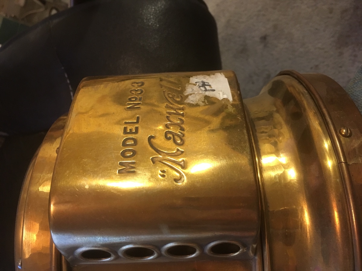

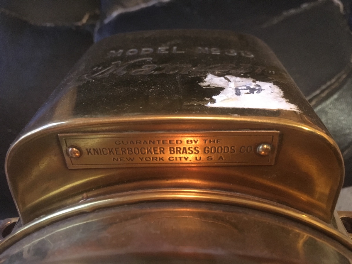

Rich, It's for a # 32 or a # 33 Maxwell head lamp. I have one of each and am trying to get a pair of one or the other. I'll get a photo this afternoon. Thanks jw
It sure looks nice John. The lettering is far beyond anything I have ever done. I have thought of doing some like that by soldering a panel in the front and back. The main shape would be easy enough to do and the holes wouldn't be a problem. Some lamps I have need that. If I ever try it I would let you know. Hopefully you will find a good original first.
There are some plain ones that look similar but probably not the same size around here somewhere.

Thanks Rich. I think I can do the lettering on the no. 34 by cutting a female component and using a dead blow hammer to pound an impression into a annealed sheet of brass. Kinda like you did with coil box lid. This is something I have done to some aircraft parts. Not sure of the best way to make the chimney. So you’re thinking 3 pieces and soldering them together.
thanks. Jw
Have at it and let us see if you get good results. Yep, 3 pieces. Some things we haven't tried are easier than we think.

Another part I couldn't find in 1996 was a good original type rain gutter for my Tudor. I had the remains of one side so I tooled up to make some. The main tooling consisted of 2 pieces of 3/8 x 1 1/2 bar with holes drilled 12" or so apart. Also a 1/2 x 1/2 bar with grooves ground down it's length. Bending some sheet metal sheared to a measured width to 90°was the first step. Then pounding a plate or pressing some rods formed the gutter groves. I tried both methods for different gutters. The gutter is nailed to the car and a filler piece covers the nails. I pressed the filler into place but others have slid it in from the end. A filler form a measuring tape works as well as the fabricated piece I made. With some trial and error I made gutters for 2 cars. Some nice repros are available now but this was my solution.

Hey Rich could you post a picture of the belt guide installed, thanks Doug
1924 Touring car
There's No Substitute for Proper Lubrication
Hi Doug. A front cover bolt holds it in place. Many will tell you these are not needed if pulleys are crowned and aligned. I still install them after the belt comes off a few times. These also may cause some extra wear on the belt if things are out of whack.

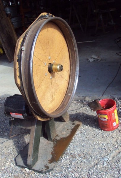

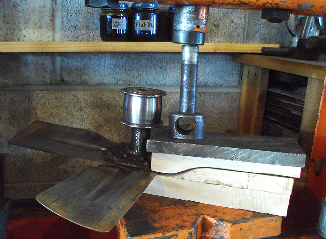

This fan's blades had become bent up over the years. I decided to make them all the same as close as I could by pressing them in maple forms.
Many coil boxes have badly deteriorated switch bodies. I brought the one on the left back to life using bondo and flat black enamel.
I took the worst one I had and cut two pieces of thin particle board to it's original shape. Using 5 original thru holes I screwed the pieces to it. Some random holes around the outside will give grip to the bondo. Masking tape helps keep the bondo from sticking to the partical board and makes it easier to separate them. I made new threaded inserts for the cover screws. Then the bondo is applied with a putty knife. Some sanding after the bondo dries and it is ready to paint.
There are many other products that may work as well or better than bondo. I use it because it is handy and has better shelf life than some others I have tried. The Bondo radiator caps and door handles I made have held up well for many years.
It's fairly easy to whittle out pieces like this spark rod lever with a hacksaw and file. Not perfect but works well.
My '14 frame had an original clip for the acetylene line on it. (frame upside-down in top photo) It was fairly simple to make some identical clips. I decided to make the bolts and nuts also so they would be very close to the same dimensions. The split collar allows me to mount square stock in a 3-jaw lathe chuck. The plate with holes and markings are the nuts before cutting them out. One small collar is for chucking the threaded bolt for chamfering the head. The other is for drilling the cotter pin hole.
Dallas, I don't recall where I saw that collar trick but I spent hours setting up on a 4 jaw chuck before I did. There are a million tricks out there we won't learn.
Larry, I didn't rivet to the top tank. That would have required taking the front or back of the tank loose and my soldering is not that great. It seems I drilled holes to clear the existing rivets and soldered around them. I know what you mean about the lengths to make a good radiator. If I did radiators all the time I could make a better radiator but the time would be several times others take and not many would pay for that. At least I wouldn't. I respect your wanting thing right.

Besides just liking to make things I thought my Mock 09 Touring didn't need to have original dash (firewall) brackets. They are a bit scarce or expensive and really aren't seen behind the hood former. Still, I wanted them to resemble the originals. Bending, welding, grinding and filing resulted in these. By bolting a flat washer to the bolt holes I could grind/file around them to give the proper appearance.

Thanks Rich. I was pleased to find these photos on a disk I had tucked away. I'm running out of items to post.

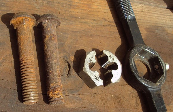

This shows how I save my wheel bolts. By cracking the nut off the bolt and breaking the die in half I can re-thread the bolt from the center out and over the mushroomed end. A heavy 3/8-16 is the right size nut and can be thinned to the correct thickness or used as is. The nuts are much cheaper that new bolts.

One area that needs to be addressed is the radiator. Above are examples of the brass radiators made by Ford, and currently made incorrectly by the Brassworks. Is it possible that a club member with talent would be able to correct the problem? Namely, I'm referring to attaching the side panels to the top tank with three rivets on each side, and curling around the bottom header? of the top tank the way Ford did, not the way it is currently done. Greg Gouviea, the original owner of the Brassworks did this correctly, but even he didn't attach the side panels with three rivets. Apparently neither of them realize that a Model T frame twists.
I hear you Larry. I hope someone can take that on and make it work financially for them. It would be a stretch with the extra time it would take. Many would rather buy a less expensive radiator and not realize the possible need for repair later. You haven't thought of taking this on have you?
I thought about posting this or not. My imperfect '14 touring didn't need to use the hard to find door latches. Any around should be used on finer cars. I had plenty of later latches so I made new handles that would resemble the correct ones for 3 later latches. Those who notice the difference should get a chuckle out of them. Others might not. At any rate the photo shows the springs in the latch channel for those who haven't seen one apart.
We all make choices that fit our needs.
The Maxwell windshield frame that I had to straighten is enough like a Model T WS frame that I considered it on topic here. The vehicle had obviously hit something and bent the stanchions and upper frame. If you will excuse my combining photos I can get more on in less space.
With the use of a press, some wood blocks with half-round grooves and some key stock I persuaded this frame back to nearly straight. The photos tell the story. Going slow and watching what is happening seems to work for me. I didn't have the option of looking for a better one as with my Model t parts. The Maxwell parts are harder to locate. At the bottom of the 4th picture is the stanchion with a shaped shaft that was used to take the bend out of it. Stubbornly I saved the glass channel but found that cracks appeared after the glass was installed. This has been consistent in most of the cars I have used it in.

Nice job Rich. Those frames are very hard to salvage like you did. Thanks for sharing.

Saving the junk is part of the fun. This '14 piece saved me from making a new one. Again a square stock was put to use.

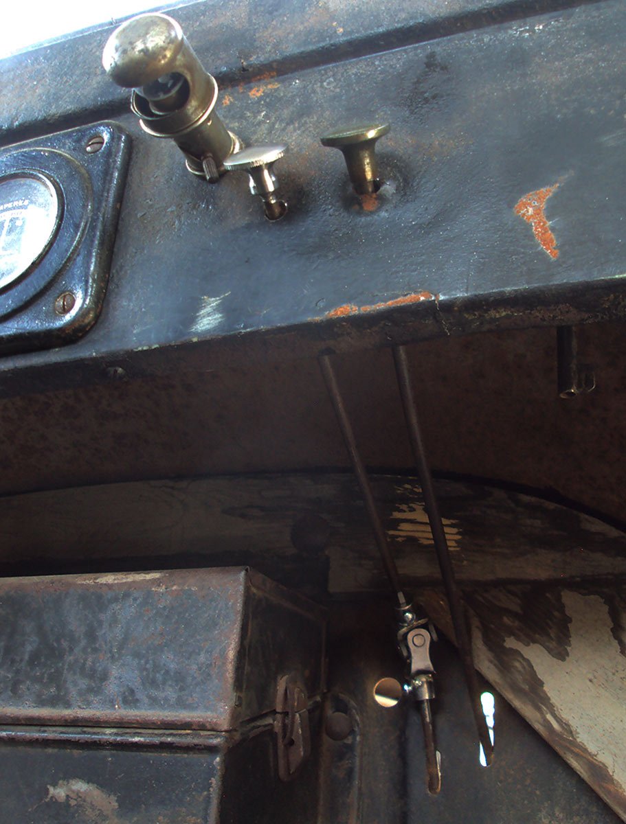

Today I finished up a mixture control project. Reaching under the dash is a bit of a stretch and a little distracting to my driving. It also alarms new passengers. I recall some accessories made for this but making my own version was fun. Copying the U-joint for 1926-27 cars and the choke knob give this a look of belonging here. I had hoped to mount it below the dash but the angle was too sharp and I had to drill a hole in the dash. The first piece was the cross. It's cut from 1/4" bar. Filing 3 sides to center in the chuck as shown. Then turning the ends. Next I cut some 12 gauge for the arms. I traced the arm from a needle valve arm on one end. By pinning the two arm blanks together with a cut-off from the cross end I could use the first curve cutout as a guide for all the rest. Flipping the pieces as needed. This makes it easier to cut them the same. Tracing leaves a little extra metal to trim up any differences after bending. Also drilling the holes smaller allows filing after bending as the holes never line up perfectly. (at least for me) Silver soldering some shanks and drilling them for the rods was the next step. If you are like me tapping #6-32 holes is as scary as driving a T on the freeway. I don't mind buying new taps but a broken one sure ruins the part as well as the day. No problems this time fortunately. Is it poetic justice to make the knob out of an old T axle shaft? It sure machined nicely and wasn't hardened in this area. The new parts looked nice but I had to take the shine off them with some heat and mud to match the rest of the car. It turns a little stiffly but that will help keep it from turning by itself. The adjusting needle nut is about worn out. All the materials were leftovers from other projects. The 3/16" rods are from a coil of welding rod that was scraped years ago. I've used a dozen feet so far and a hundred or so to go. It requires some straightening but has light rust and doesn't need further de-finishing. This was a satisfying project and it's nice to be making some parts now that the lawn it caught up with.
This is a jig I made to straighten my Coupe hood. The curves often seem to get out of shape. It got this hood as close as it needs to be. (There is even some original paint on it.)
KeithG
- Posts: 745
- First Name: Keith
- Last Name: Gumbinger
- Location: Kenosha, WI
Hi Rich, Your hood straightening jig looks really good. I wonder if there could be a market for them? One T of mine could sure use it.
Thanks for posting this neat idea.
Keith
Keith
Thanks Keith. They are easy enough to build out of scraps.
The ends of a Coupe door pull, shown at upper left, show that they break easily as they were made of pot metal or some less than durable material. I was able to make two out of aluminum stock. They shaped and polished well. They have worked fine for 6 years.
I needed a key for my new latch on the Coupe. It seemed like fun work so I made two and saved a few bucks.
There was a Fastenal store about 100 yards from our backyard. They were used to me asking for weird stuff. I asked if they had any 1/4 X 1 1/4 key stock. Well, I thought it was funny.
The key works well except when the lock hole fills with ice. For that reason I often leave the key in place during the Winter months. The Fastenal store is now a "Carpet Mart". We don't buy much there. When we moved here there was a grain field where the store is now. We used to watch the crop dusters in the evening. Beautiful! (cough, cough) I told Joy it was nice to live in the country and by the time we couldn't drive to town it would come out to us. Things change.
Rich Bingham
- Posts: 1942
- First Name: Rich
- Last Name: Bingham
- Location: Blackfoot, Idaho
"Key stock" - perfect ! What's so funny about that ?
I stopped counting when there were 50 new houses between here and town (just those I could see from the road). That was twenty years ago. Within the past two years, I'll bet there are 50 new homes within a radius of two miles of us. So far, no Carpet Mart, but we don't need no carpet nohow.
Ain't "progress" grand ?
"Get a horse !"
46woodduck
- Posts: 146
- Joined: Mon Jan 07, 2019 1:53 am
- First Name: Thomas
- Last Name: Petry
It's fun to make your own parts. How it used to be done before there was a parts store in every town. Part of the fun is learning how to be an amateur black smith/fabricator and build things that you may be able to buy. Much nicer to be able to say "I built that".
- Posts: 4404
Wonderful stuff here Rich E ! "Key stock", I caught it right off and I thought it was funny! However, it is generally believed I have a severely warped sense of humor.
I often make little parts and hardware. Sometimes because I want it to look more right than what I can buy locally. Sometimes because it is something simple I can make in twenty minutes and it would kill an hour to go to the hardware store. Often because I suddenly discover I don't have one, and it would need to be bought from a model T supply store. But I want it today and it would take a day or two to make the call and wait for the mail. I can make one in an hour or two, so sorry Glen C. And some reproduction parts I need to save money, and I figure I can make one for a few dollars rather than paying forty or fifty dollars for one. I would prefer to support the hobby and encourage others to manufacture things, but if I can save some dollars? That is not an option for me these days.
Today I made new brake cam sleeves. The old ones I made 11,000 miles ago were easy to form from 20 gauge (.036"). They helped at the time but the brake shoes have worn down some more. I chose some .081 thick stock (about 14 gauge) for the new ones. It doesn't bend as easily as the thinner steel did. Fortunately I had a jig from some other project (I can't remember what now) that would work to help bend the sleeves.
The pictures show how I pressed the steel into a U-shape using the jig and finish bending with a vice. The final push was back in the press.
These new sleeves result in the brake lever cam arm being nearly straight up (just a little before) when the shoes engage the drum. This is where the most mechanical advantage is. With the thinner sleeve the arm was about 25°to 30°forward which was not nearly as effective.
Vendors sell these but I am not sure what thickness they are.

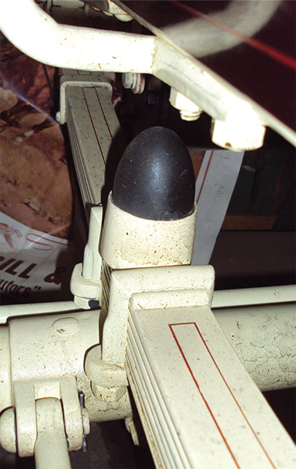

It seems there is never enough room to pack tools and other things in a Model T for a long trip. My solution here was to put a tool tray and a motorcycle battery box in the rear floor of my early Touring. This is easier to get at tools and small parts than removing the seat cushion. It is made from plywood and I used some galvanized sheet because I had it. The tool tray is above the exhaust so things inside do get a bit warm but not bad. The tray also rests on the frame. I have put “Flex Seal” tape between hoping it will cushion it.
I am using a 12V battery. I hate to see it so I tried to make a cover that looks like it might have come from early days. Well, it makes me happy. This has worked well for several years. As I had things apart for cleaning I took these photos today.
One drawback of having things in different places is remembering what is where. Sometimes I forget and duplicate items. Just part of the game I guess.

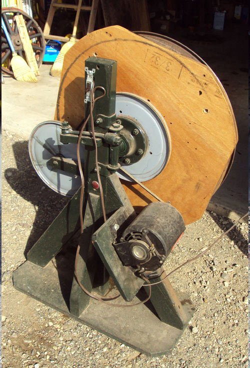

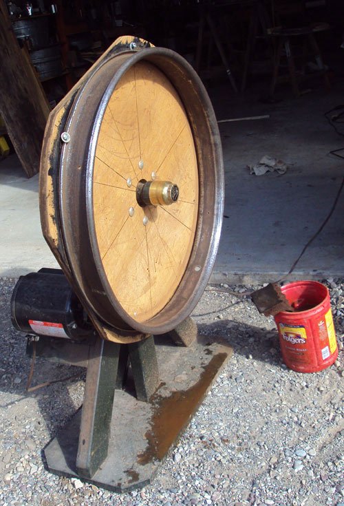

This rotating wheel makes wet sanding wheel rims go quickly. A Model t front spindle and hub as well as some washing machine pulleys worked well for this.

Not near the fun but I use a sandblaster. That would make it easy to paint as well. Think pinstripe!
Sandblasting may be the best. My neighbors yard and my sensitive lungs have given way to my discovery of the joy of wet sanding. That and finding 80 grit for $10 a sleeve have provided me with hours of pleasure. By using some top material scraps between the grit and my figures I can sand and daydream for hours about old friends, relatives, Kalamity Dick and countless other thoughts. It can be addictive.
My Tip sandblaster got me though several restorations including 18 years building my Yellowstone Bus. I have considered building a cabinet but resort to the water bucket and the 80 grit.
I figured any product endorsed by Manny, Moe & Jack had to be a good one. I realize now it really isn't them.
I have preached of the powers of wet sanding for some time but fear I don't have many followers.
Do what works for you but be careful.
- Posts: 2842
- First Name: Dallas
- Last Name: Landers
- Location: N.E. Indiana
You may be onto something Rich. I bet a hand full of screws and nuts in a gas tank bolted to that thing would clean it up nice!
