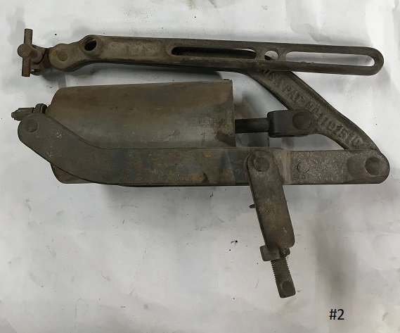

Post by TRDxB2 » Tue Jul 04, 2023 2:09 pm
This one can go anywhere. Approximate dimensions when folded: length is 13.5 inches x 4.5 inches at widest point. Coiling a hose dimensions?
viewtopic.php?f=5&t=29579&p=228233#p228233
