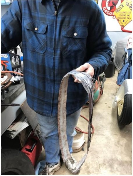

Don’t ever use what’s normally called duct tape. The “cloth” tape. When I did the tires on the ‘27 Tudor that’s what I found on all 4 wheels. Deteriorated practically into dust. A real mess. I used flaps but I’d definitely use the “real” duct tape. The aluminum tape with the paper backing. I believe that would really do the job at bargain prices.

Here-s what duct tape does in a wheel long term.
