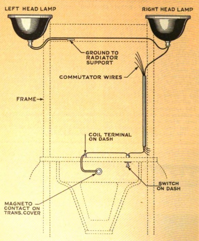

Old schematic for wiring magneto headlamps.

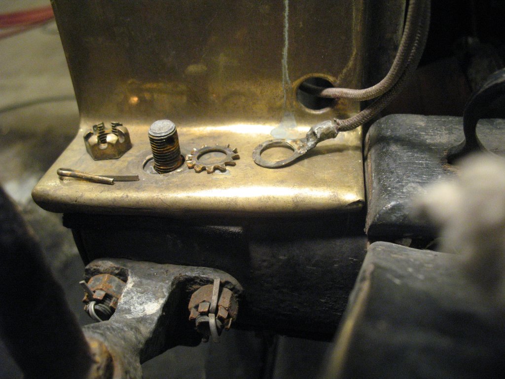

The wires shown are about 25 years old and from Langs. They were originally black but have faded.
Note that my father grounded the wire to the radiator stud. Originally, the wire was soldered to the radiator support.

An eye terminal and a toothed washer from the local farm supply make a good ground.

Thank you for the solid information. I will get the wire thru Lang's (by the foot) I figure 30' will be double what I need, so I'll go with that qty. Also looks like a single wire carries the load from switch to passenger side front light, then a single wire out from that headlight thru the tube on the radiator going to the drivers side head light & finally out of drivers headlight with a single wire to ground at the radiator? Did I get it correct? Thanks for the guidance, can you tell I'm new to this? Thanks! Chris
Yes, you did.
