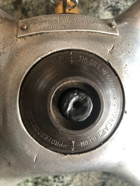

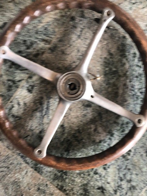

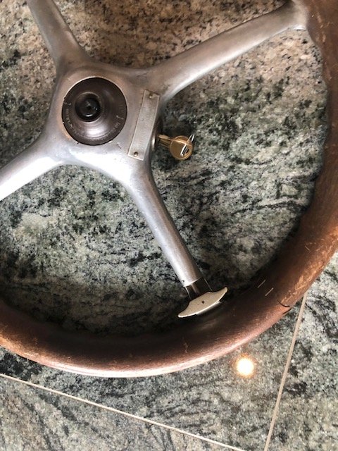

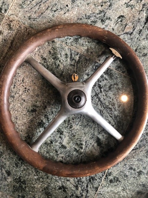

Does anyone have any information or literature on this lock.
I just bought a 1923 speedster and this steering wheel and I am unclear how it should be installed and work.
It may be the wheel lock is broken and if someone has seen or used or has any literature I thought that might be a place to start

This older post has a lot of info on the Dill Locking, seems it is the 'free spinning' type wheel, so thief is foiled by the steering wheel which won't steer. ;)

This is the "free wheeling" type of locking steering wheel, of the type that others have pointed out as being dangerous. I would either sell it, or use it as a wall hanger.

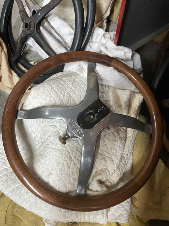

Post by DanTreace » Fri Jul 14, 2023 10:14 am

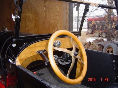

There are many 'tilt' wheels made for the Ford. Favorite is the Bauer brand, easy pull knob to release and lift up the wheel, and secures well too.
Lang's #3503WC is a repro tilt bracket, pricy but nice, you fit to the steering pinion post and then mount your existing wheel rim on it.

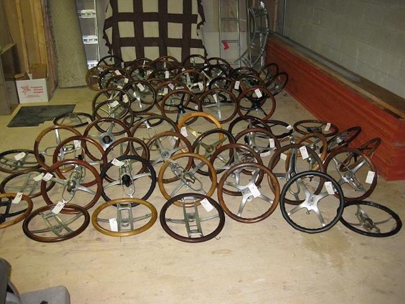

Someone's nice collection to envy!

I have this same wheel. Note the brass T handle. The hub is pinned until retracted.
I suppose the pin could sheer, but I am not concerned.
Put that on my obit. "He was not concerned" :D

John is right, on this style you have to retract the pin before you can lock it into free wheel. As an abundance of caution, I would inspect the spring, pin and the depth the pin rest inside the steering wheel hub. I have several fatman style steering wheels and a few free wheel style. A few are ones I would not use but, in my non authoritarian opinion, the type you have is a better built style. As with everything antique auto or part you do assume all the risk.

Dan, that's quite a collection of steering wheels. I have always thought I had a car collecting problem but wow. Maybe if I show my wife she will give me a break :)
Everyone else thanks for a little more info on the wheel. Maybe I will take it apart and learn how it works and see how I feel about it. I had not yet figured out what the pull lever did so that gives me a place to start

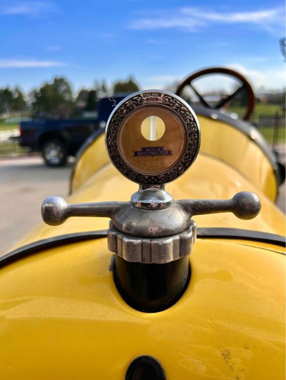

Post by ChevyKeith » Fri Jul 14, 2023 8:40 pm

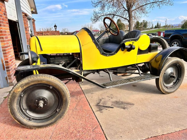

Figured I should post a pic of the car I am looking to put it on. Bought it for next year or so project. Finishing a 1949 Willys truck right now and a 1968 Firebird is next. Hopefully the T gets some loving next year.
It wouldn't start for the owner but I really don't think it is anything big. I have not yet figured out exactly what the steelie wheels are and I dont really know the significance of the radiator tank cap. This will be my first pre 1940 car so lots to learn.
Keith
Posts: 4114
Re: Protector Lock Steering Wheel - DILL Mfg Co
Post by DanTreace » Fri Jul 14, 2023 9:00 pm
Nice looking speedster!
Ya might not need a tilt folding wheel, the steering spider on the T now is upside down.
Just flip it around or add the smaller dia. 1914 and earlier wheel, give you some more space!

A smaller steering wheel will make it harder to control.

That was the reason for putting the Dill wheel on my 14.
The small wheel was a bit to responsive/squirely for my taste.
