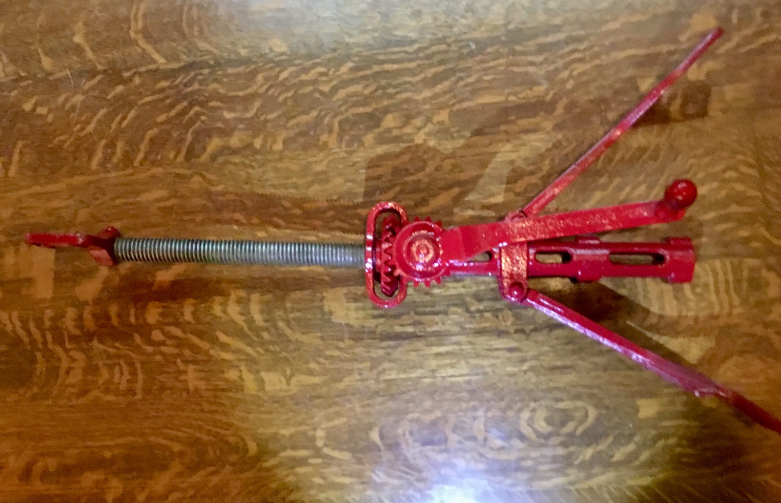

I can't figure out why but it seems that the three legged tool causes the rim to twist. Ends never seem to line up properly. I'm using old tires but surely this couldn't be the issue

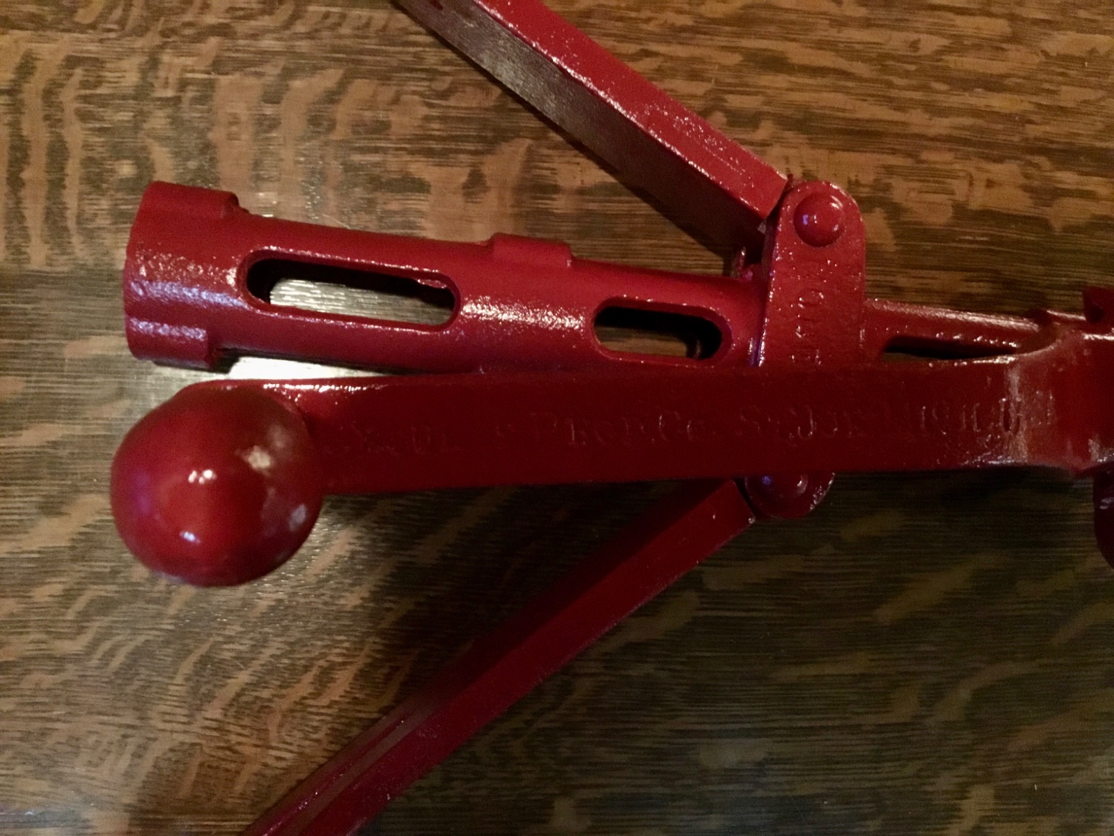

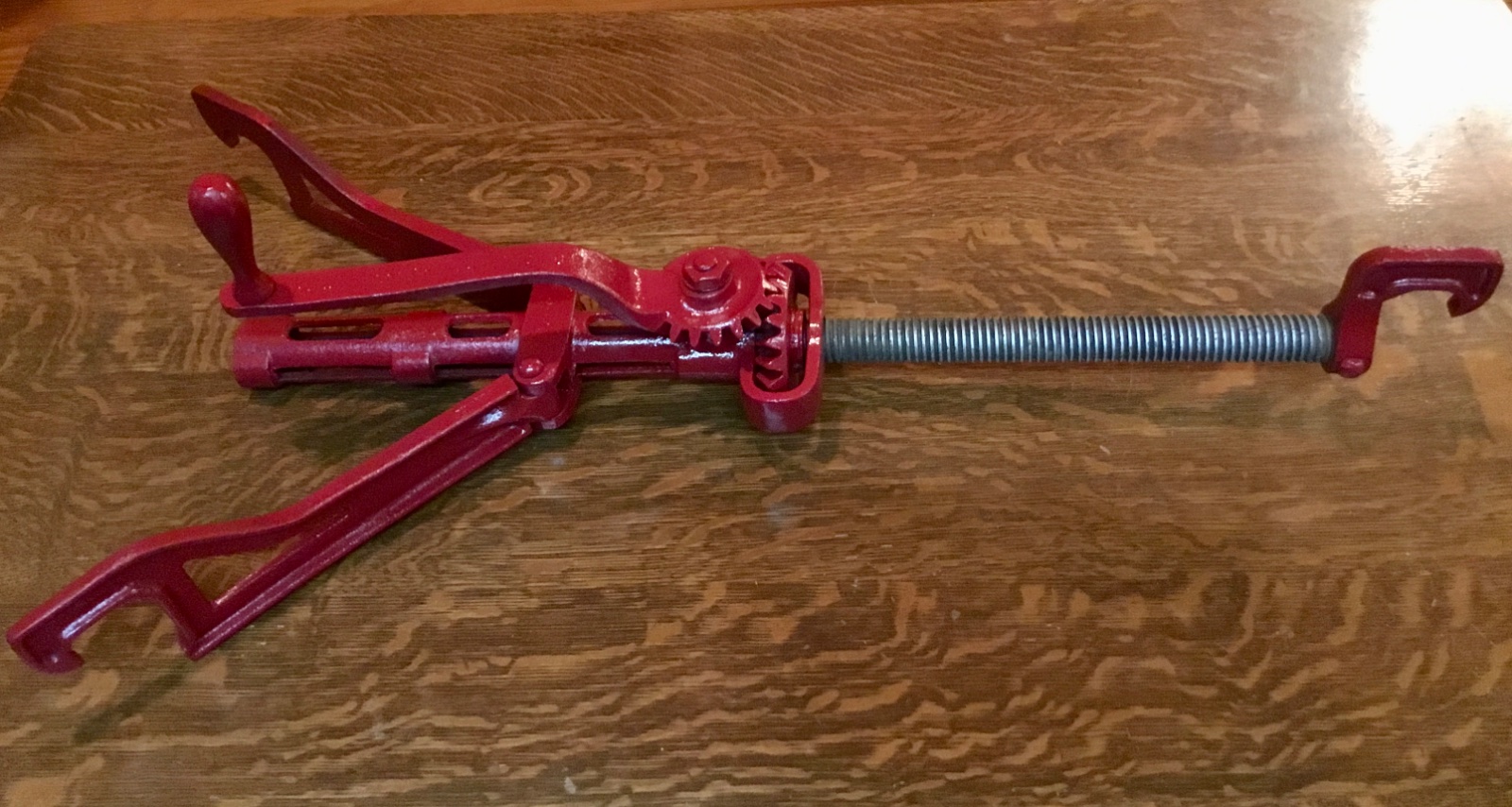

Re: The Curse of the Split Rim

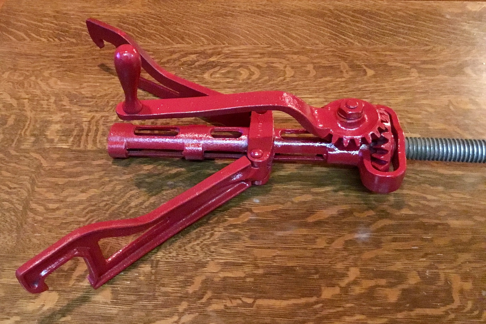

Just did two this AM these are harder to do then a clintch in my opinion
Used the three jag rim tool
Here's what I did
Tube in tire enough air in tube sorta round?? Still very soft 5-10 psi
Took rim tool compress the rim as far as I could meaning about 3" overlap
Stem of tube in the hole and tire iron put the tire on
Then removed the rim tool
Put it in the rimtips of the tool where the fellow would be now spread the rim to lockit
Now tocation of this rim tool is important
Put the one leg about 4" +/- from the inner end other opisight of that
May not be right way but got two mountedand locked
All I can say I can do cl8ntcher in 15 minutes and only do slit rims once in a blue moon

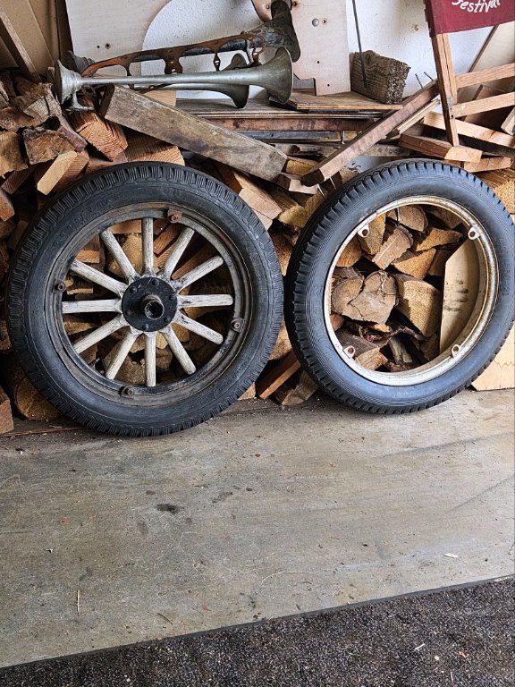

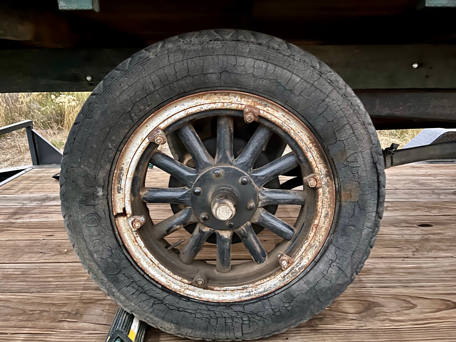

I have found this tread to be quite helpful, but I need to find a pair of rear tires for a 1925 Model TT Farm Truck. The tires that that need replacing are Firestone Gum Dipped 32 x 6 HD. I don’t believe that they make these any more, but I am having trouble figuring out an equivalent or replacement. The wheels are wooden-spoked, split rim. What do I need to measure to find something that fit?
[image]/Users/sheila/Pictures/Photos Library.photoslibrary/resources/derivatives/E/ED3B1546-B7B5-4664-973D-67E358503A31_1_105_c.jpeg[/image]
- Posts: 5252
Actually, this thread is of no use to you. Your wheels are "lock ring" not split rims. Thats a whole different kettle of fish.SheilaD wrote: ↑Thu Jul 03, 2025 12:49 pmI have found this tread to be quite helpful, but I need to find a pair of rear tires for a 1925 Model TT Farm Truck. The tires that that need replacing are Firestone Gum Dipped 32 x 6 HD. I don’t believe that they make these any more, but I am having trouble figuring out an equivalent or replacement. The wheels are wooden-spoked, split rim. What do I need to measure to find something that fit?
I can advise you be careful not to pretzel the lock ring during its removal & installation. Make sure the ring fully seats before airing up.
This type of wheel can be dangerous. Air up to the side in case the ring blows off, It can kill you.
Not an expert on TT's. I suspect the tire is a 20". Look for the information in other threads.

and these take modern 600 x 20 or 650 x 20 tires and they can be mounted on the split rims that you have. That said, you must be very careful when mounting tires on split rims as mentioned on the posts above.
I hope this helps.
Keith
I hope this helps.
Keith

I beg to disagree Keith, but those are not split rims - they're straight sided "Widow Makers" w/split ring - best left to a commercial truck tire store ! And they will take a 6:00 x 20 tire.

Sheila's wheels are like most truck wheels, prior to the development of tubeless tyres. The rims are made with only one side to hold the tyre on. The tube, flap and tyre are installed as a unit and the whole is dropped over the rim, which is NOT split. The second side of the rim is a separate lockring which when fitted slots into a recess in the rim. This lockring must seat perfectly in the recess or there is a chance it will explode off the rim as the tyre is inflated, with fatal consequences occasionally. Some wheels had two separate rings. One that holds the tyre on went on first. Then a second ring locked the first in place. This innovation was meant to be safer, but caution was still needed to make sure it was properly seated in the receiving groove.
10.00 x 20 inch truck tyres are big, heavy and unforgiving, but they drop onto rims, regardless of their age, because the steel wires in the beads maintain their size without any shrinkage. 21" straight sided T tyres are the same. Old or new, the diameter remains the same and they should fit in the same way. 30" clinchers are different. With no wire in the bead, they do shrink. Old, hardened clincher tyres can be impossible to fit, as they must be stretched over the bead on the rim. Any attempt to lever them on may well just mean breaking the hard rubber at the bead. Don't ask how I know this to be true.

I think truckers call them split rims but in the Model T world they are called lock rings. When I entered the hobby I also was confused for awhile. I finally found the difference between Model T split rims and rims with a lock ring.

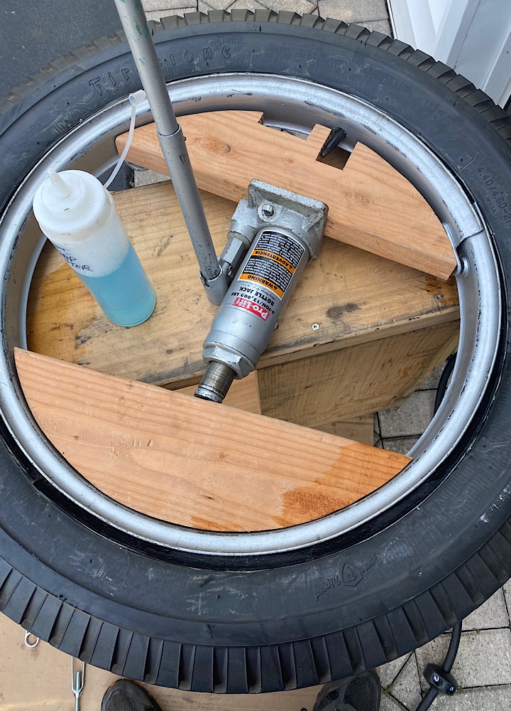

I used a turnbuckle to collapse mine. Used Harbor Freight tire irons. Soapy water. To spread the rims again after changing the tube I used a hydraulic Jack and 2x traced to the inner diameter. Hardest part was keeping the valve perpendicular to the rim. Had to adjust it several times and predict where it would end up.

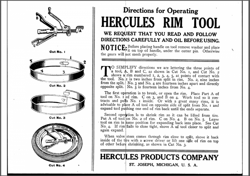

Here is my Hercules split rim tire tool. I used it to change all four of my 52 year old, rock hard Universal tires. The more you do, the easier it gets. Notice where the split is in Cut No. 4. Just follow the instructions. Use talcum powder. Good luck.

I mounted all five tires on the rim myself using the three legged tool. The old tires were so hard that I had to saw in some cases. The replacements were new pliable tires. When compressing the rim, if I saw the rim start to distort, I backed all the way off and placed the tool on the rim in a different orientation and tried again. It was a learning process. Other have shown specific ways to do this but even so, if YOUR rims begin to show signs of damage, then move the tool location.
On an other note, I used to drive a 1973 Ford Ranger Camper Special with 16" split rims. This is what Ford has to say about it:
