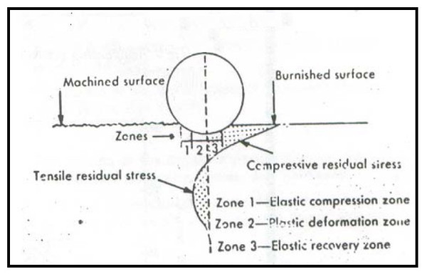

I'll piggy back something here rather than a new thread...
My Humber (UK) folder is really packed away, but I was able to find some e-material that I exchanged with the late Ralph Ricks when we were doing the blind push/pin tests about a decade ago.
Here is an example, of how balls reaming actually works! Were Ford to have ball reamed, it also may explain a bunch. Somewhere I do have proof that Ford did heat treat Z. (Heat treat yellow metal anneals it rather than hardens it). I recall being really curious about the hold temperature as it was within 10 degrees of precipitating one of the elements but just not quite there, a very curious point, yes? Look at the ball ream life cycle...it adds back IN compressive stresses to the surface....hmmmmm

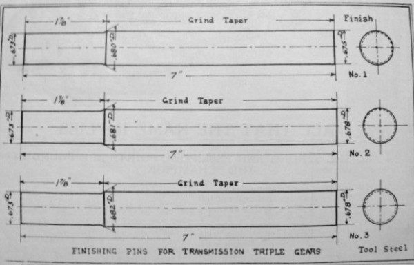

Ford Service Bulletin shows how to make a series of progressive larger tapered burnishing tools to size triple gear bushings and encouraged FORD agents to thusly treat all bushing replacements in this manner. Drawings with dimensions was supplied and FORD recommended that the burnishers be made from an old axle or a good tool steel.
The final bore diameter of the bushing would be somewhere shy of .682 as that was the finish size of the burnishing tool and there will be some spring-back in the bronze material. Additionally, the bore of the bushing would have a layer of very densely compacted material, a feature which is lacking in today's repair(s) along with the bushing being tightly swelled into the gear.
For Info: Factory drawings show ground pins to be .6775 at maximum material condition
Assuming a burnished bushing finishes at nominal .6815 and ground pin at maximum size of.6775, one would expect a total clearance, as repaired, of 0.004" or .0045 if the pin was at minimum diameter
I personally do not need further documentation or opinion as to what the "correct" clearance should be (for my personal work) as FORD documented all of it and I doubt that they were swamped with come-backs for spun bushings

Now I'm getting in over my head. I've never studied ball reaming. Can somebody describe/explain it or direct me to a source (preferably illustrated) that does? Google is not being helpful on this one.
Posts: 8643
Re: Seized triple gear bushing: Why?
Post by TXGOAT2 » Sat Jun 24, 2023 10:16 am
I believe it amounts to a mechanical hardening and sizing procedure.
Neither reaming nor honing will give the same result.

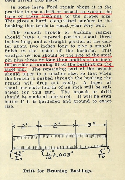

On the broaching subject, this is an interesting tool published by Murray Fahnestock in article with Ford Owner Dealer.
Gives note of the clearance for the .002" running fit, to make the broach .004" larger than the triple gear shaft.

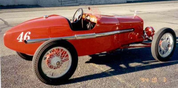

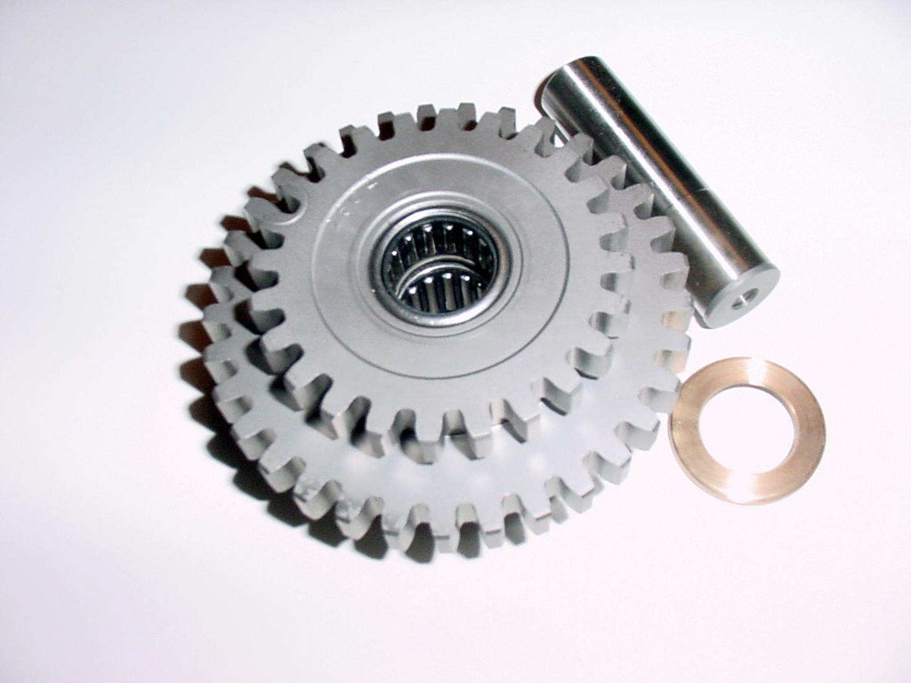

I was the first to use Dans needle bearing triple gears in my overhead powered speedster. Over 25 years and no problems Im sold!!!

I don't dispute that Murray did this piece that you posted, but do the math!!
the result is a hole which is .6905 which is wildly oversize
somewhere between Murray's notes and the publisher's ink, something went badly awry! ;)
Even FORD documents (not drawings) have minor errors creep into publication, but I'll stick with what they published in the service bulletin that I posted above. It clears up the dimensional controversy and results in foolproof parts (but boy, do Dan McE's gears look nice! They may well be my next ones)

Yes, that 6905 (11/16" + 003) dimension is quite gross. the factory spec after finishing was .6785-.6790. Yes, 4 digits accuracy and I do believe Ford was was able to hold to about 1/2 that range.
There would of course been a spring back factor from the mandrel if mandrel swedged, but at best probably something at the 4th decimal place? I just don't know. That STILL leaves way too much.

Posts: 6800
Post by Scott_Conger » Mon Jun 26, 2023 11:49 am
George
First I have the greatest respect for your background and metallurgical knowledge. I've seen the .679 value for installed bushings...and that would leave .0015 clearance on a new pin (pin at max condition). I'm pretty certain that this is actually the raw value expected after pressing the bushing into the gear, or as received from FORD as an assembly, pre-installation. Edit for readers: George Mills has kindly supplied a drawing which shows the .6785-.6790 value to be installed bushing/gear subassembly as reamed in place (not a raw pressed bushing as I earlier typed).
I think the important thing about that value is what follows in the documentation and it states that they are then reamed to size. Later, FORD determined that a broached finish was advantageous for dealers and we are blessed with the drawing which unequivocally defines what a finished diameter on an assembly would result (less spring back which will fall into the .000x range). If you will refer back to my earlier posting or see below, you'll see that the .679 bushing that you're referring to will be sized to .680 by the first broach and then increasingly larger sizes until .682 nominal is achieved. POOF! .682 (hole) - .6775 (pin) = .0045 (or so, clearance). Now, how about that! This falls exactly in the middle of "allowable range" of .004-.005 (see below). This aligns well with standards of the 1920's which absolutely define a .002" Running Fit to be a range of actual total clearance depending on load...and coincidentally for the pin diameter and load, .004 is defined as a .002" Running Fit. For young machinists that will argue that .002 Running Fit equals .002 total clearance, I will direct you to close your CNC manual and research early 20th Century practices and standard definitions - they are not what you work to. BTW George, I know you know this, but there are many or most who do not.
burnish triple gear pins4.jpg (89.16 KiB) Viewed 3825 times

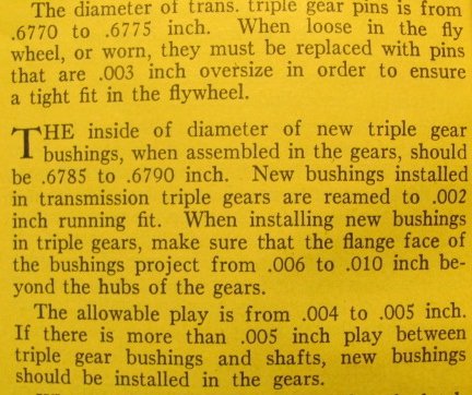

The Ford Service book states a .002" running fit. I've never been sure of what that term means? I saw it used twice in the above posts.
Posts: 6800
Post by Scott_Conger » Tue Jun 27, 2023 10:51 am
"Running Fit" is a class of tolerance
Running or Sliding Fit can encompass any one of 9 sub-classes of fit from RC1 (Close Sliding Fit) all the way to RC9 (Loose Running Fit). FORD's ".002" Running Fit was likely an early equivalent to RC7 Free Running Fit or RC8 Loose Running Fit
Using the below calculator and entering ".677" for "nominal", "RC" for Running or Sliding Fit, and then either RC7 or RC8 and by going down to the "FIT" section, you will suddenly see that your final clearances are on a much looser side than you would imagine. Given that FORD's smooth broaches gave a nominal .004 clearance, and .005" clearance was at max limit, I'd imagine that FORD's class of fit would be defined today, by ANSI B4.1, as the upper limit of a RC7 Free Running Fit that is defined as ".0045" at it's upper limit.
FORD's ".002" was never a tolerance or final clearance fit - it was part of defining what class the "Running Fit" was.
https://amesweb.info/fits-tolerances/an ... lator.aspx
