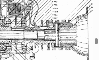

1909 parts book, a drawing shows the shifter sliding key.
Screenshot (176).png (69.77 KiB) Viewed 1030 times

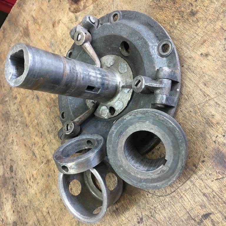

Re: Tail shaft and clutch shift
Post by speedytinc » Sat Jun 24, 2023 12:27 pm
I have seen the keyed throw out bearing on a 13. My late 14/early 15 did not have it.
