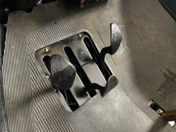

Thanks Scott. The reverse pedal does not sit lower than the other pedals at rest. I adjusted it so that the reverse pedal engaged fully when it was just a bit lower than the other two pedals when it was pressed. You can see the pedal at rest with the parking brake on in the photo attached.
I don’t have a lot of play on the pedal shafts and the hey don’t leak a noticeable amount of oil. The cams don’t look worn and start to cam pretty quickly and hen depressed. You can see the out side cams below.
Deformed bands would be a pisser. Only way to check would be to pull the engine.

if the reverse pedal is sitting lower than the other pedals when at rest, something is awry and I'd be very suspicious of the condition of the hog's head for starters”

- Attachments
- Brake pedal/cam
- IMG_1824.jpeg (83.79 KiB) Viewed 3182 times
- Pedals with the parking brake halfway back
- IMG_1825.jpeg (138.39 KiB) Viewed 3182 times

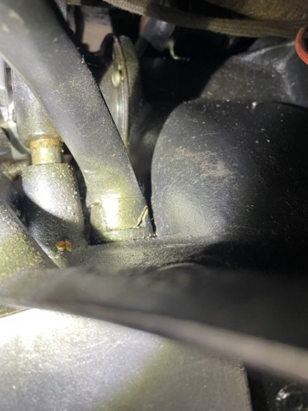

everse pedal and cam.

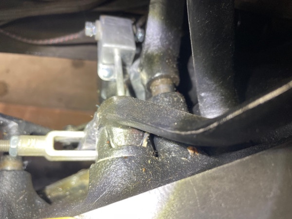

The cam surfaces on the low and brake look ok to me…
I backed the low pedal adjustment off half a turn and it’s not dragging when the brake lever is back half way. I have free neutral and can roll the car in that position.
I am concerned about brake and reverse bands dragging.

- Attachments
- Low speed pedal and cam
- IMG_1826.jpeg (82.63 KiB) Viewed 3182 times
- Posts: 7275
Re: Tops for adjusting Kevlar bands?
Morgan, I approach the adjustment from the low side, as you have when they are not quite working as they should. I adjust one turn on the nut, and do a test drive. If that gives you enough, do not be tempted to give it another turn to save another adjustment later on. You need to leave as much clearance between band and drum, consistent with proper engagement. It is usual to have to make three or for such adjustments as Kevlar bands settle in. Then it is rare to need any further adjustments for ages.
Hope this helps,

- Posts: 5252
Post by speedytinc » Sat Jun 24, 2023 9:09 am
The 1" "rule" doesnt apply to kevlar.
Proper low pedal setting:...With the motor running.
Back off the adjuster some. Start the motor. Tighten adjuster until you just start to hear the triple gears change their song.(from nothing to a little grumble) Back off 1/2 turn. lock down. Your band is now adjusted to its maximum optimal position with no drag. (Otherwise its a guessing game. To tight= drag = friction heat = broken drums.)
If you dont have enough pedal to lock the low drum plus some space before the pedal hits the floor, you have an issue. (New Kevlar lining takes 3 or 4 adjustment, then they are seemingly set for life.)
Out of round band, a loop in the lining or badly worn internal cams. Cant have a high spot bump in the lining.
Adjust reverse similarly. Note how much extra pedal travel. Adjust that out until you have no triple gear grumble until after slight pedal engagement.
If you adjust this way there is no unengaged friction which heats & breaks drums.
If you do determine an issue, you dont need to pull the motor. you will need the remove the HH.
For the folks playing @ home. Remember to manually oil the brake & reverse pedal cams if the pedal shafts have been made leak proof.(O-ringed or sealed). Dry pedal cams will gall & get stiff to the point they need more & more leg pressure until they eventually wont move.
