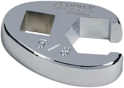

I use a crows foot socket to both remove, install & torque the 2 rear bolts.

Richard, a crows foot will give access to the bolt head, but the problem is being able to lift the bolt out of the head. The body/firewall limits this.

Re: Swapping out head bolts and not pull head
All I had to read was will give access to and I remembered that it is still against the firewall. Thanks!

- Posts: 5599
This is the best designed tool for that task !
