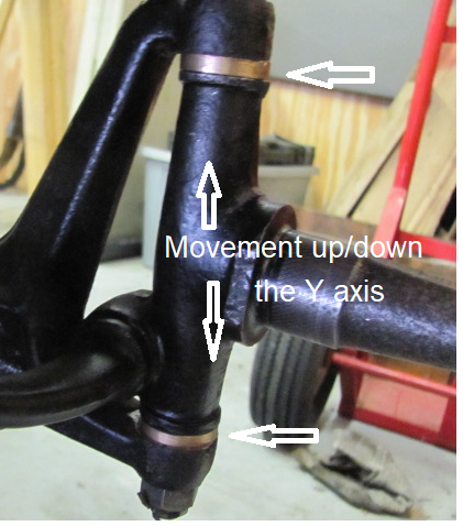

I noted some front right wheel wobble. I removed the wheel. Bearings are fine. Sighting straight along the length of the spindle from the threaded end, it moves slightly up and down by hand in the Y axis only, and none the X axis or Z axis. I guess that rebuilding the spindle body with new bushings will eliminate spindle movement, but I don't want to assume anything. Advice, please. TIA.

Remove kingpin cotter pin, snug up nut & replace cotter pin. Also tighten wheel hub nuts.

When loaded, the upper bushing rubs & pivots on the upper axle arm. The lower does nothing. You have NO issue.

If I understand your description of movement it sounds like there is excessive wear in the flange of the spindle bushings. They should appear somewhat thick. Then they need replacing. Their thickness is fitted to the axle jaw.GBarr wrote: ↑Thu Jul 06, 2023 1:42 pmI noted some front right wheel wobble. I removed the wheel. Bearings are fine. Sighting straight along the length of the spindle from the threaded end, it moves slightly up and down by hand in the Y axis only, and none the X axis or Z axis. I guess that rebuilding the spindle body with new bushings will eliminate spindle movement, but I don't want to assume anything. Advice, please. TIA.
While your at it you should check the other steering arm components for wear as well

The up and down movement is of no real importance, assuming there's still a flange remaining on the upper bushing and that all else is in good condition.
As for wheel wobble... yup, they do that sometimes. Again, unless it's excessive, or the spokes are loose, and if the bearings are good and adjusted properly, it's not a problem.

AND/OR Loose motor mount to spring connection… AND/OR axle/perches installed backwards… AND/OR kingpins installed with yokes adjusted too tight…
