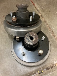

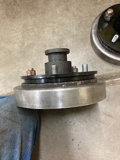

Hi Dave,
There are some options I set these up for a friend that has a small drum Ruckstell & wants to run wire wheels on his car. He's getting up in years
& does not want to deal with 30 X 3 1/2" clinchers any more. but wants to have Aux. brakes. They took some research but if a mechanic with a
lathe can do it most any machinest can. Nice wheels! as far as I have heard from the guy taking care of Larry Sidmores A-C brake stuff it is in
Escrow. So hopfully they will be back inprodution soon.

Craig - Thanks for the pics. Looks like you've added a spacer plate onto the hubs to move the wheel out to the point that the spokes don't interfere with the brake calipers, correct?
Craig Leach
- Posts: 2036
- First Name: craig
- Last Name: leach
- Location: Laveen Az
Re: Fitting Accessory Brakes with Aftermarket Wheels
Dave,
Yes the plates came from two different suppliers, the larger one (to sopport the wheel ) only comes in 1/4" & needed 5/8" spacing. I had to
replace the studs with longer ones to accomidate plates. I used Dorman serrated press in studs.
Drove a T with Sure stops on it the other day very nice if they fit your application. I don't know if the calipers will interfear with the spokes.
We need to remember that spacing the wheels out will increase the load on the axles & bearings. This would be a great place for full floating
hubs if they will work out.
Craig.
Craig.

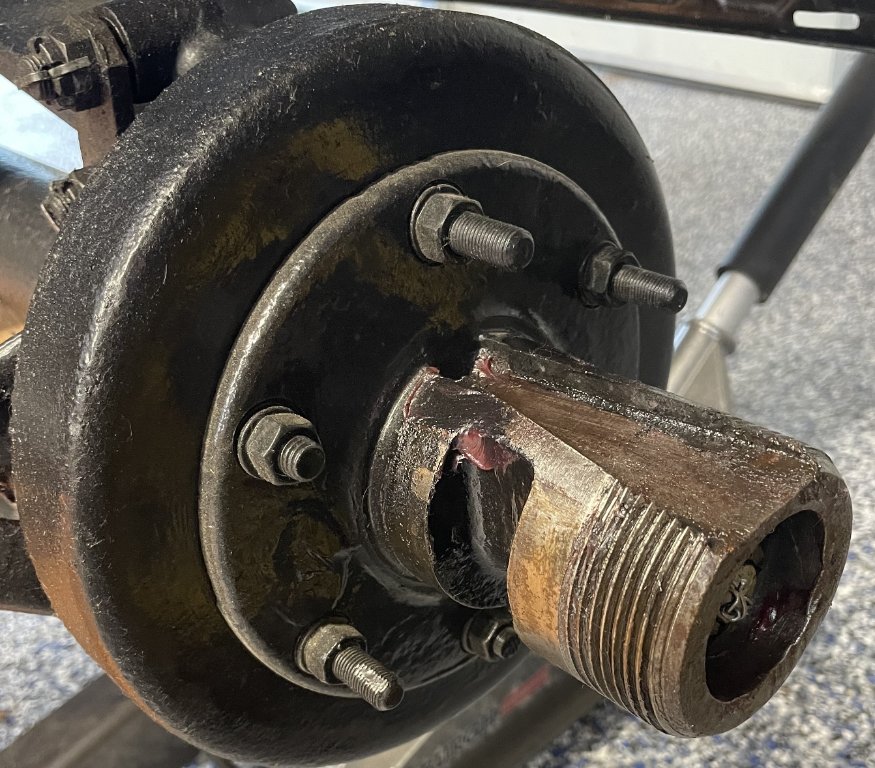

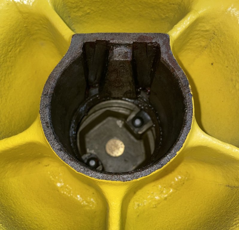

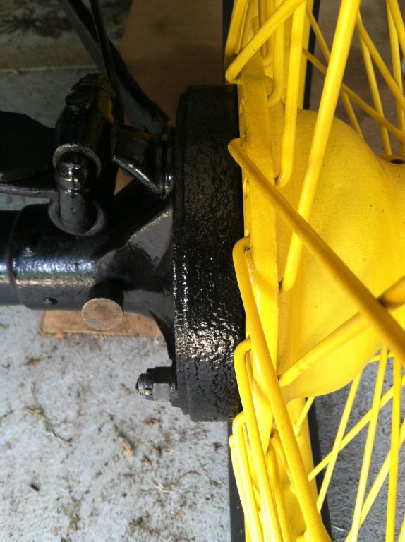

Support shouldn't be a problem. The Simplex hubs that attach to the drums have a V-channel that lines-up with and provides support for a corresponding flat on the wheel hub. Photos attached.

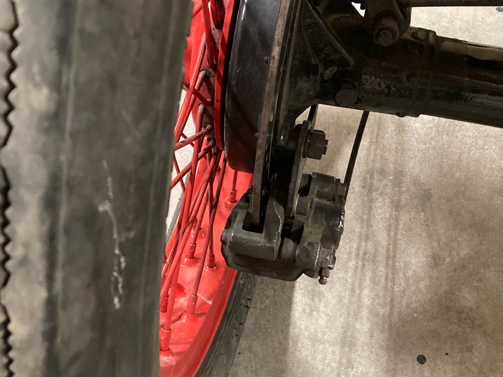

Here’s a look at the Honda Goldwing brakes on the rear of my speedster. More than strong enough to do the job, especially if you continue to drive your T like a T. Can’t really tell from this angle but the caliper occupies about 1” of the drums 1.25” width.

The calipers are used on many different 80’s-90’s era Honda (and probably others too) motorbike models. It seems like every model had a different mounting bracket so best to look at all your options at the wrecking yard. Rotors can be challenging too, these were mid 80’s Nighthawk with mag wheels (not sure why I remember that…?!). Most rotors have a small 3”ish hole in the center, these had about a 7” center hole.
The calipers are hung on a simple 3/16” steel horseshoe bracket that bolts to the lower wishbone bolt and the brake pivot bolt. Calipers are not modified.
Don’t weld the rotor to the drum unless you can turn it true when finished. These rotors are bolted to a small ring that is welded to the drum. The drum was bolted to a hub then trued.
