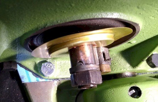

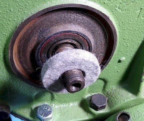

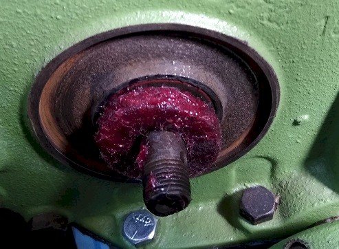

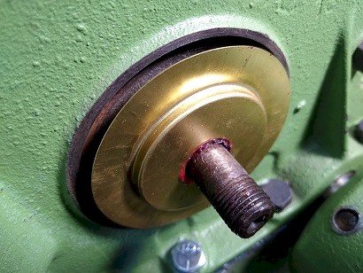

So, I purchased some parts from the vendors for the day timer with a bushing.
I greased the felt to help stop leaking?
The pin would not go into camshaft hole unless I screwed down the nut some.
When I turned the hand crank, things started looking bad.
Is the felt the wrong size?

Re: Timer... "Ain't Nobody Got Time for That."
Your cam nut is fitted with a modern seal, forget about the felt and the disc.
- Posts: 3028
- Last Name: House
I agree…..
- Posts: 6800
Hopefully the modern seal is not crushed or otherwise distorted now
- Posts: 4683
You mentioned in your first post that the felt was installed to help stop leaking. Was it leaking? If it was leaking the seal needs replacing.
Since you have a modern seal installed it takes the place of the felt and felt cover.
- Posts: 7411
Yes, ditch the felt and disk. If the seal is leaking, replace it with a new one installed with Ultra Black or other good sealant behind it. It won't hurt to put a little grease on the shaft to help the new seal slide into place.

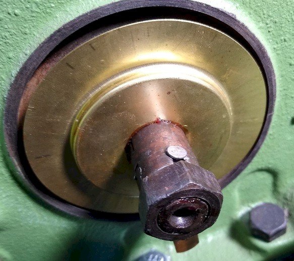

...leaking in general.
This is a new seal and I obviously don't know what I'm doing. Felt removed.
Thanks guys.
Vern

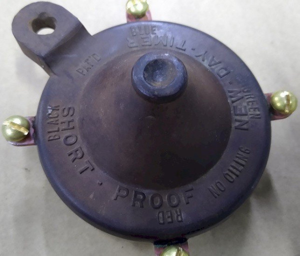

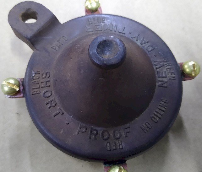

We are talking about timers and oil, however...
Our "New Day Timer" says "no oiling".
I'm assuming that is still true by today's standards.
Vern (Vieux Carre)
- Posts: 3743
- Last Name: Wrenn

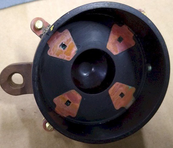

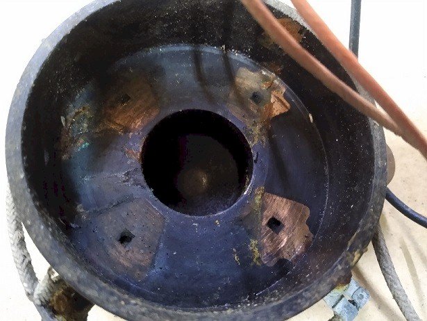

YES! Oil is a carbon brushes worst enemy. Just keep it clean..I still love and prefer my TW timers but they too need cleaned every oil change. No big deal to do it and I've never had a car run so smooth.
- Posts: 4683
Just another maintenance item. The original roller timers were good but eventually made a mess after a while because of the oiling maintenance that came with them. They had an oil access cap on them. Over time if you didn’t clean up the area it got pretty grimy and dirty.
The New Day was an improvement in that area because it didn’t need excessive routine oiling and only a little cleaning like yours. Now days WD40 will clean them up pretty well or using fine sandpaper to lightly and evenly sand them. Steve Jelf has a forum post how to clean one up if it needs more attention than yours.

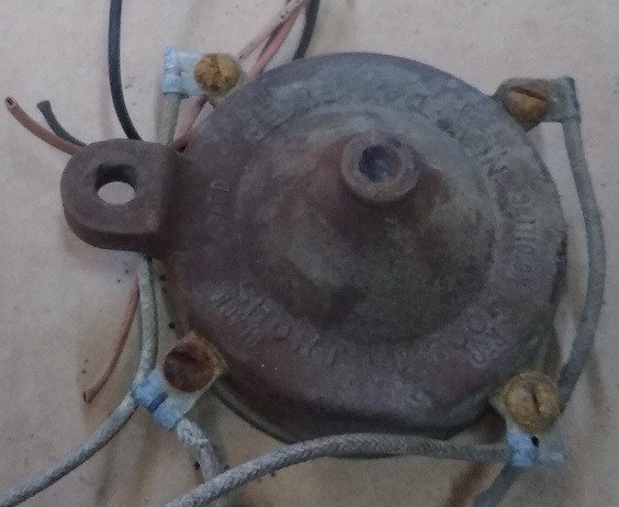

varmint
Topic author - Posts: 1042
- First Name: Vernon
- Last Name: Worley
- Location: New Orleans, LA
Jerry,
I have no idea how it got so clean. Just handed to the wife and that's the way I got it back, with screws in place. She threw away the old steel ones.
Vern
Vern
Vern (Vieux Carre)
- Posts: 4683
I’ll bet she may have used an S O S pad. With the soap that’s in them and the fine steel wool they make a great cleaning and polishing pad.
