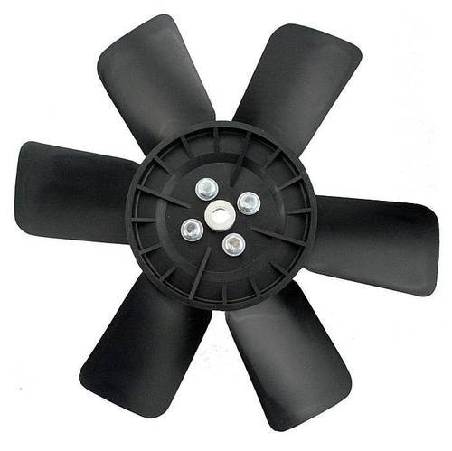

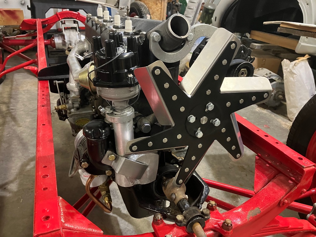

I saw that the plastic fan offered for the model A will fit on a T. Is this true?
Is it a good thing to do, to prevent a cracked T fan from exploding and trashing the radiator? I've got a new brassworks I'd like protect.

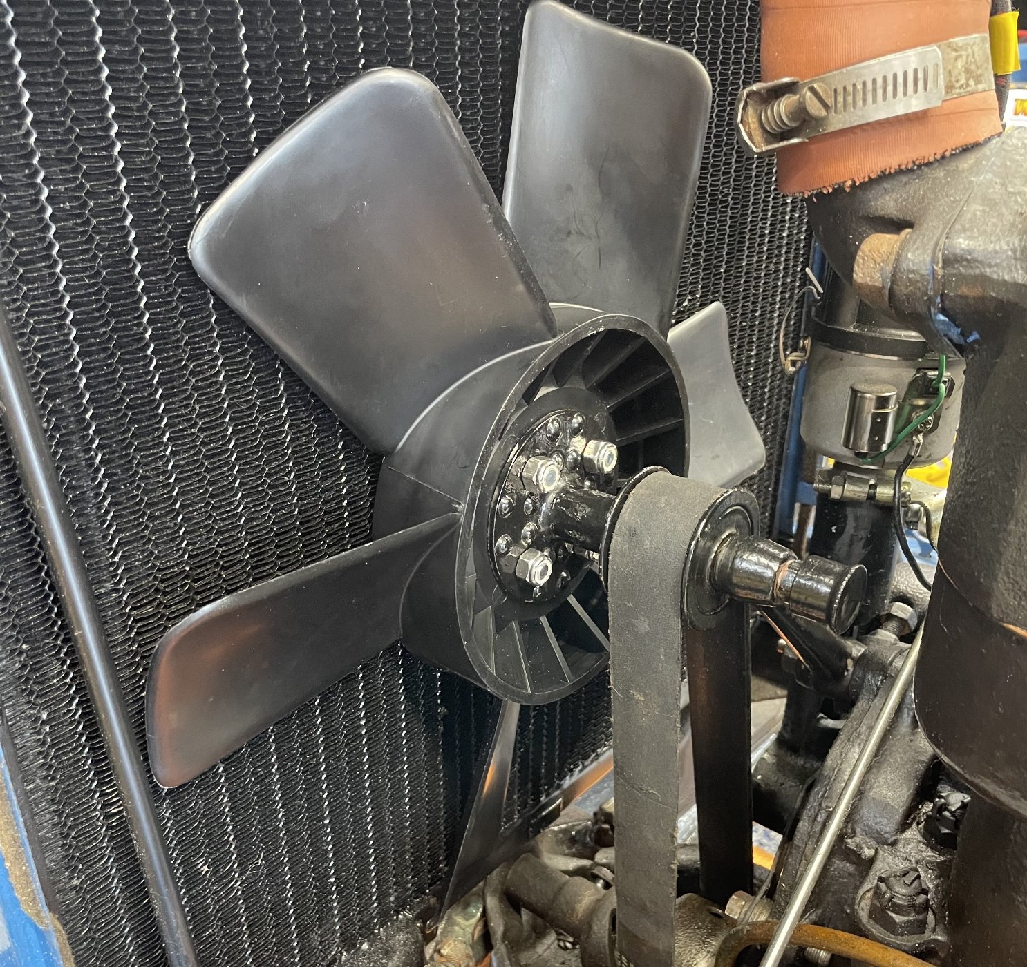

Here is a version I have done. The fan is 13” diameter so will just fit behind a brass radiator

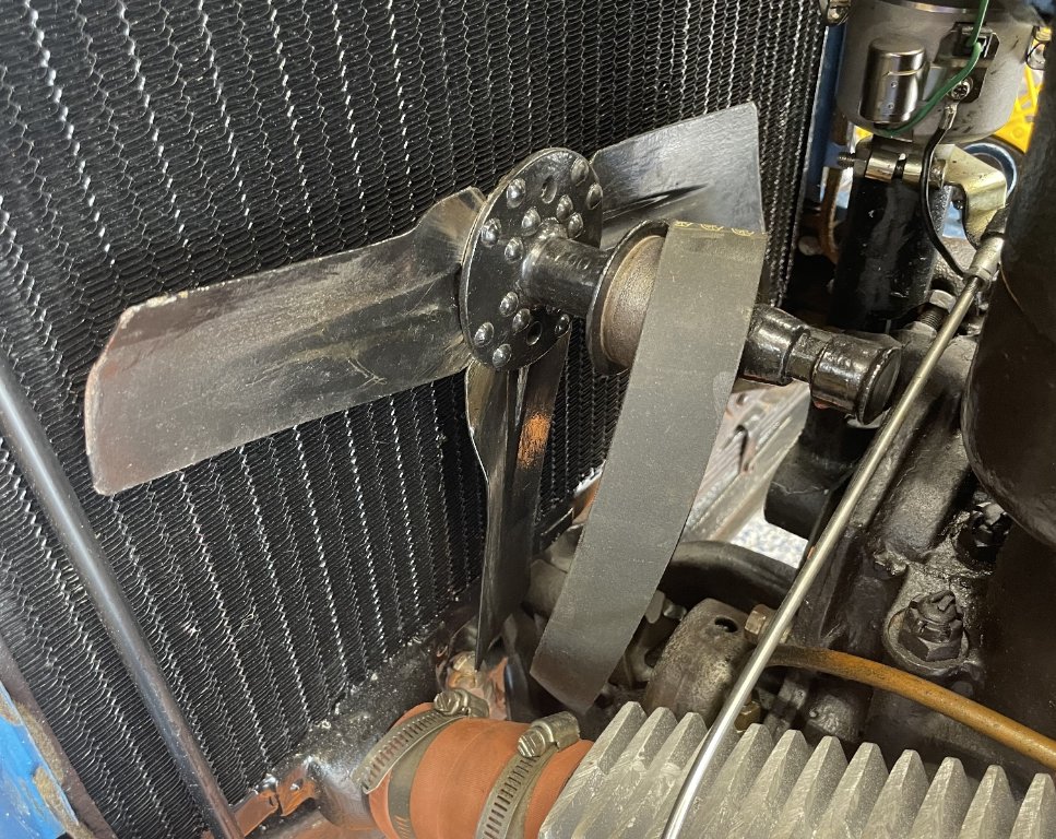

Most of the failures occur with the four riveted blade fans on the earlier T's. These need to be monitored. The one on my 1912 van began making clicking noises. I caught it before the blade liberated itself.The later two types are far less prone to failure in my experience.

The cracked four-blade riveted fan on my '27 was just about the first thing that I replaced.

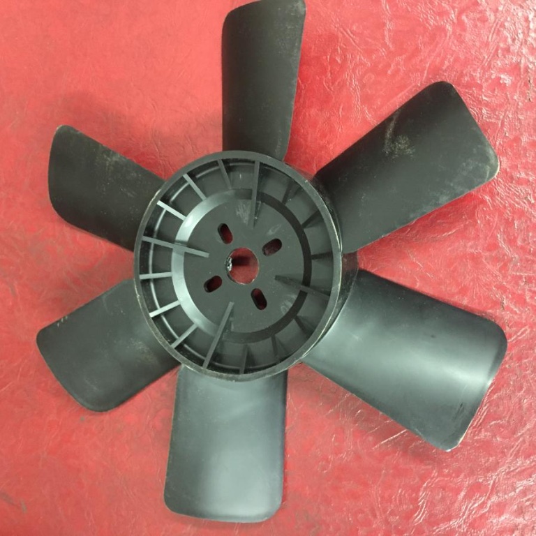

Are the four fan hub mounting holes located in the same place on the T and the A?
T and A fans interchangeable?
I'm wanting to find a bolt on plastic upgrade.

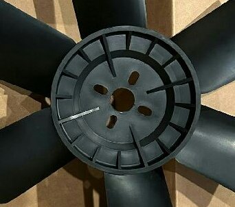

From your post of the Spokane club site, that plastic fan has oval holes for mounting, so yes, should fit the fan pulley, except, the modern hub for T with the sealed bearings would be the best to use with that multi blade plastic.Professor Fate wrote: ↑Sat Jul 08, 2023 9:51 amAre the four fan hub mounting holes located in the same place on the T and the A?
I'm wanting to find a bolt on plastic upgrade.A-8600-P.jpgIMG_1u7tgdh399.JPG.opt558x836o0,0s558x836.jpeg

Thanks Dan.
I'm going to do the hub upgrade with the fan.

Yup. I bought one. During my post-purchase inspection I found that the original had a cracked blade. I bought that and a sealed bearing pully from Lang's. BTW: If I knew the engine had a cracked fan blade, I would do one of two things immediately; Not start the engine, or remove the belt. You would not believe the amount of damage a broken fan blade can do.Jerry VanOoteghem wrote: ↑Sun Jul 02, 2023 8:38 amThis prevents broken fan blades too https://www.modeltford.com/item/3961C.aspx

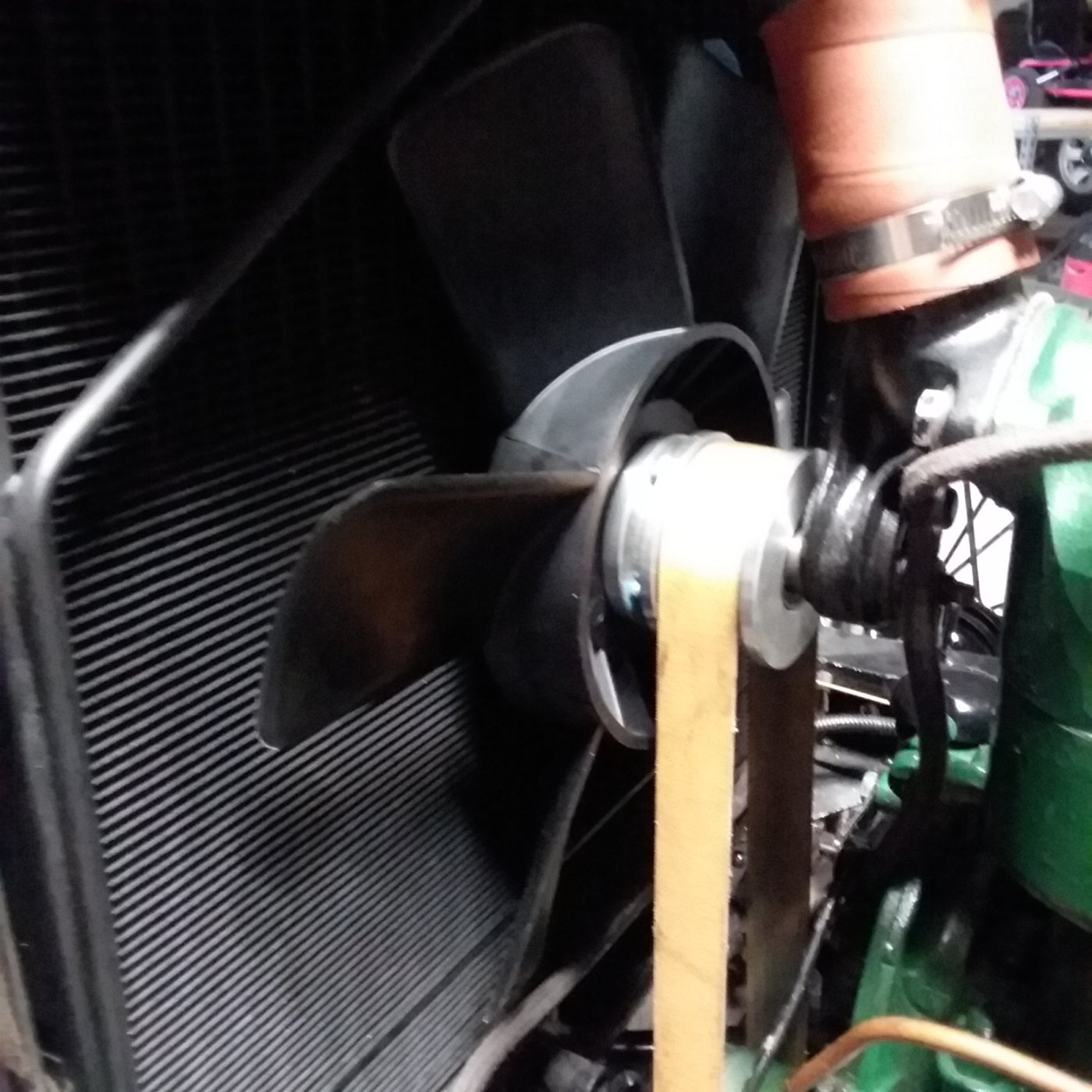

I run a Model A plastic fan in my coupe. Bolts right up to the T hub. Cools nicely with very little tension.

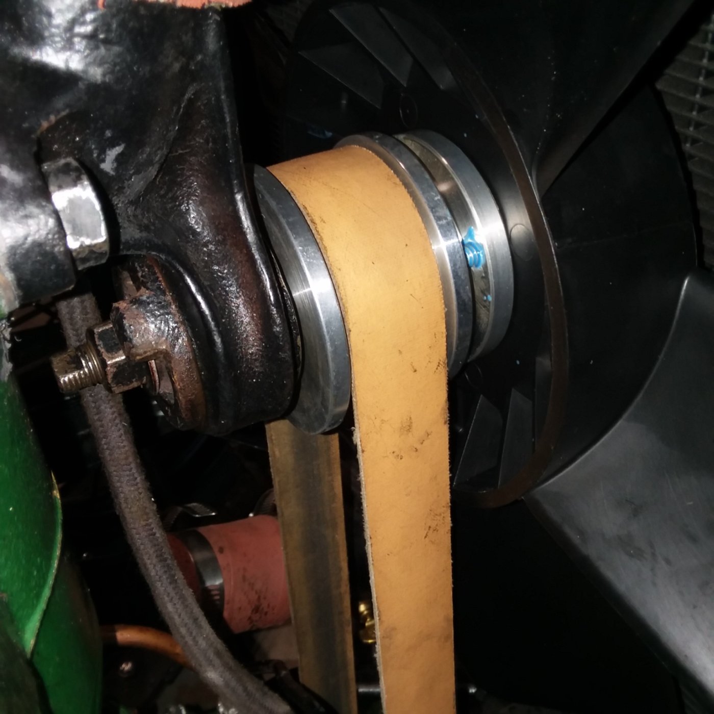

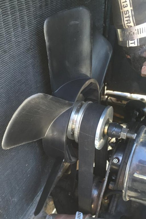

Plastic fan installed. 1rst run with it pending this a.m. I was unable to center the fan perfectly on the pulley, because there's no centering pin or any way provided to do it. I had to devise my own method, which I think is very close but not exact.
Has anyone else done this conversion and been successful?

I found that the new ball bearing hub that I ordered wouldn't work with the old shaft I had, so I used the old hub. Had to grind down the rivets on the front face of the hub and drill two additional mounting holes for the bolts, but I was able to get the new fan mounted on-center and the whole assembly back in using the old hub and shaft. Not much clearance between the radiator and the fan blades, but there's enough and it works without any interference.

Unable to set plastic fan dead center on pulley because of lack of a key or pin.
I'm afraid of it walking, so I put the original metal fan on the ball bearing hub for now. Gonna run it as is.
So much for succeeding for now.

I have a 1914 Touring with the proper fan blade for that year. My engine runs cool as long as I am moving, but the early blades have very little pitch so it gets HOT when you are sitting and idling. If there is a long line at a drive through I shut the car down and go inside because it will overheat if I sit and idle for a long time....
I have been thinking about putting a higher pitched blade on from a later model T or one of those plastic fan blades with lots of blades. I have one of those plastic fans on my Model A and it works great.

Does the model A fan pulley hub have an idex or pin to center the plastic fan?
That is my sole issue right now.

Any fan that has been bent and straightened is suspect. Any fan with a crack or loose rivits is suspect. Any fan that is heavily rusted is suspect. A fan that shows uneven pitch or wobble is suspect.
Fans on lower speed applications usually show visible evidence of problems well before they fly apart.
Fans, steering and suspension parts, brake rods and internal brake mechanisms, and wheel and tire assemblies need to be looked over from time to time, as do brake lever ratchet parts. Rear axle hubs and nuts need to be kept tight. Frames and frame crossmembers need to be inspected once in a while, along with motor mounts.
Bolts and other fasteners need checked and tightened as necessary.

The model A fan coupled with the roller bearing fan pulley hub would be a really sweet set up.... but there is currently no way to index and pin the fan dead center on the hub. I'm hoping somebody smarter than me figures it out, because I'd love to run this set up on my cars.
Running the roller bearing hub with a good metal 4 blade for now....

One could certainly machine a piece to fit into the face of the pulley hub that must have a protrusion thru the center of the existing plastic fan hub.Craig Leach wrote: ↑Fri Aug 25, 2023 9:53 pm.... Can a piece be machined to center the fan & incerted into the hub?
Craig.
But the other issue is that the fan hub screw holes, all four of them, are ovals not circles, and do not touch the mounting screws. The only support there comes from the screw head, lockwasher, and flat washer.
Too much play for my liking.

Note the oval shaped holes in the plastic fan hub.... and the recessed area on the face of roller bearing pulley near and around the bearing. That's what I discussed in the prior post.
- Attachments

I would not be comfortable with the mismatched fan and hub. I see no virtue in the plastic fan. It might move more air at very low speeds, or not, but I doubt if it would offer any improvement at higher speeds, since each blade would be running in the wake of the preceding blade. The large diameter hub of the fan would block air at any speed.
A good repro steel 4 blade fan on a ball bearing hub will do a good job, and it will move about as much air as the T belt drive will allow. It may offer other benefits, such as a small damping effect on torsional crankshaft vibration, and it will certainly look more like something Ford would have put on a Model T.
I'd inspect a new repro steel fan, looking for any irregularities, and check it for good balance, consistent blade pitch, and blade alignment. Hub bolts on any fan ought to be tightened evenly, using proper washers and lock washers.
