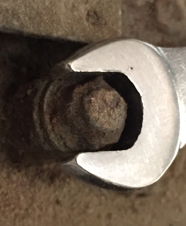

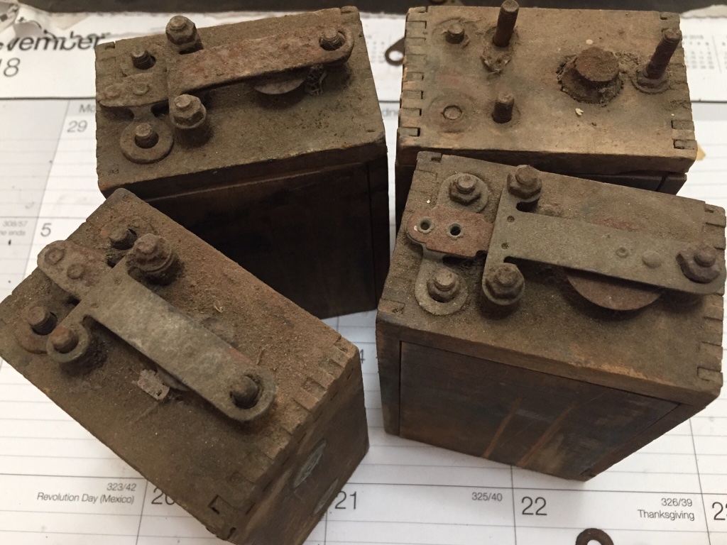

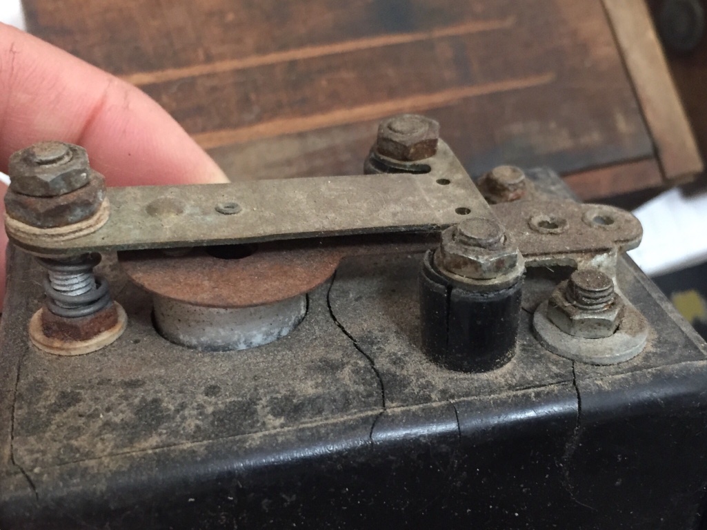

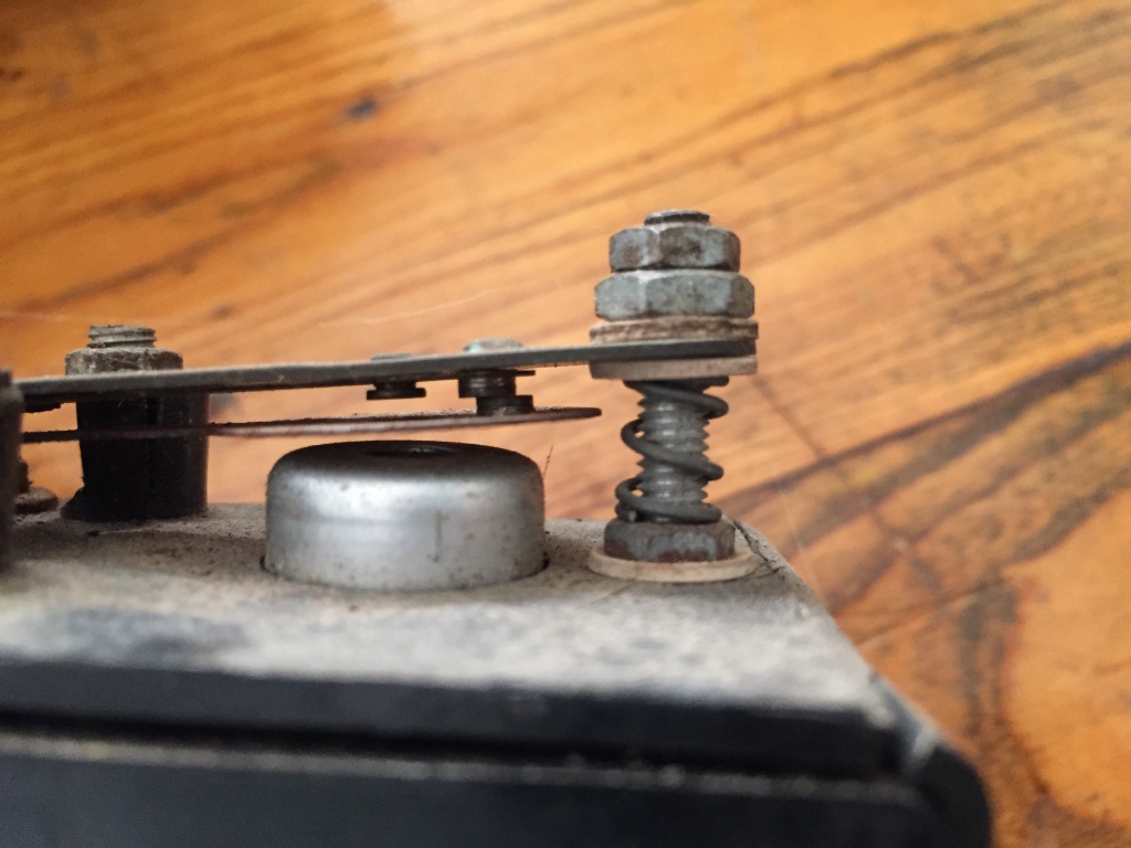

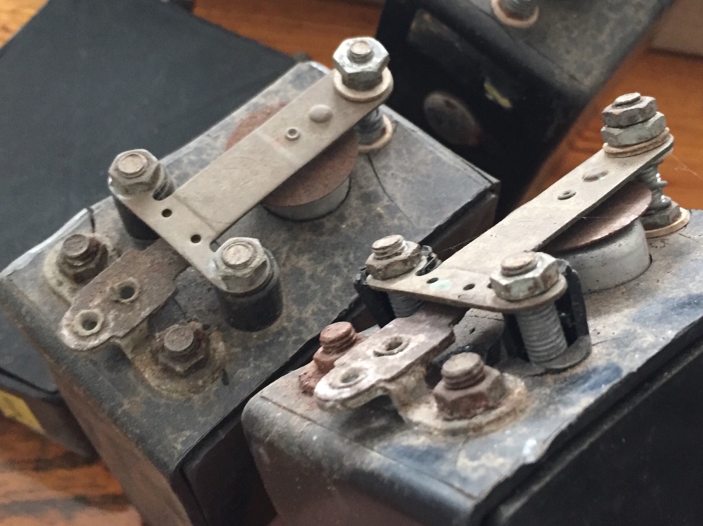

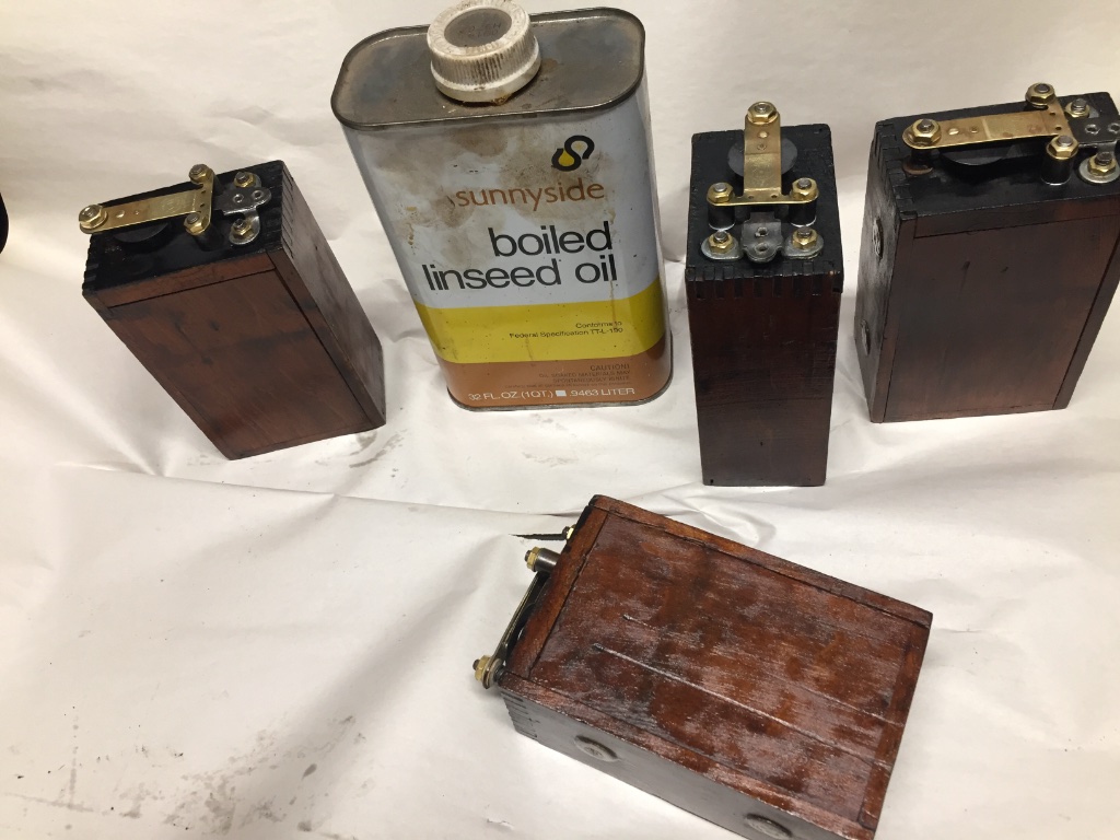

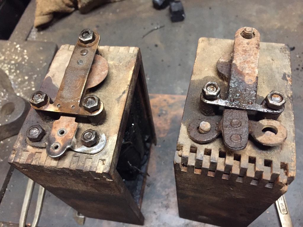

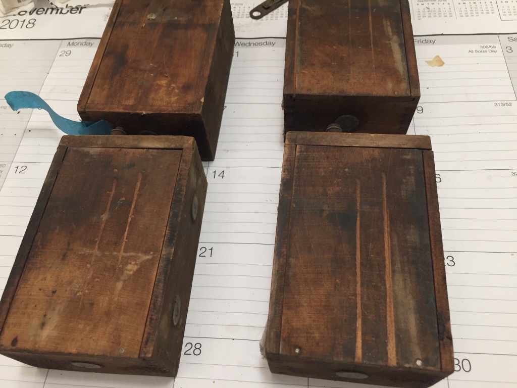

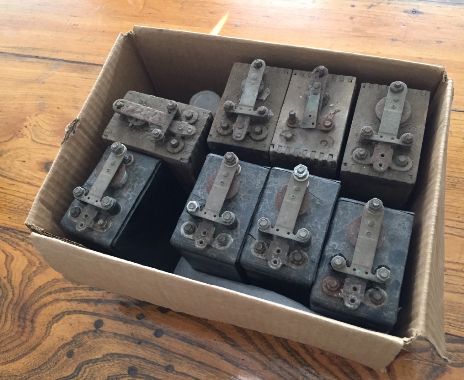

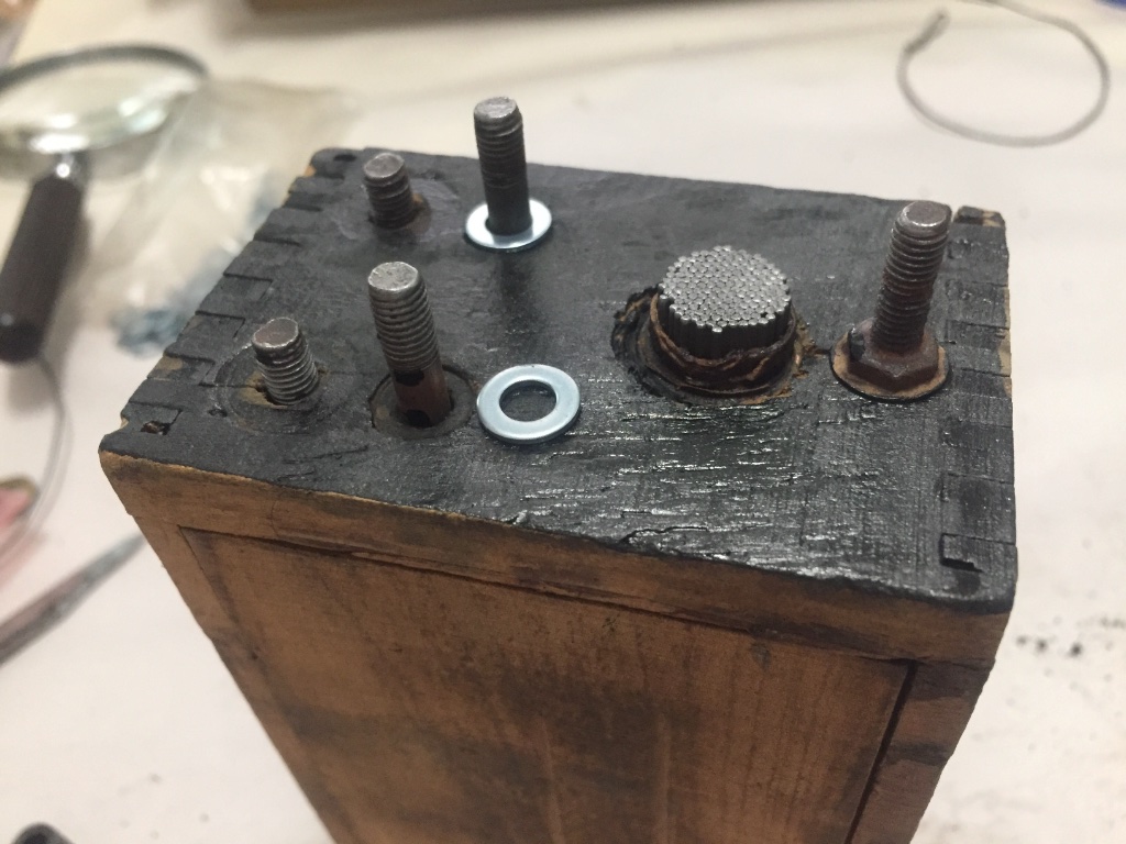

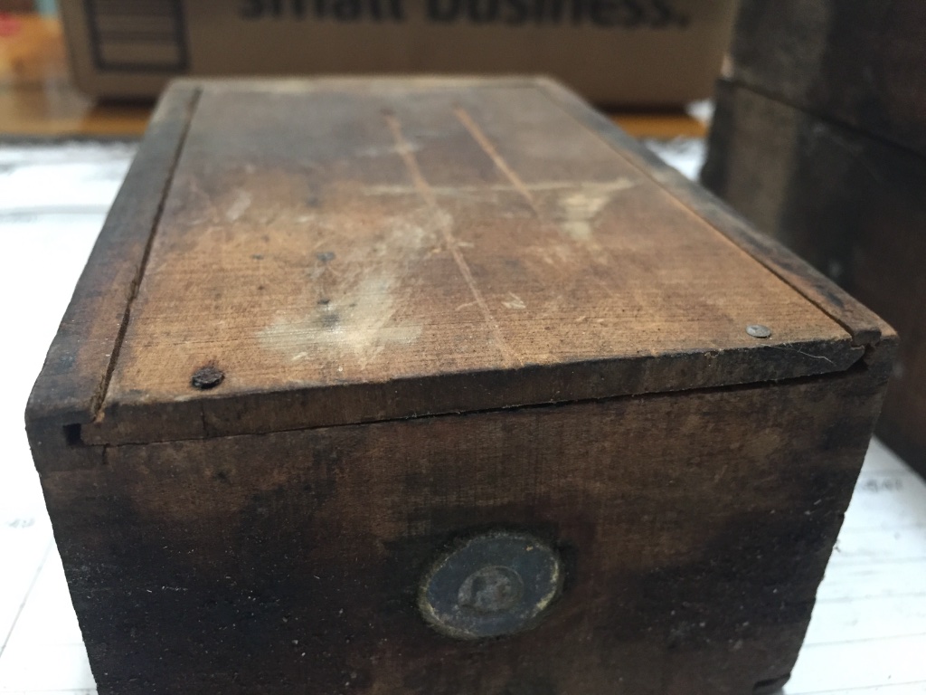

The wood coils have great wood boxes. For some reason every box has some scratches in the same place. Any ideas why?
Now the hardware on top leaves lots to desire!
Look at how much this nut rusted! This wrench is the correct for the nut.
It looks like these coils need more than an adjustment!
I plan to show the step by step process that I use to rebuild a coil.

I wouldn't spend much time on the plastic one, but if the secondary coils measure around 3200 ohms, the rest should be restorable with new points and capacitors.
Remove the tiny nails from the bottom of the large side, slide it out, then lever off the narrow side OPPOSITE the coil to access the capacitor and wiring. GigaBytes of advice on this forum!
The scratches come from inerstion and removal from the car coil box.

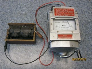

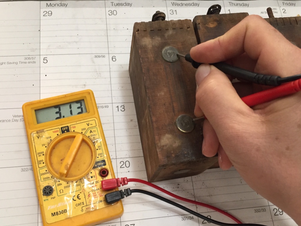

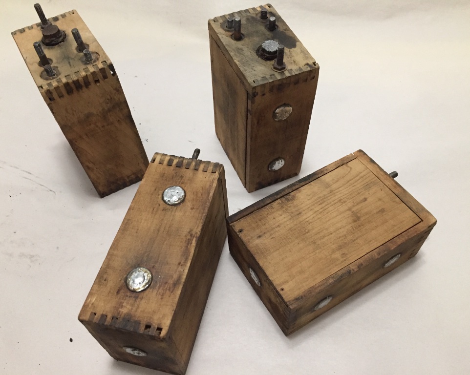

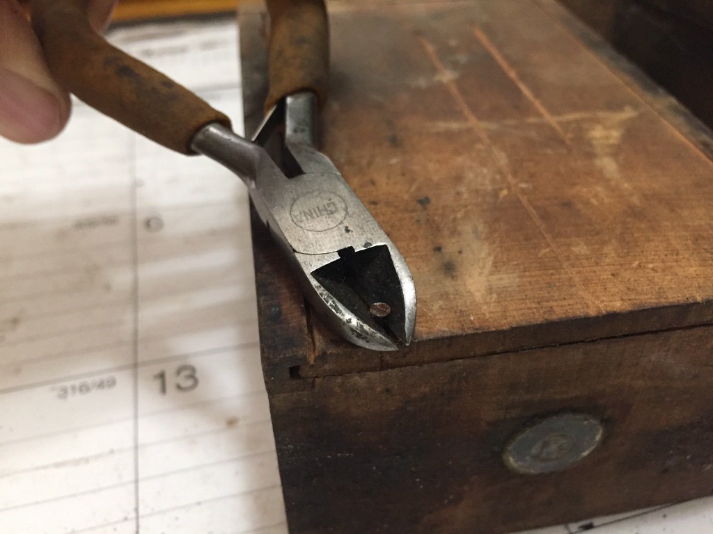

I checked to see if the secondary coils were good and they all passed.

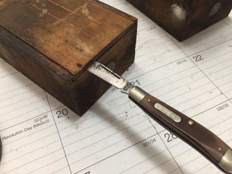

Then I pulled out the nails. I use a knife to get the nails to stick up a bit, then I can pull on them. If they’re really stuck I have gone to cutting them off by slipping eight then ask on the lead in between the cover in the box.

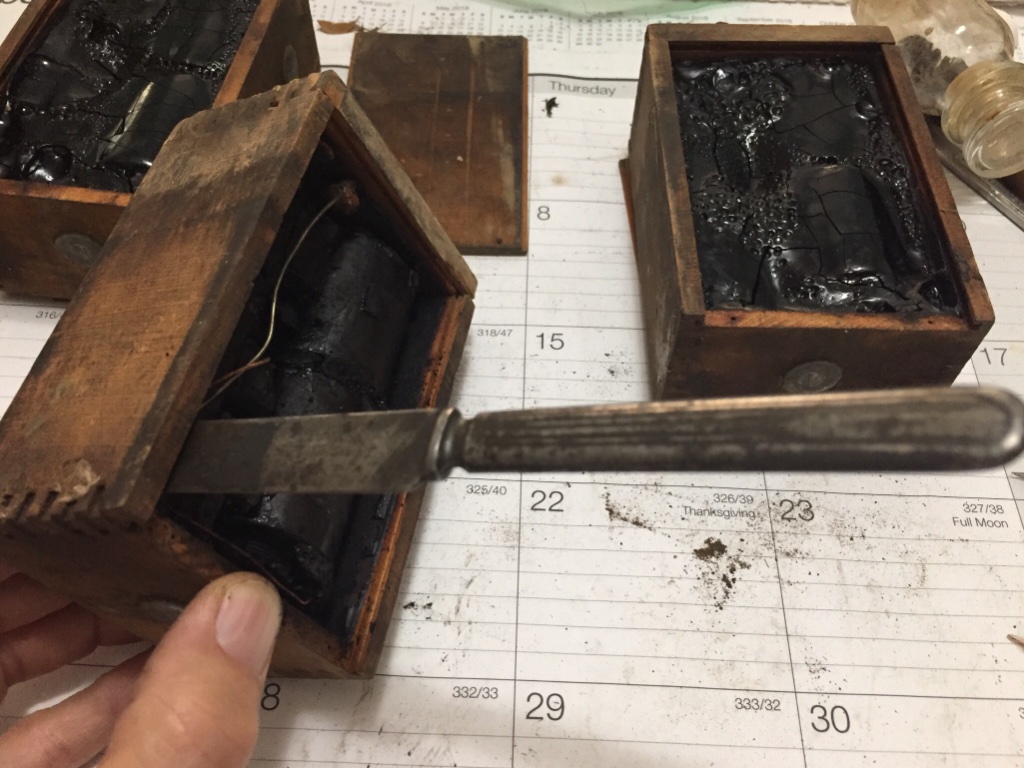

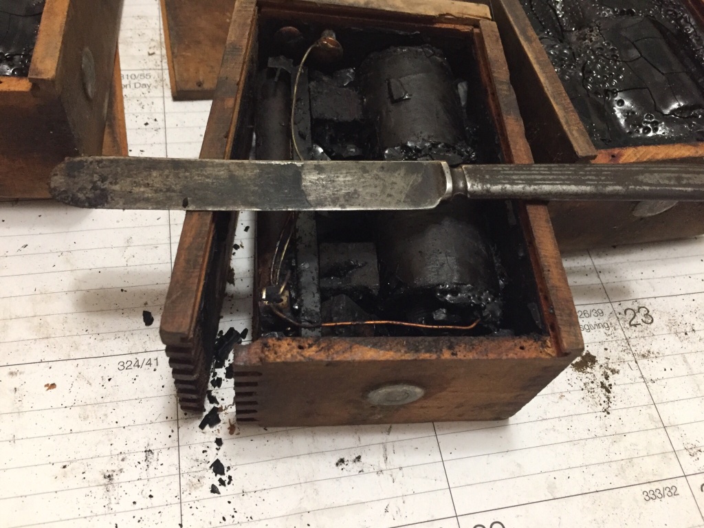

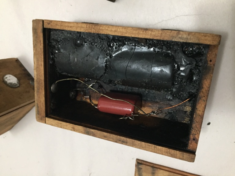

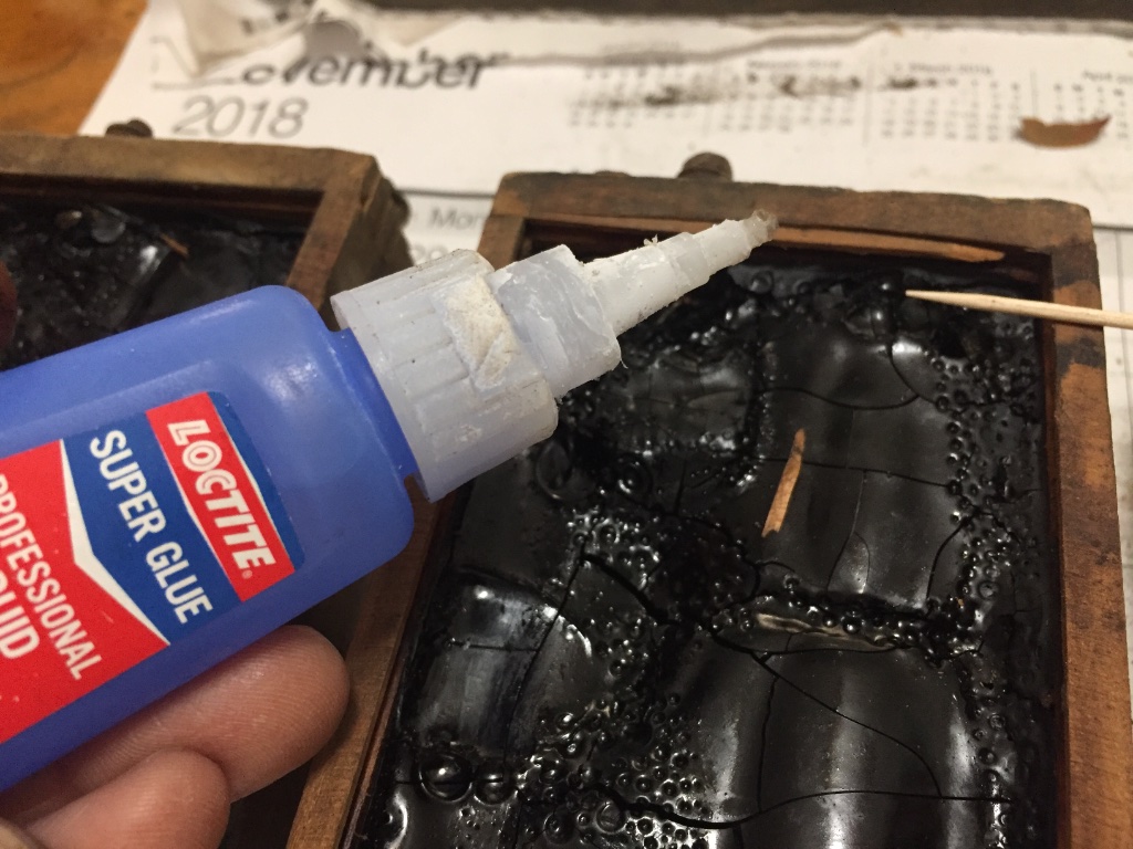

Opened the box and already needing to make a repair.
I find it easier to pull of the side panel to remove the capacitor. I use a knife like this.
That only worked on one. The others still had glue holding them. The others I left a box intact and carefully removed the capacitor and glass.

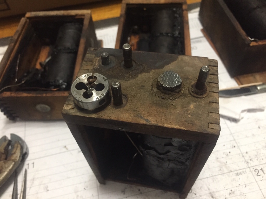

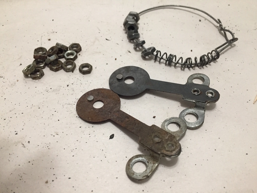

Now is the time to address the hardware. Fortunately someone had removed most of the nuts. The rusty one that shown above with the wrench I ground off and replaced it with a spare I had from a bad coil. The others I cleaned up with the wire wheel and put marvel mystery oil on.

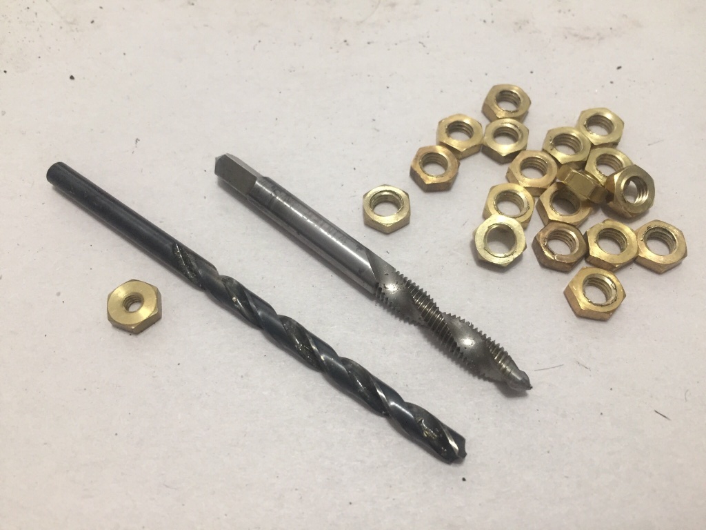

I like to clean the threads with a die. I had to special order at 12x32tpi Die so I made sure it was extra small so that I could get it to fit in here.
The hardware that fell out I would pull out and hold with a wrench to clean up the threads. But I did get one stuck in it was a pain to get the day off I mean she is a screwdriver from the inside. I will use super glue to hold all the loose studs.

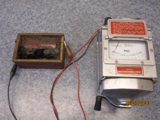

I installed the capacitors at this point. Prior to adding capacitor I used a megger to test insulation to assure no leakage between primary and secondary.

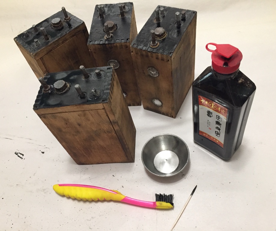

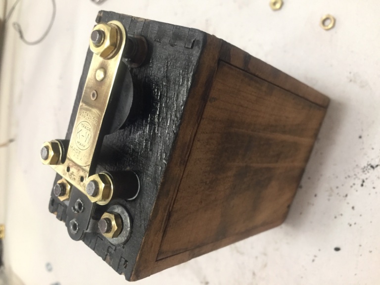

At this point I went ahead and used some ink to make the tops black. I used a old toothbrush and a toothpick to get all the areas in the top.
So I get the other hardware ready that should be dry.

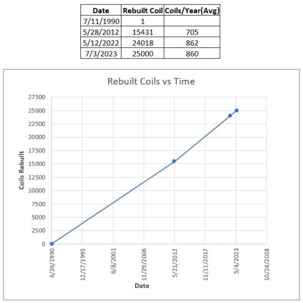

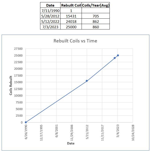

In memory of one of Bruce Mccalley favorite sayings: "for all of you who enjoy a good mess"
Not sure exactly when, but in May of this year I passed what I consider a major milestone.
In thirty-three yeatrs of rebuilding Model T ignition coils i completed the rebuild of my 25,000th coil.
Ron Paatterson

Now that deserves a WOW. Congratulations.

Matt, Nice work documenting your coil rebuild process.
Ron, Congratulations on your 25,000th coil rebuild.
A look back on your past reported milestones and its apparent your picking up speed with all that experience!

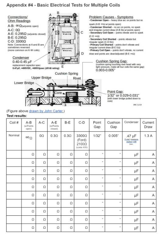

I forgot to mention that before I put the capacitor in I use a megger the measure to test that there was no issue on the secondary.

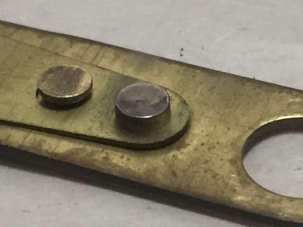

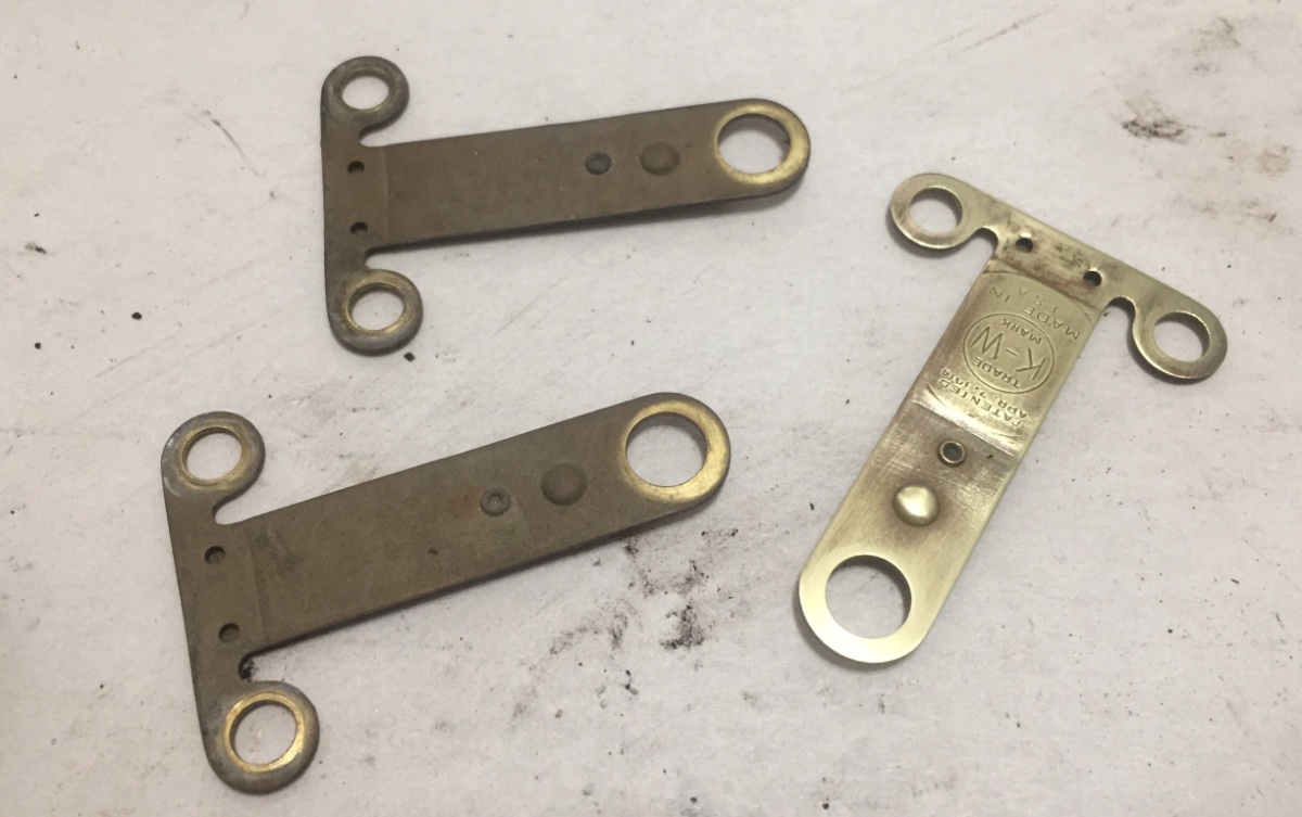

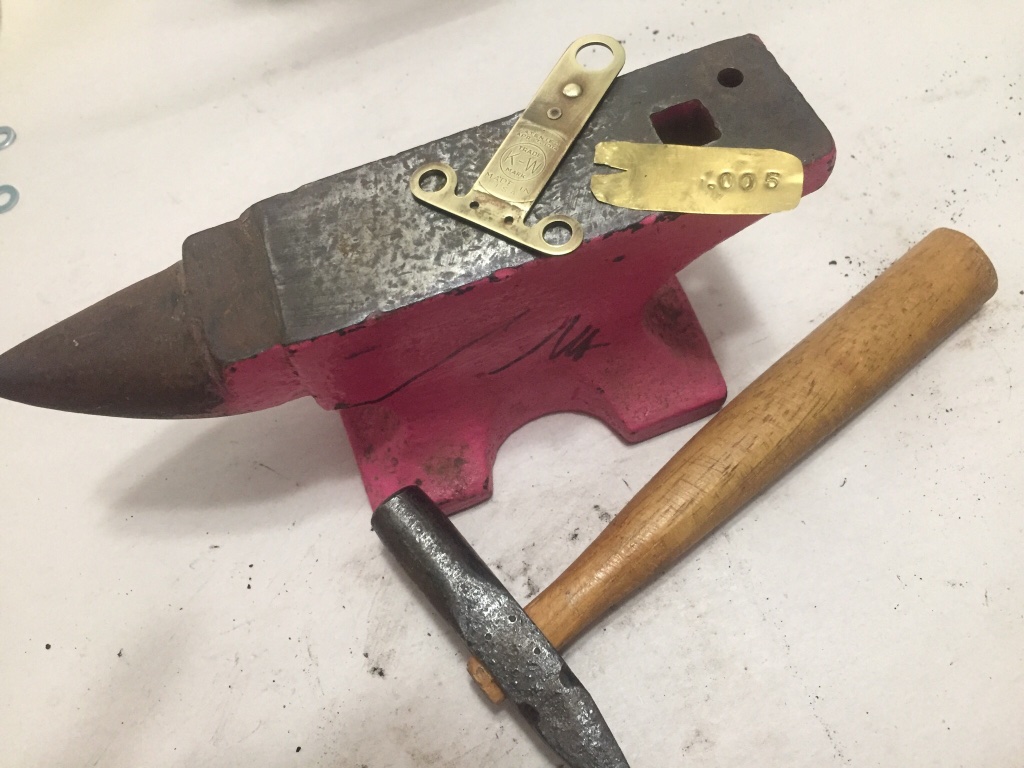

Now is the time to get the contacts on the tap all cleaned up and ready to use. I stole the contacts off of the plastic ones. Likely wire wheeling it looks like these were never used:
I used steel wool to clean the brass a bit.
I use this and four and a 0.005” shim to set the rivet.
Obviously you have to have a pink anvil. The story behind this is when my daughter was three or four years old I was trying to get her interested in blacksmithing :-). What is important is that it has a hole drilled in it and I use that to put the contacts in when I am gently hammering on the rivet. I know someone who made some pliers not the ones for sale but ones with parallel jaws and a hole with a hole using a die grinder . I’d like to make a pair eventually.

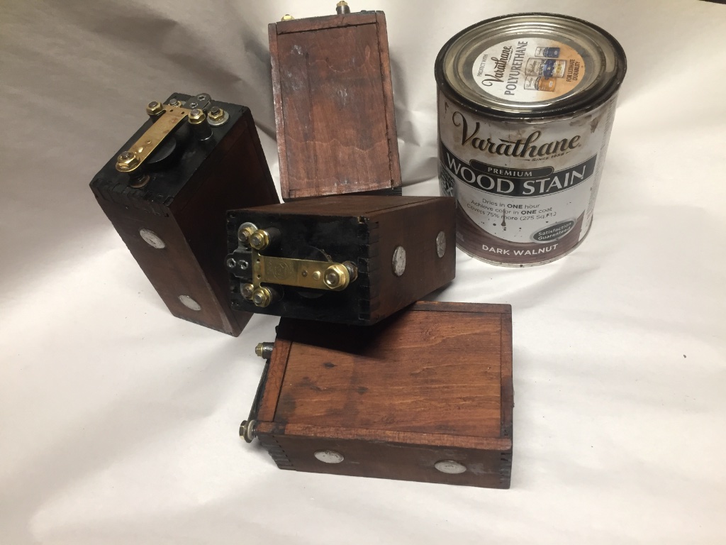

I use a wire wheel to clean up the bottom contacts. It look like I had a lot of rust but it looks like it was all surface rust.
I also cleaned up the nuts and hardware but decided to make my own brass nuts for the top. Trying to make sure that these can last another hundred years :-)
Added washers to shim the standoff for the upper bridge.
Old coil with updated hardware!

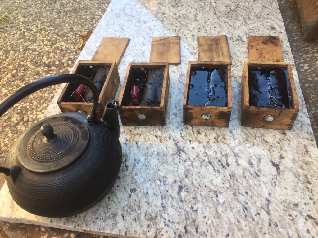

I tested coils and did a basic tune before adding tar. I didn’t want to find an issue after.
Time for the tar. I use a small Japanese cast iron tea kettle on an electric hotplate. The hot plate is not very powerful so I don’t have issues with tar boiling out, but it is slow.

Ron P, Twenty-five thousand model T coils! Criminy! That is enough for more than six thousand model Ts! And those you have taught have done how many more?
Thank you Ron P, thank you!

Post by Matt in California » Wed Jul 05, 2023 12:12 am
I like to use dark walnut wood stain on coils that have been stripped down. This in my opinion makes the coils look similar original ones that have not been stripped down and are in good shape.
Last edited by Matt in California on Wed Jul 05, 2023 12:48 pm, edited 1 time in total.

Your megger on the secondary winding test taught me something. You showed a very nice photo above.
A coil I had been "playing with" showed a 3.65 so in the ballpark I think.
Thank you on many details!

Hi Matt, Can you fill us in re megger test on the secondary and what voltage is applied by the megger? This is a very constructive thread and the members will learn a lot. Looking forward to tomorrows post.....n

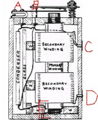

You can find info on using a megger on coils here: http://www.mtfca.com/discus/messages/25 ... 1329803721
Ron Patterson wrote: Their are two places high voltage shorts occur in Model T coils. To check for them you have to remove the coil points and the capacitor. Use a 1000volt Meggar and test between points C & E for a short between the primary and secondary winding and between iron core and point E for a short between the primary winding and iron core.
Ron the Coilman
And for more details on what a megger does:
Garnet wrote: A megger is a high voltage insulation tester. It will provide an indication of a short or path between conductors in situations where where a regular ohmmeter won't due to its low voltage.
Before you go to the bother of replacing the capacitor in an old coil, you want to be sure there are no internal opens or shorts in the windings. Checking for open circuits can be done with a regular ohmmeter, however testing for a short circuit must be done with a megger. This is done with the contacts removed which electrically separates the two windings. The megger will indicate the electrical relationship between the two windings. Any coil that fails this testing is relinquished to the garbage pile. If the trouble is an open circuit, it can be further checked to see if the problem is outside of the windings (and repairable) or inside the windings (basically unrepairable).
Internal shorts and even opens can be successfully repaired but there are no guarantees as to how long it will function. I regularly repair vintage radio headsets that are open circuited. Some are repaired permanently - others work for awhile and then revert back to their previous condition)
Garnet

Duane,
Depending on the manufacture you want to read 2-4 kohms. (Nominal values of 3300 ohms for Ford and 2100 ohms for some KW.) I made this chart (based on John Carters diagram) with the idea of number each coil and testing them. The chart can be filled in as the coils are rebuilt.
For a printable copy:
Model T FACT Adjustment - Appendix #4.pdf
(766.49 KiB) Downloaded 289 times

Ron Patterson
Re: How I Rebuild Coils- The hard way!
Post by Ron Patterson » Wed Jul 05, 2023 8:05 pm
To properly test a Ford coil for inter winding HV shorets with a Megger you have to remove the Capacitor from the circuit.
The capacitor appears to the 1000 VAC AC developed by the meggar as a chort.
See attached comparative Meggar reading for good and bad coils.
Primary Secondary Low Resistance at 1000V.JPG (37 KiB) Viewed 11904 times
Primary Secondary High Resistance at 1000V.JPG (36.8 KiB) Viewed 11904 times

Post by Matt in California » Fri Jul 07, 2023 1:46 am
I let the stain significantly dry. Time for boiled linseed oil.

Poppie, everything you need to know about Megger testing coils is in the two photos I postd above. Look closely Notice the points and capacitor have been removed. the Secondary winding is connected to the short top bolt(with wire) and the Primary winding is the wire that was connected to the internal bottom of the winding. As Matt pointed out you will likely only find this HT/LT winding fault in every 10o or so coils. Do not be surprised if you dont immediately find one.
Matt, my 1000 Volt Megger is a Chinese made unit. $56 on Ebay. Handle it carefully, it is a precision instrument. I got my Megger experience in the telephone outside cable plant industry. A experienced Megger operator can calculate and find the location of a shorted wire pair in a several mile long cable to within a few feet.
The only thing I never investigated in detaili is at what exact Megger ohm reading a coil will or will not arch over between the Primary and Secondary windings.Probably varies between coils.
Have fun and be careful, a Megger will give you a helluva jolt if you get your fingers touching thre wrong place at the right time!!!!!!!!!.
