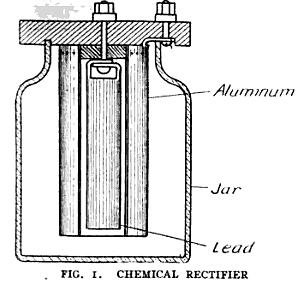

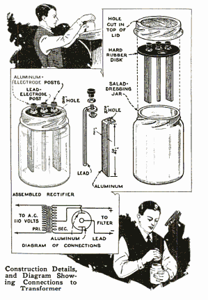

Adding an alternator to a model T is a bit redundant.
As the Model T already has a current producing generator/alternator. A magneto and an alternator both produce alternating current AC. The magneto produces current by having rotating magnets near a fixed position set of coils. An alternator produces alternating current by having a set of rotating coil adjacent to a set of fixed magnets.
As Henry and Tom were friends and they had the mechanical genius of Huff, with a little more time at the drafting table, the Model T could have had Edison storage batteries charged by Huff's magneto.
Period advertisement indicate companies were offering a form of rectifiers to convert AC current to DC current to charge batteries, and even provide suitable current to provide lighting. The description was a small wooden box that was connected to the magneto, with a lead from the box to the battery.
As early as 1899/1901,there was a patent for a liquid rectifier.
https://patents.google.com/patent/US672913A/en
Possibly, as with some other devices, Henry wanted to save money, and not add this feature to his car.
I constructed a similar device, and have to say, passing alternating current through the liquid rectifier does produce direct current.
Of course there are even less complicated magneto chargers using a tail light bulb and solid state device.
So, maybe there is nothing wrong with an upgrade and redundancy.
