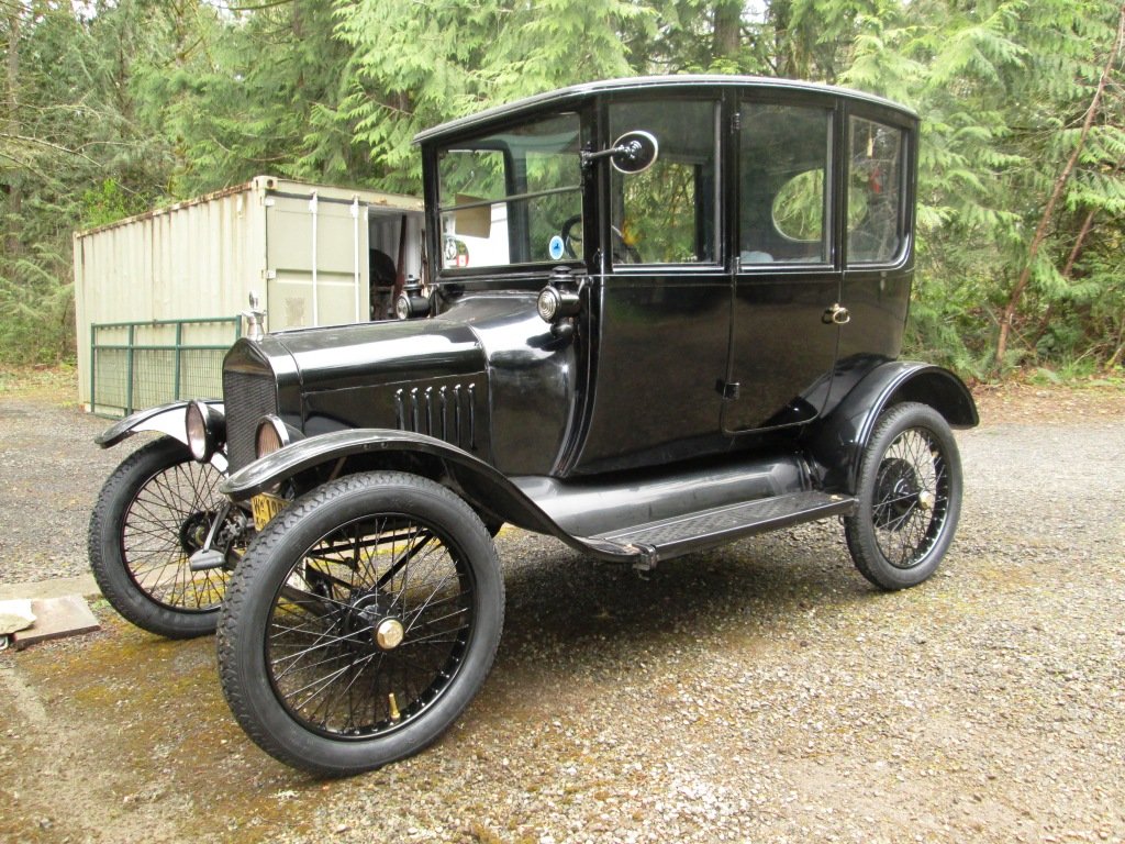

A bit hard to see but I have one on the Centerdoor - see the yellow plate ? I'll get a better photo of one.

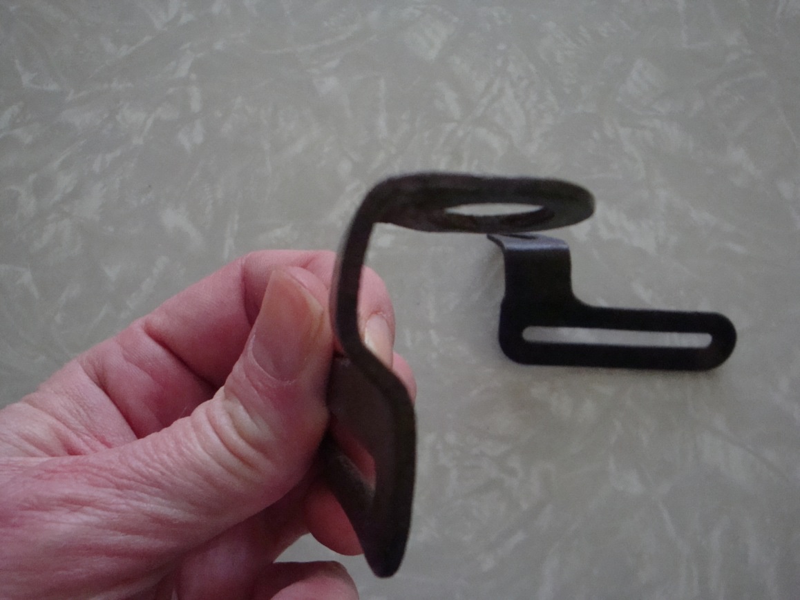

When I got my 1915 Runabout it had a poorly made aluminium reproduction Canadian style license plate mounted on the passenger side headlamp stancion. This positioned my 1915 Michigan plate too close to the choke pull rod loop and in the way of a clear swing of the hand held crank handle. I tried the repro on the drivers side and because of its odd alignment coiuld not get the plate perpendiculart to the ground or at right angles to the verticel side of the radiator and the plate was angled and looked goofy!
Bob C. helped me find with an original Canadian license plate (drivers side) mounitng bracket and I moved the plate to the drivers side
Looks ok now. Here is a photo.

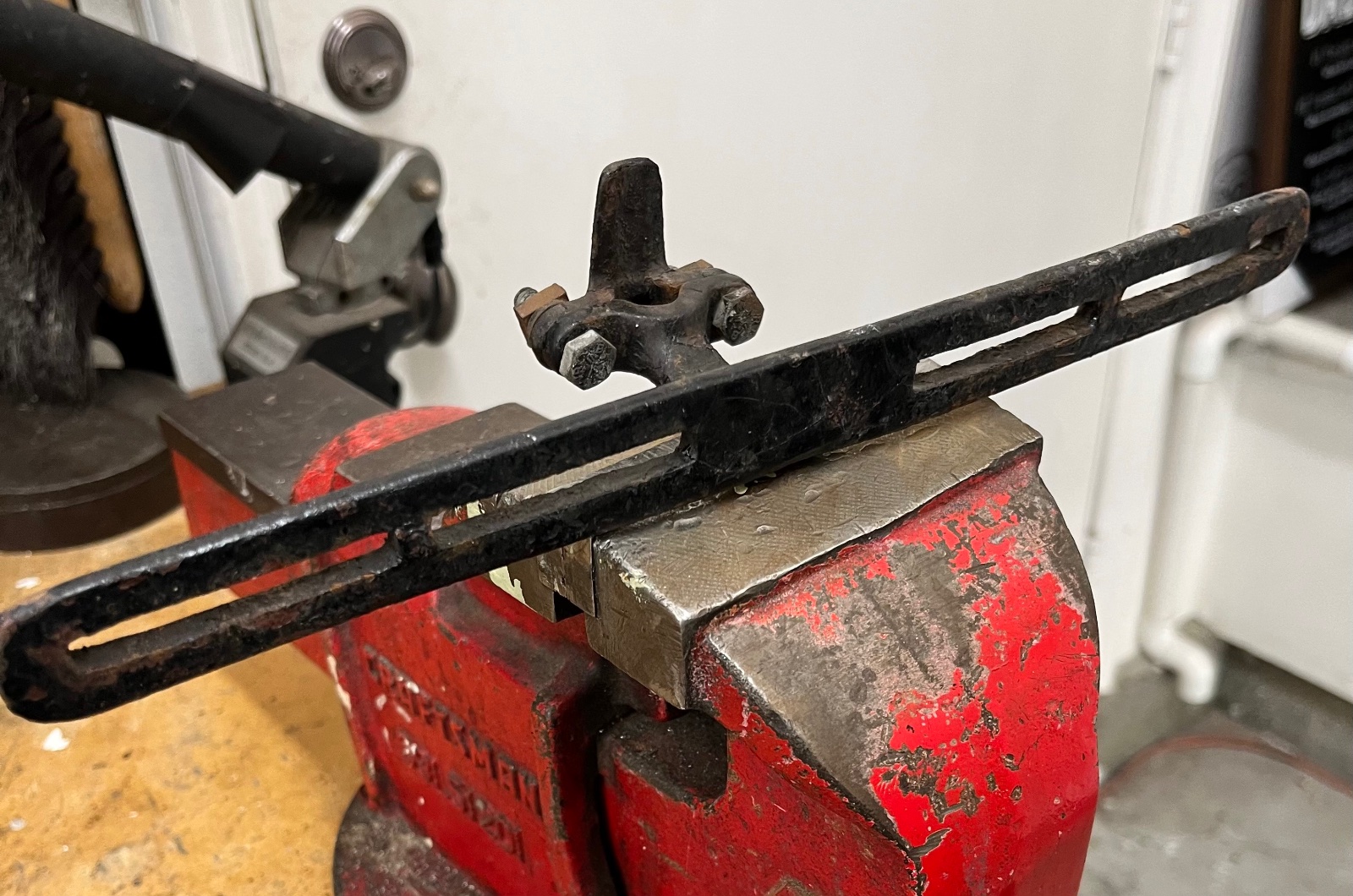

That is what I found also. Below is a picture of a style that have a bend in them and I believe would clear the crank. I found the picture on a forum. Could the new license holder be bent to the same shape?
