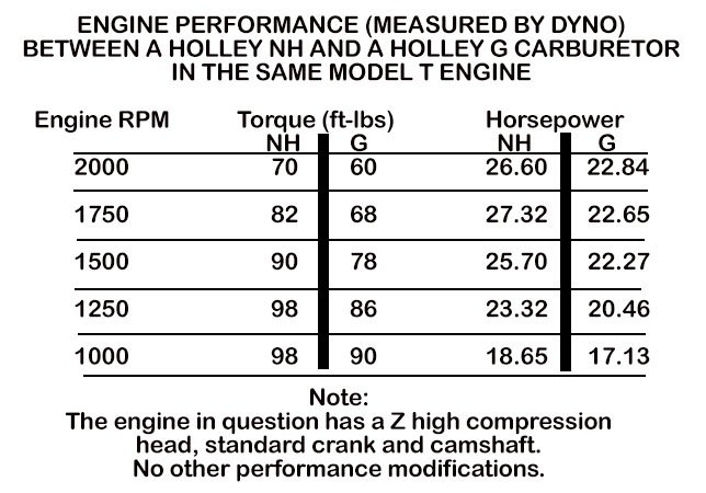

Skylar, some carbs (and I assume it's an NH or a Kingston L-4) will respond to a dunk and a swish. Not all do. For the very small cost relative to the agrivation, spend some bucks with Forum member Corey, and get a nicely restored NH for a very reasonable price. That will take the carb out of the equation and let you either drive your car or look for the Root Cause of your problem. So long as you are dealing with what is frankly and unknown condition carb, you are going to simply keep pulling your hair out.
A properly rebuilt NH is the "T" hobby's biggest bargain on the market these days
While it is no guarantee that it is your carb and not a faulty intake gasket or other trouble, there is very little reason to suspect that you'll regret having a "like new" warranted carb hanging off of your car...once fixed right, it is good for years and years of trouble free driving.

There is a LOT more to a good carburetor restoration than most folks realize.
& a lot of experience to restore a great carb.
The above answer assumed an NH, but still applies.
The G has a tiny copper tube that sits in the jet puddle. It must be @ the right height & not leak.
The float was originally cork. Thats a problem issue to seal or build a substitute with the same buoyancy.
Consider running an NH. Its a simpler carb.
