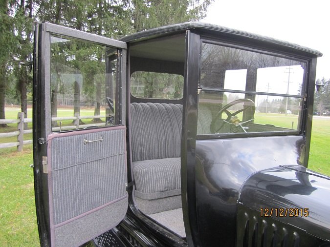

I used a kit to redo my '22 Coupe
That looks really nice. i like it.

I used the grey color kit that I got from Macs a few ago in my 24 Coupe. It’s the same color as Perry Keets car. It’s made of a nylon/polyester type of material and not a wool material that was the original black/lightly white striped as the original was.
The grey material is easier to clean I would think to clean and probably wears better. If your. not wanting a show car it might be OK to use it. A purist would use wool as originally was used.
If you’re replacing the interior it’s best to install the headliner and any bad top wood first. The interior goes in after.
It’s probably possible to do the interior with the top still on it but it’s harder to do and not the way Ford did it.
