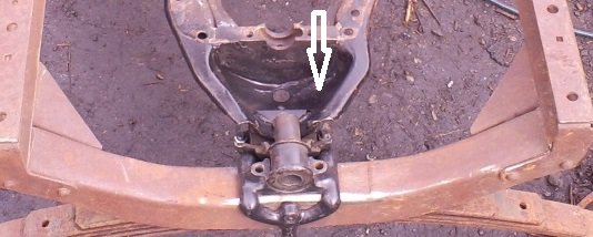

Also check for something caught & bouncing in the pan support (nut, rock/pebble) too

Removing the steel crank handle bushing in the front of the pan is easier done with a die grinder and burr. I grind a slot in the front section that is in the pan and the drive an old screwdriver down the side to collapse it a bit and break the rust between it and the pan. I always replace the steel bush with an off-the-shelf bronze bush, BUT as often as not, the OD of the new bush needs to be turned down a bit to fit. Steve Jelf uses a piece of all thread to act as a tool to insert the bush, so it is not damaged by hammer blows.
