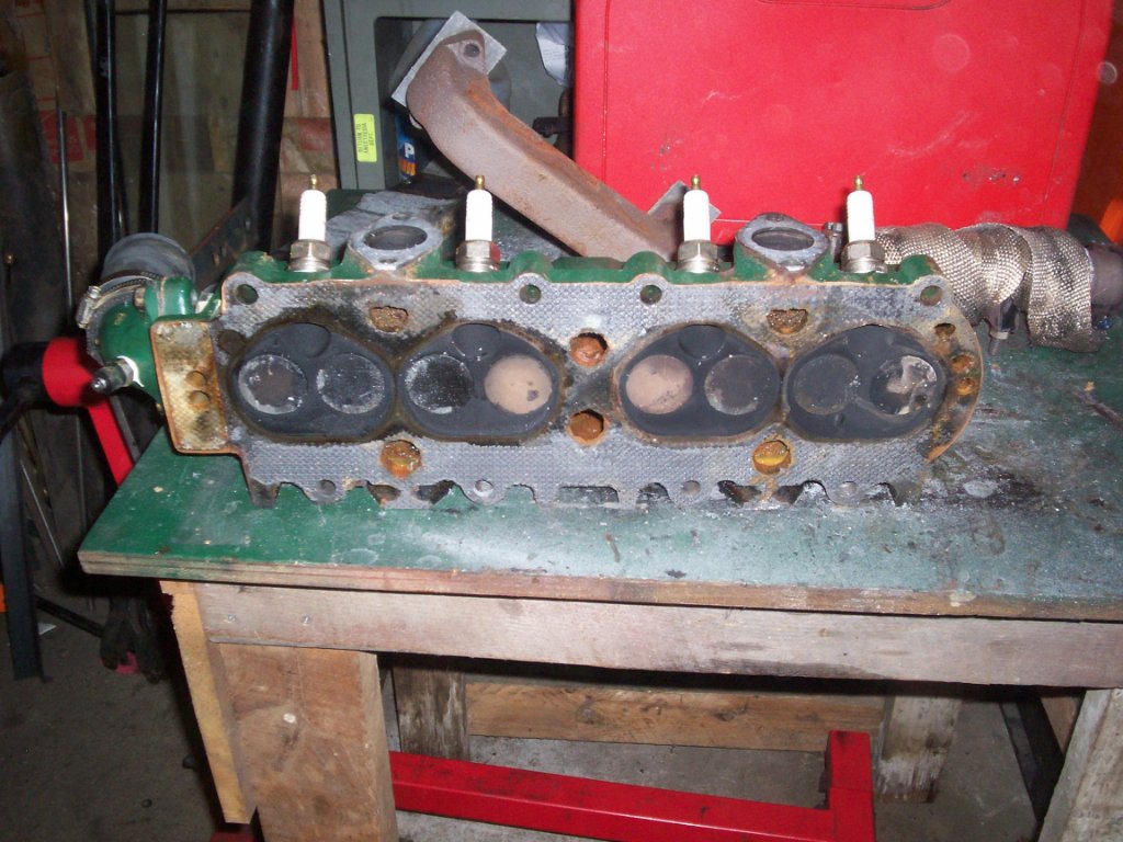

I'd cut one myself on the cnc but I am unsure of how to form the fire ring. Answering the question above = "not stock T or chevy".
Here's an archived page from my (now stolen) website from 2007 that shows the plate. I had gasket photos - haven't found them yet. If I remember right the bottom one has round holes and isolated the push rods. The top one is longer than a stock chevy due to the water outlet adapter.

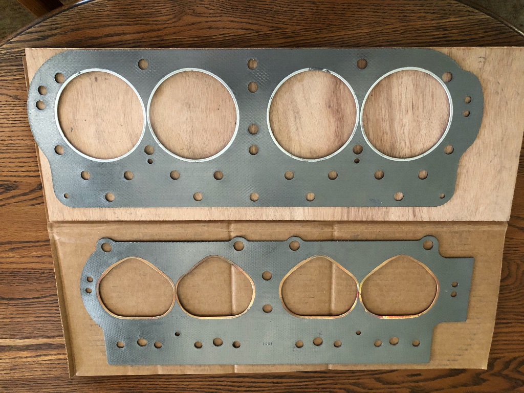

You can see what one gasket looks like in this one.

My very last set! Only sold as a set.., $300.00 with shipping.
