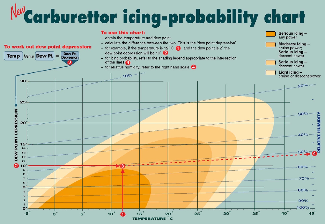

Th intent of the carb heater pipe is to prevent the intake manifold from icing up. When the air fuel mixture expands inside the intake manifold expands it causes a temperature drop. In Today's World most reference's about it relate to aircraft but that really doesn't make any difference other than the changes in ambient temperature they experience in altitude changes .
Better explanation from others
-Cold air is more dense and therefore contains more Oxygen by volume so the mixture ratio can remain the same. Because the engine is cold at startup, and by extension, so is the air. Therefore there is more oxygen. So without enriching the mixture, the resultant mixture will to too lean to support combustion.
-Carburetor icing exists when the moisture inside an engine's carburetor drops below freezing and water vapor freezes onto the throttle valve and other internal surfaces of the carburetor. The build up of icing inside the carburetor causes a reduction of the fuel/air flow through the carburetor and into the engine.
NOTE the chart title says PROBABILITY which is in line with speedytinc & others indicate.
