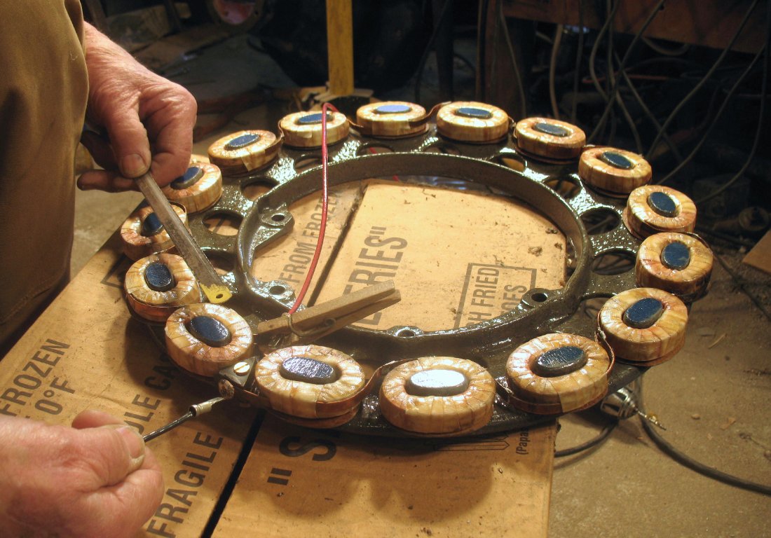

A few of my Ts I put together with functioning magnetos, I have tested mag coil rings out of the engine by connecting a twelve volt battery to them. There must be a better way, likely some sort of spring scale to get a viable reading that could be compared from one coil to the next, but I never went that far. I simply used a putty knife on each coil center and felt the pull with my hands.
On one such occasion, I began next to the contact "button", and continued around from one to the next through about eight or nine coils, when suddenly the next one had very little pull. Close examination found that the "ribbon" wire between the one that worked and the one that didn't had an odd kink in it that I hadn't noticed when working on it before. The paper insulation that was supposed to be there had a small tear in it, and the twisted kink was just barely touching the cast iron ring.
The coil ring is one long series of alternating coils, grounded at one end, and open for the electrical connection at the other end. The effect of the twisted kink was to ground the series of coils only partially around the ring. The "running effect" would be a greatly reduced voltage and current (amps) of power to run the engine. An improperly bent ribbon wire or metal contamination buildup in the oil coupled with vibration and/or temperature changes could result in an intermittent short.
It would be difficult and tricky to do? But with the Hogshead off, at least the top half of the coils could possibly be checked to try to locate an intermittent short. It would be difficult and tricky because the magnets themselves would interfere with an easy test. I have never tried to test one that way, and am not sure how I would approach it if I needed to.
Certainly, any attempt to do such a test could discharge the magnets somewhat or even almost entirely. That actually might be the best way to approach such a test? Regardless, if such an attempt was made, I would highly recommend an "in car recharge" of the magnets before putting the hogshead back on.
Another point to take into consideration, is that any testing of "intermittent" problems usually cannot be relied upon unless one can be sure it is in "failure mode" at the time of testing. Often, that isn't even possible to know when things must be disassembled in order to test them.

With the coil on the bench.
I test fields coils for magnetic strength as described with a piece of iron. If magnatec pull stops before the last coil it indicated a short to ground.
Next step is to test the continuity with my armature tester. 120V leads. This usually shows the weak short to ground with a bit of sparking & smoke.
A small bit of metal will burn away & clear away. The offending insulation is easily found for repair.
All that being said, in practice I replace with a new unit.
Its good insurance to a magneto failure & pulling the engine apart AGAIN.
