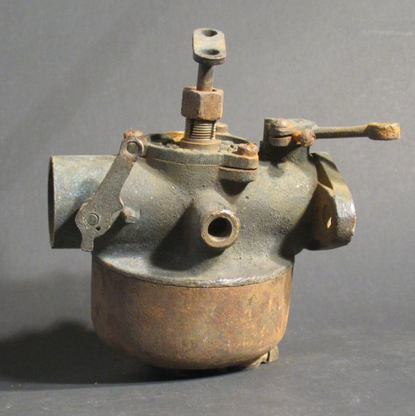

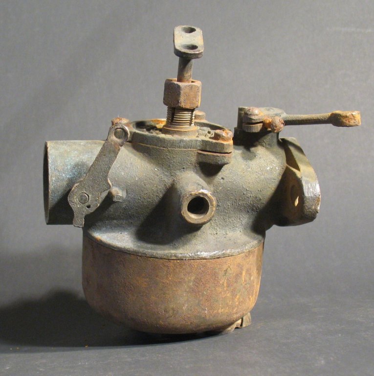

The later switch to a cast iron body and the new choke lever of 1919 were not the only changes I consider significant. Some of the bronze bodied G's have a rim around the choke intake, handy for attaching an air filter, and others do not. I don't know whether they were made concurrently, or one came after the other. I chose the rimmed one so I could add a filter. If that's incorrect, TS.
The G has some parts that came in different forms during its six years, but are interchangeable. This means, especially after 100+ years, that your G body doesn't necessarily have its original top plate or bowl.
Choke intake with rim.
Without rim.
