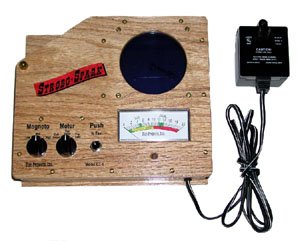

One needs to use a device such as this in order to properly diagnose and adjust a coil box. Seek one out and you'll be back on the road quickly. Adjusting by eye/seat of pants intuition rarely successful.

Your engine is tired. When you mentioned your compression (above) a lot of red flags show up. 48 PSI on #1 and pooling oil (!!!), 30-35 on 2 and 4 that can be brought up to compression, and #3 that has shot rings (no difference wet or dry). Tthat #1 is so far out of bounds That its saturated with oil as well makes me think it's barely (if at all) firing.BuzzBumbleBee wrote: ↑Mon Jul 10, 2023 10:15 amThanks for the suggestions I'll get more resources to test the coil boxes (or send them away to get looked at)
We checked the exhaust manifold this morning and can't see any blockages
Also did compression tests :
1 : 48psi (loads of oil pooling on top of the piston)
2 : 35psi (45psi with oil added via spark plug)
3 : 30psi (no change with adding oil)
4 : 30psi (40psi with oil added via spark plug)
What is your oil level? You want it NO HIGHER than the top petcock, and ideally halfway between the top and bottom petcocks. You want 1 US gallon (4 quarts, or 3 3/4 liters) total.
Anyway, this on top of the induced coil problems... you should invest in an ECCT (or even a hand cranked coil tester) and reset your coils... the only thing "mechanically gapping" your coils will do is frustrate you, as it's not only the gap but the spring tension of your points.
Sorry I'm not closer, else I'd pop ofer and see whats all going on.

- Posts: 7411
Re: 1915 T - Low Power - Suggestions Needed
In this situation I would not spend the £400 or more for an ECCT or the likely £500 to £600 or more for a good HCCT. I would have an experienced professional test, possibly rebuild, and adjust the coils. If it turns out that you later take on rebuilding coils regularly, that's the time to invest in the test equipment. For coil service that's not likely to be needed again for years, the aforementioned experienced pro is the way to go. Don't worry. There will be other opportunities to spend hundreds of pounds.
I agree with Scott about pulling the head or otherwise tearing into the engine. That should wait, if it's really necessary, until all the easier measures have been tried.

Contrary to all the expert advice the "Buzz Box" Tester kept the Model T operating long before the ECCT or the finding a shop with the HCCT.
