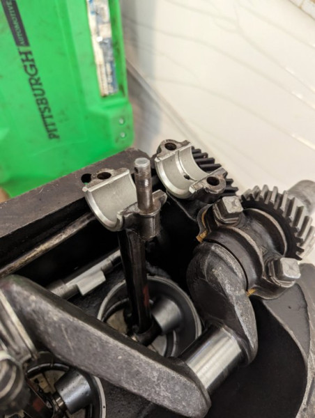

I Finally found the time, money, and tools to start getting my 24 T put back together after several months of it being torn up in my garage for a "restoration". When I left off, I had taken out one of my pistons to inspect clearances but forgot to get plastigauge first, and had to wait to go get some. In the meantime I needed to move around a bunch of stuff in the garage and lost the brass shims and the castle nuts for connecting rod no. 1. Should I put new shims and castle nuts on just that connecting rod, or should I pop off the other 3 rods and install new shims in all of them? They haven't been off since the motor was rebuilt in the 80s but seem to still be in great shape, as with everything else in the motor. The previous owner didn't drive this car much, but I have done a fair amount of touring the few years I've had it.

Don’t fix what ain’t broke, just do the one rod. You may have to peel off a few shims if you get a new stack for that one rod to fit the crank.

I suggest you pull the shim pack from another rod and measure the thickness- that will give you a starting point for shim thickness when you replace the lost shims in the 1st rod.
