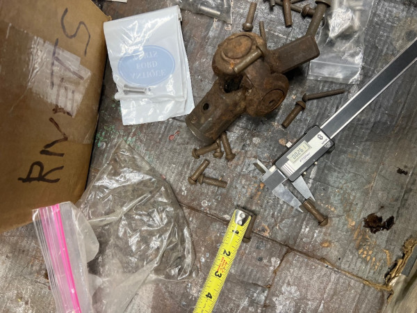

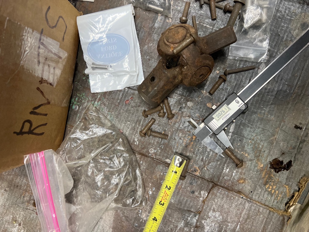

I offered to re-rivet an otherwise very nice u-joint for a friend. Well... Got the 4 old rivets out. They're .266 diameter, 17/64". Does anyone know where to buy 17/64" dia. rivets? They probably need to be about 7/8" long.
