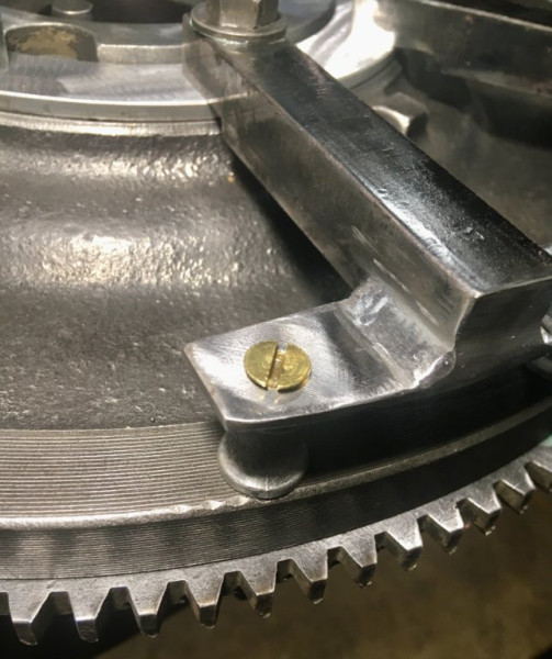

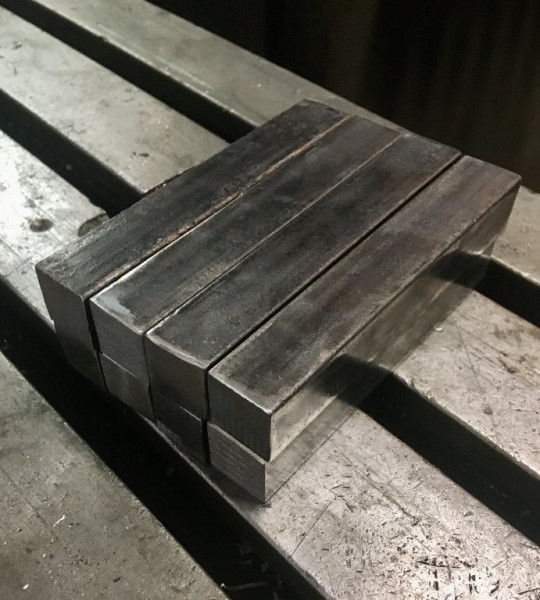

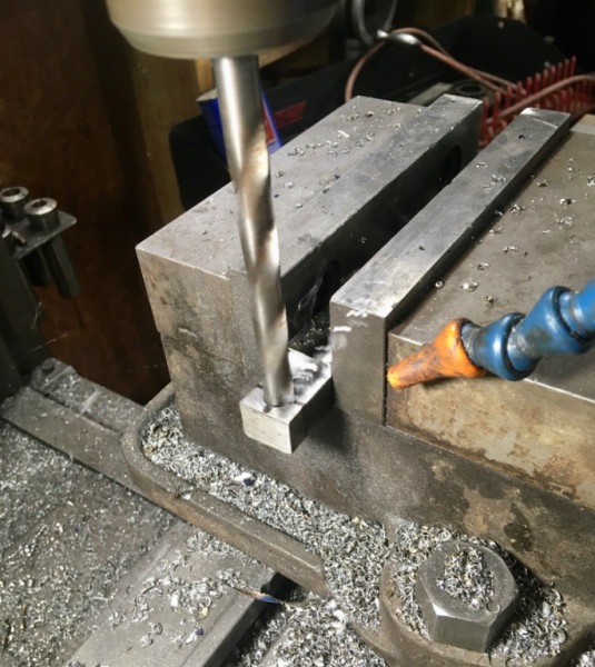

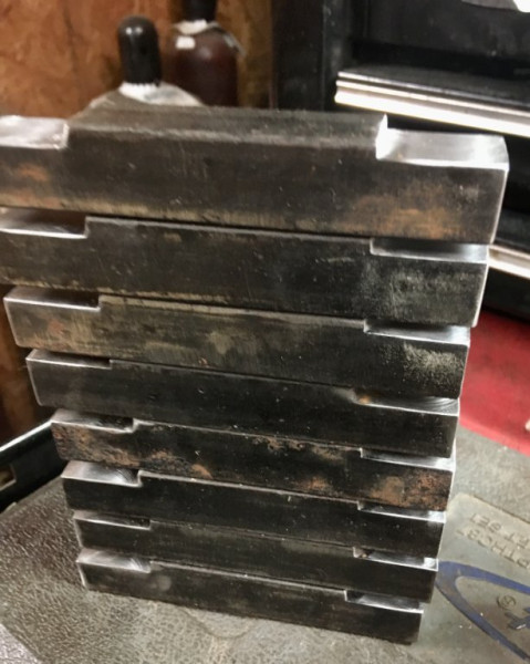

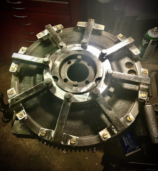

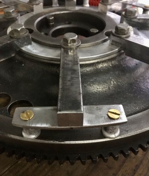

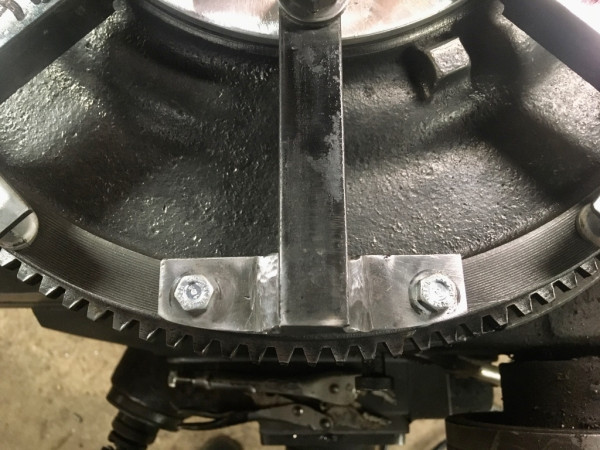

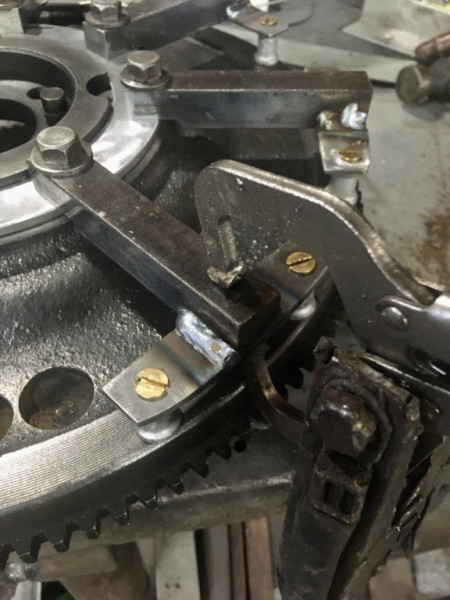

Tried my hand at building Oil slingers
Started by cutting some equal length 3/4 blocks Next milled off the edges. one side for the triple gear pin ring. the other for the mounting tab on the ring gear side. Test fit on the mounting tab. Used original spools and a new set of original brass screws Next Welded it Then I gave it a smooth finish“Whether you think you can, or think you can’t-you’re right.”

Very nice, good idea to keep some flywheel weight for low end acceleration.
Only my 2 cents.. old brass screws may be weak point, they do snap off heads. Tap the ring gear and use steel machine screws and LocTite.
- Posts: 4231
Re: Oil Slinger Build
Make that 4 cents now. Even new brass screws, in that application, give me pause. Might also peen the ends to lock them in.

This is why I posted the build! Some good advice. I might ditch the brass. I did use lock tight and peened them. I forgot to mention. Thanks fellas

I read a good deal about the flywheel mass subject. With consideration to the car being the heavier Tudor I went for the middle weight as I would like the lower end grunt vs higher speeds. I’ve also read that distributors like the lighter flywheel but have seen distributors on cars with magnets that run good to. I plan on the outside hogshead oil line in the near future. In the end this is an experiment. I guess time will tell

Four cylinder engines need substantial flywheel mass to develop torque. A Model T with a stock, lightweight crankshaft definitely needs substantial flywheel mass, and the balance of it needs to be out toward the rim. Mass near the center of rotation is not as effective at collecting torque and regulating power impulses. Engines with more cylinders and higher operating speeds require less mass in the flywheel, and a counterbalanced T crankshaft can offset lack of mass in the flywheel. A stock or near-stock T engine develops its maximum torque at rather low engine speeds, which calls for a substantial flywheel.

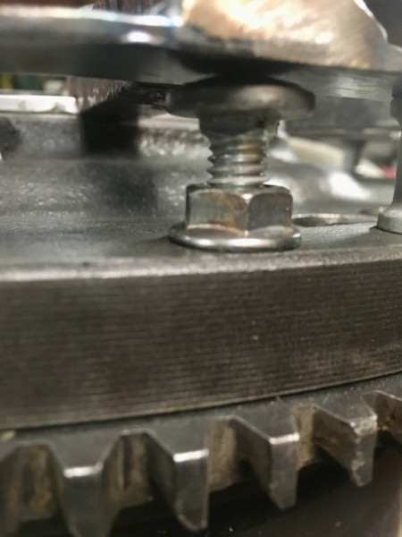

The ones to use are 6mm x 1mm high tensile screws. They must be high tensile or the threads just strip and won't lock, as I discovered. Mine have been in operation since early 2011 without any problem.speedytinc wrote: ↑Tue Jul 11, 2023 2:39 pmThere is a metric screw size that works quite well in this application. The threads self lock.

Thank you John I purchased 6mmx1mmx50mm high tensile bolts from our supplier on the farm. Threaded in perfectly with enough sticking out to peen over.
Bryant

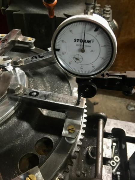

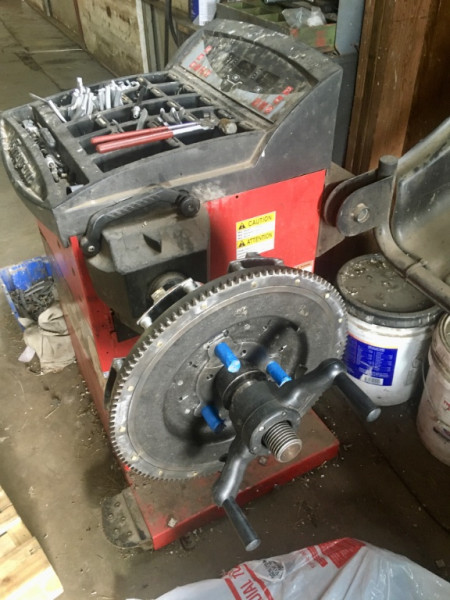

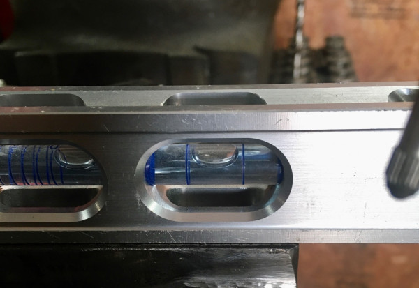

because I can’t leave well enough alone I decided to indicate the slingers like one would do when setting magnets I started with a level slinger next worked my way around on the turn table on the Bridgeport adjusting to .zero with this little carriage bolt and nut a lot like adjusting valve tappets it brought everything to zero. then I spun it on the tire balancer because it was to big for the lathe and it appeared to turn wobble free next will be balancing the whole assembly when I finish building the mandrels. Thanks for watching.Bryant
